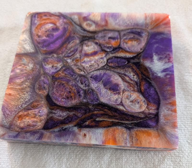

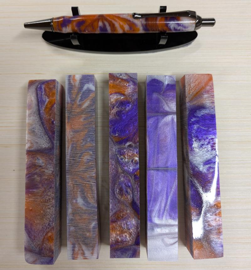

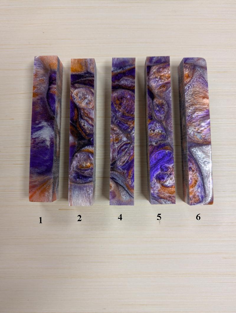

Won't clog up the forum for each new cast, but this one turned out better than the last. I was under the impression that "stirring" caused Aluminate Slow to heat up faster, which for me, letting it site made it heat up and stirring some just kept it mixed. Right or wrong? Any ways, this 2nd one I let sit longer prior to pouring the colors in.
I numbered the blanks after cutting, and used #3 (not shown) for pen. I named this set Purple Haze. The pen will be a give away to the manager of Great Clips in town as she likes purple. I did make a block with all purple, still need to make the pen though.
