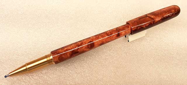

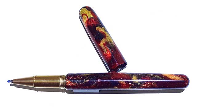

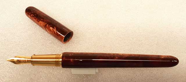

About 7 years ago, life took a turn. I repurposed the lathe into a specialty table saw, followed by 4 more lathes turned into specialty table saws all with the help of Rick Herrell. About Christmas time this year, I thought that it was about time to restore at least one of those lathes to its original purpose of pen turning AND go digging through storage boxes still unsorted after a house move. It literally was Christmas time.
Here are a couple of the first in over 7 years of downtime. It is like riding a bike, you never forget BUT the older you get, the longer it takes to get back into the swing of things.

OOOPS. That'll teach me to get distracted while in the middle of a post.
Both pens used Bullseye Turning Supply kits.
Red Dragon Diamondcast by McKenzie Penworks
PR resin unlabeled from at least 8 years ago
