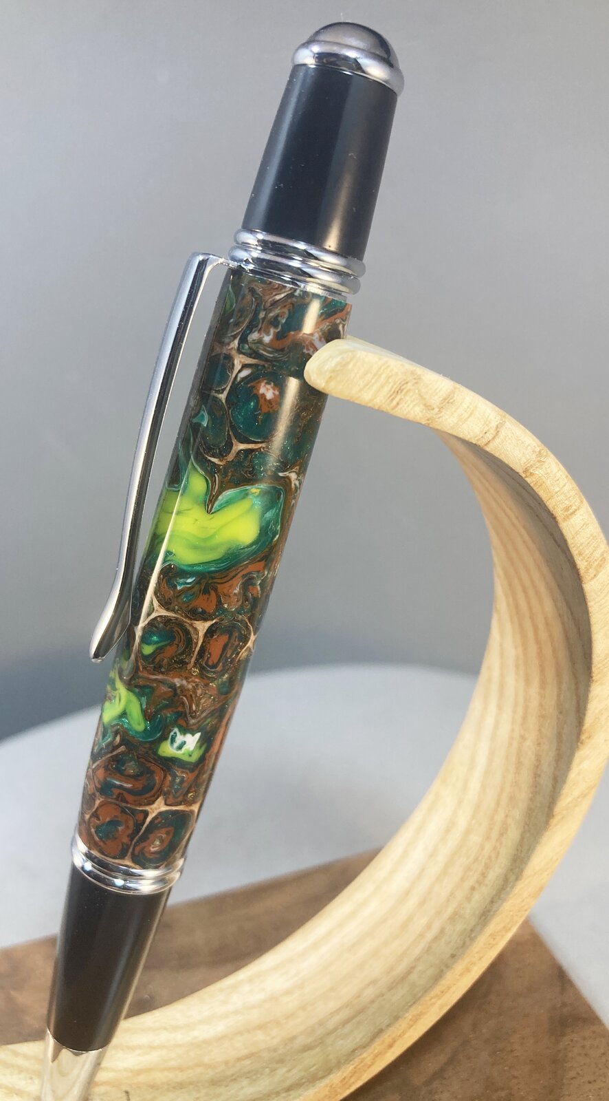

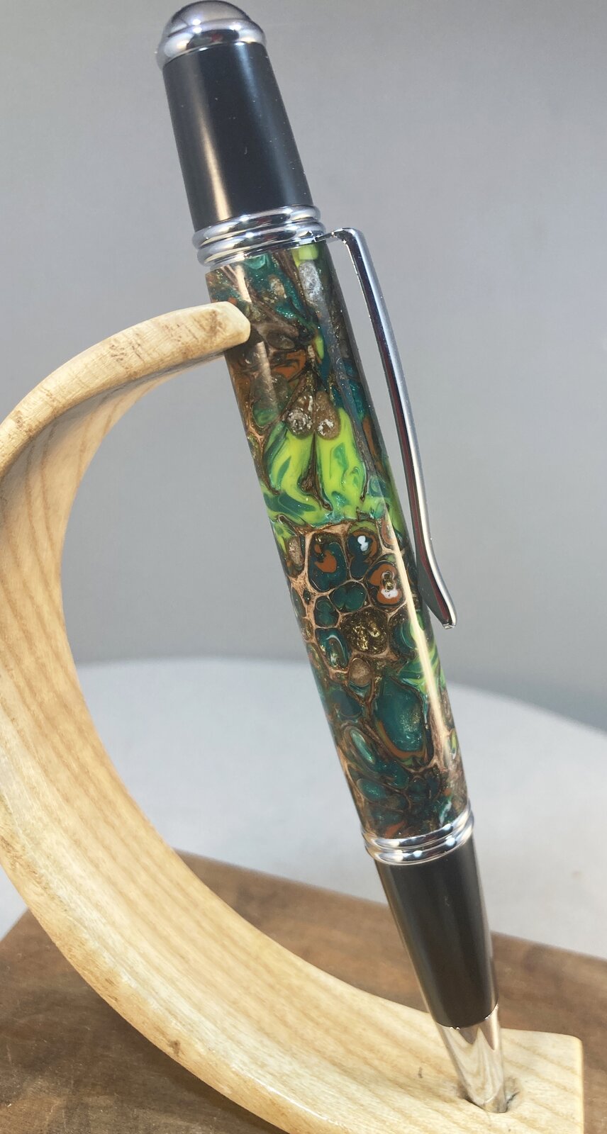

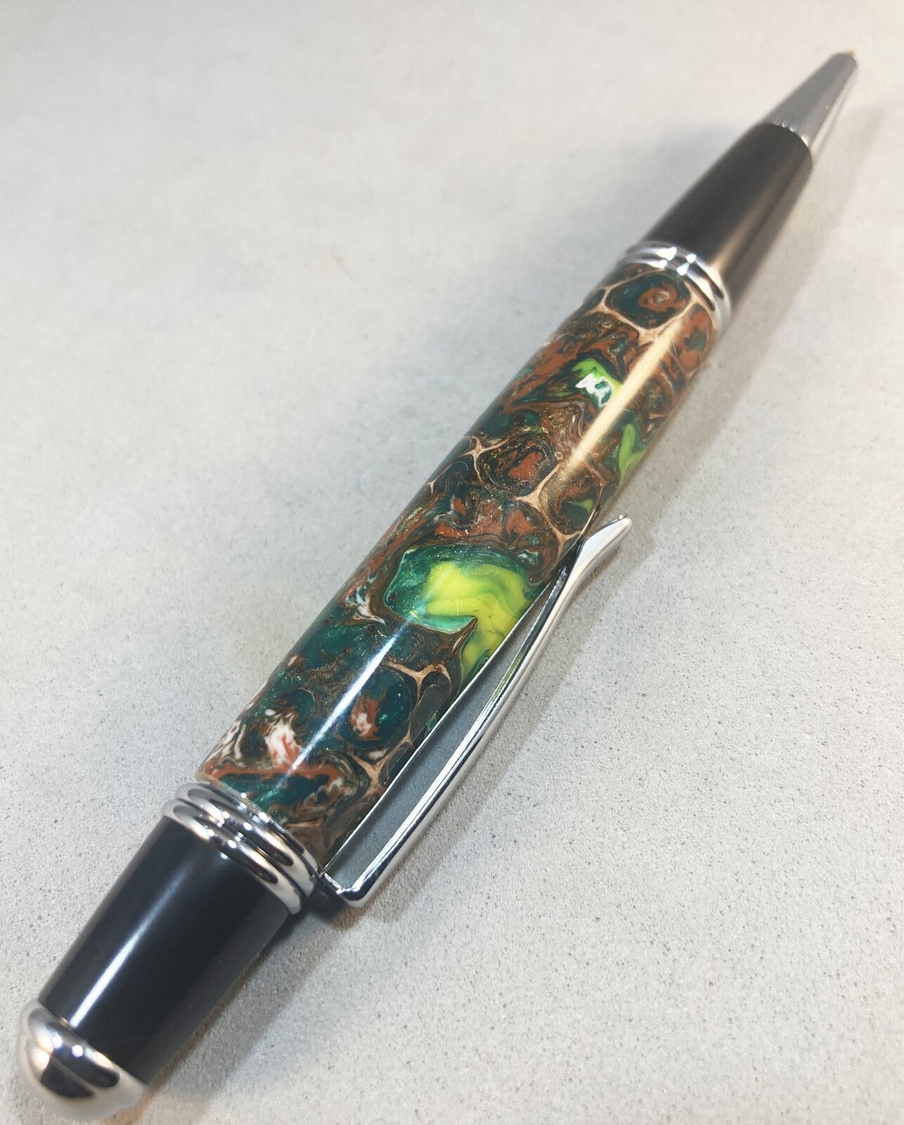

Below is a pen I made with a blank I won from this year's bash. I want to be able to make blanks like this.
I think it would be a great Halloween pen. I see an evil duck in the first photo and a coming human ghoul face in the fourth… or is just my imagination?
