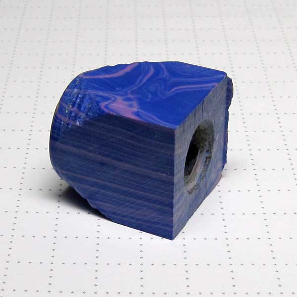

Here is what I use, a little crude but it works. Simply a blank cutoff with a 60* hole drilled in the end to slip over the sharp live center.
