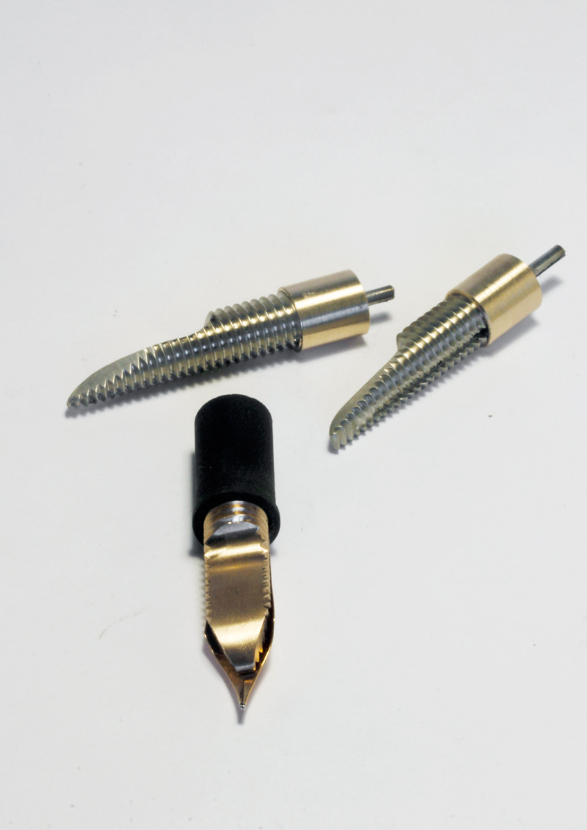

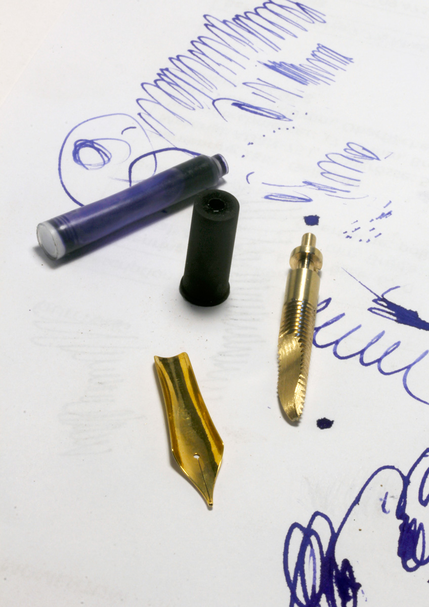

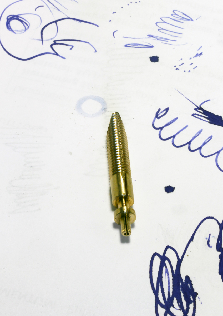

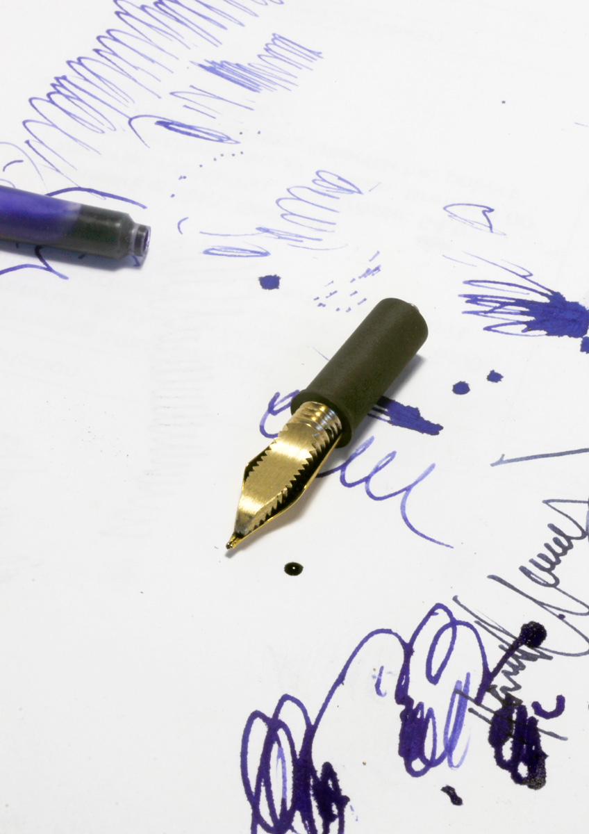

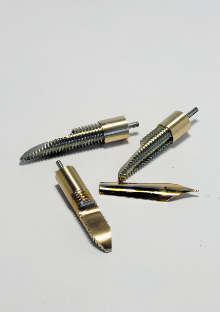

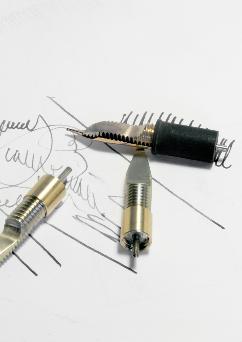

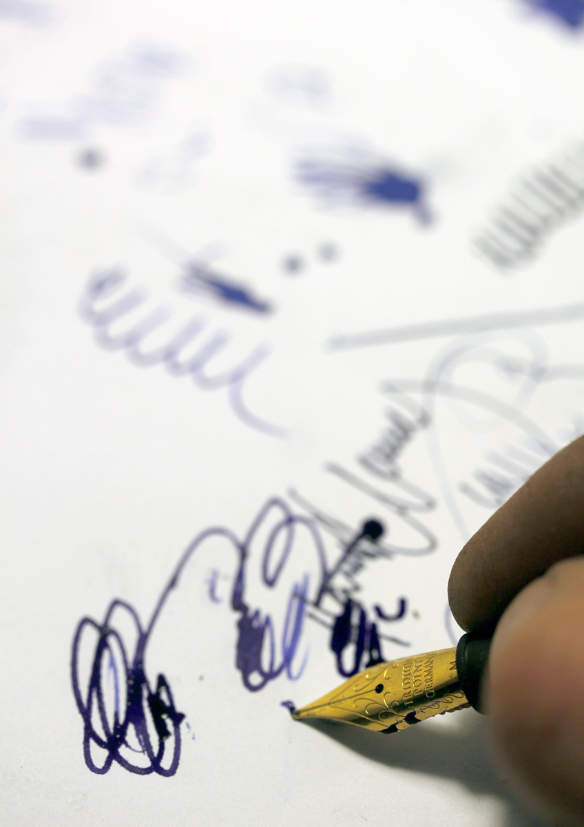

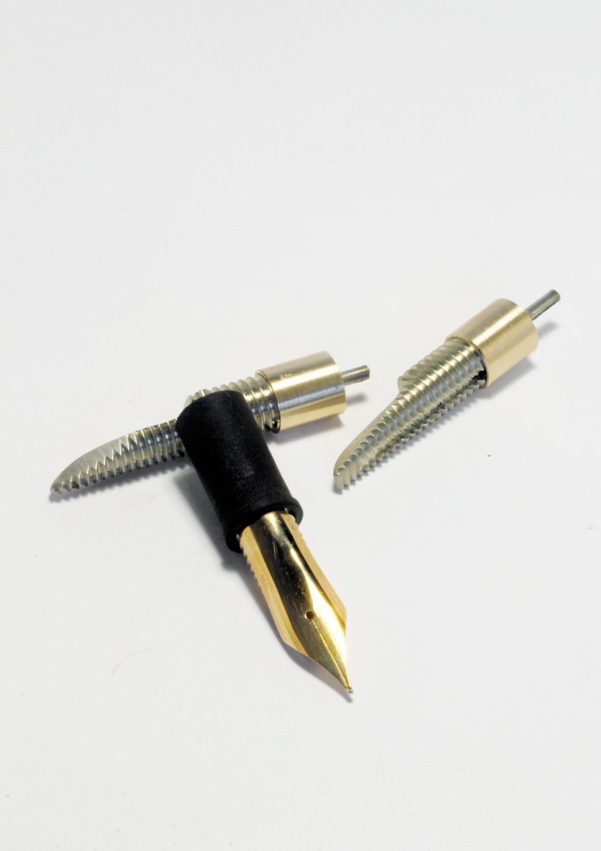

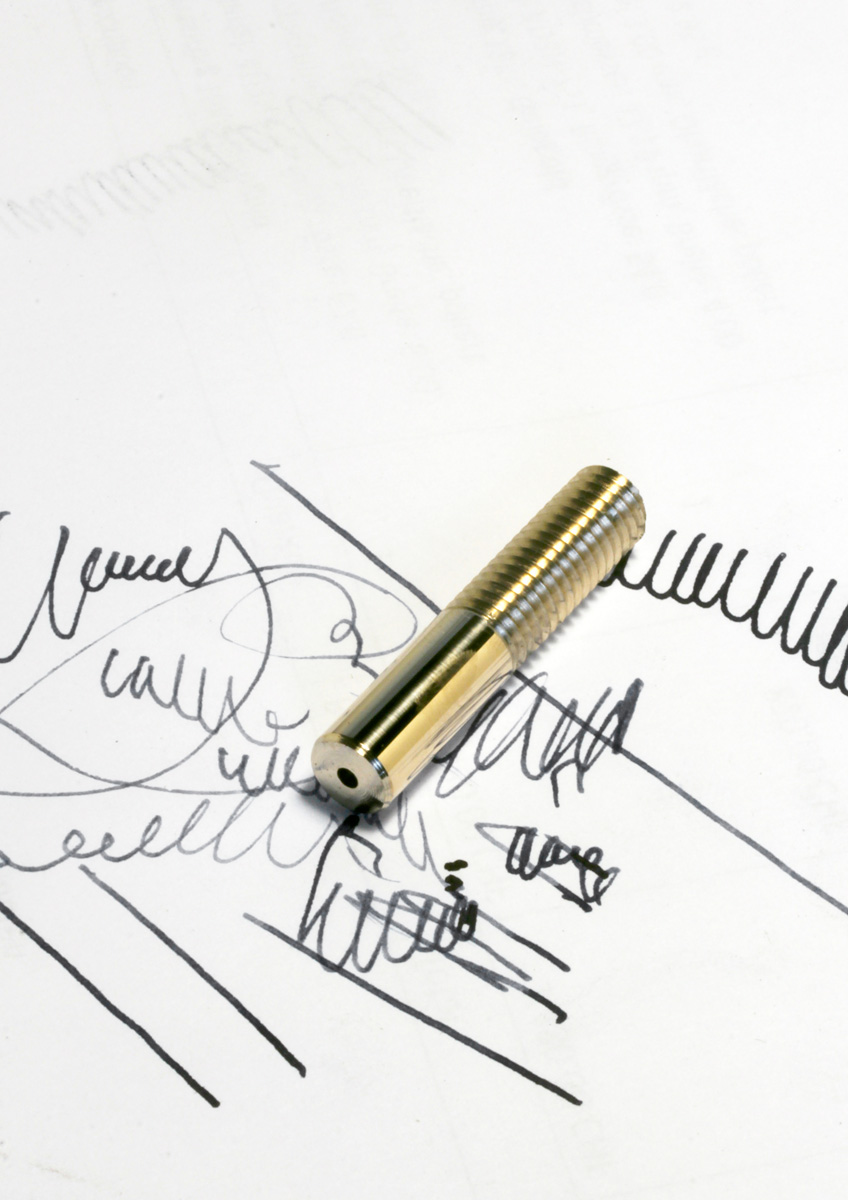

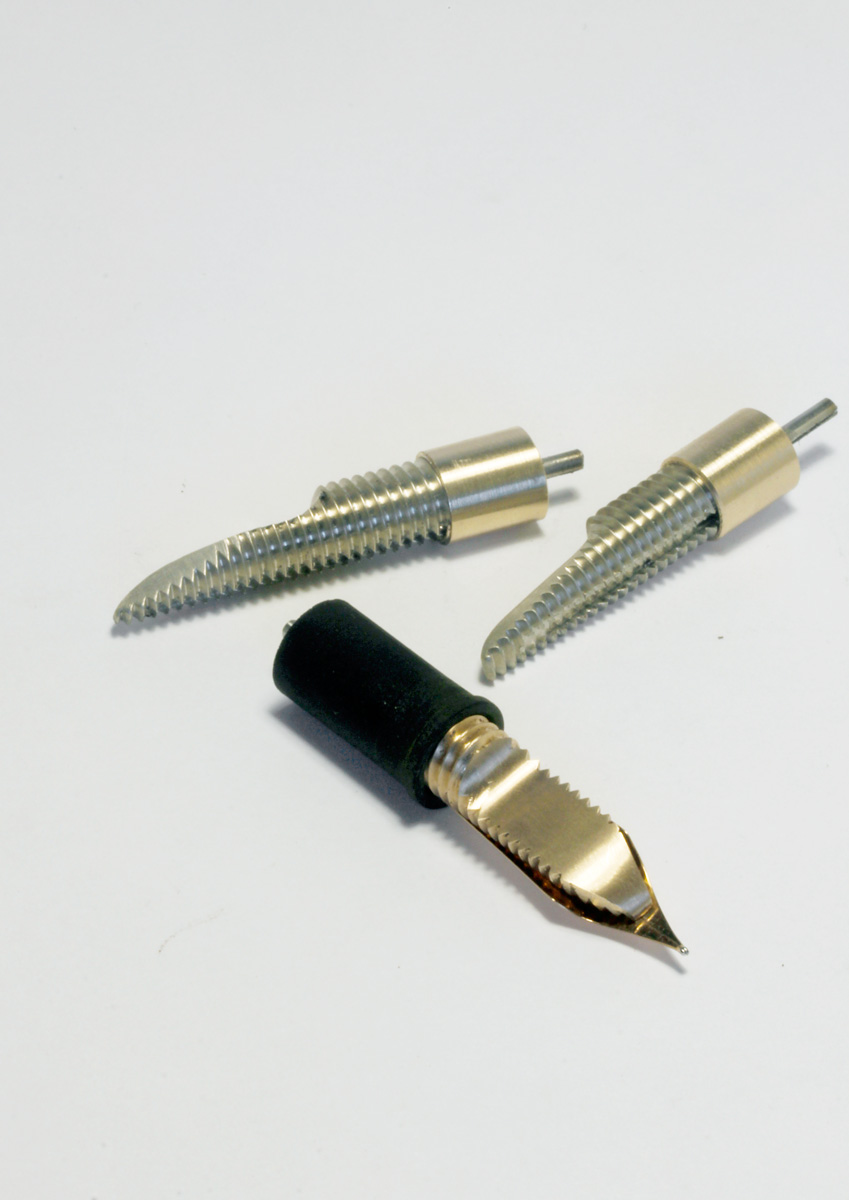

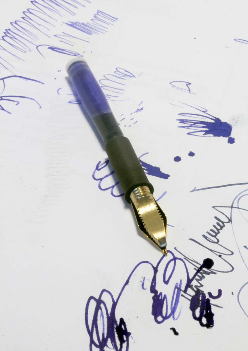

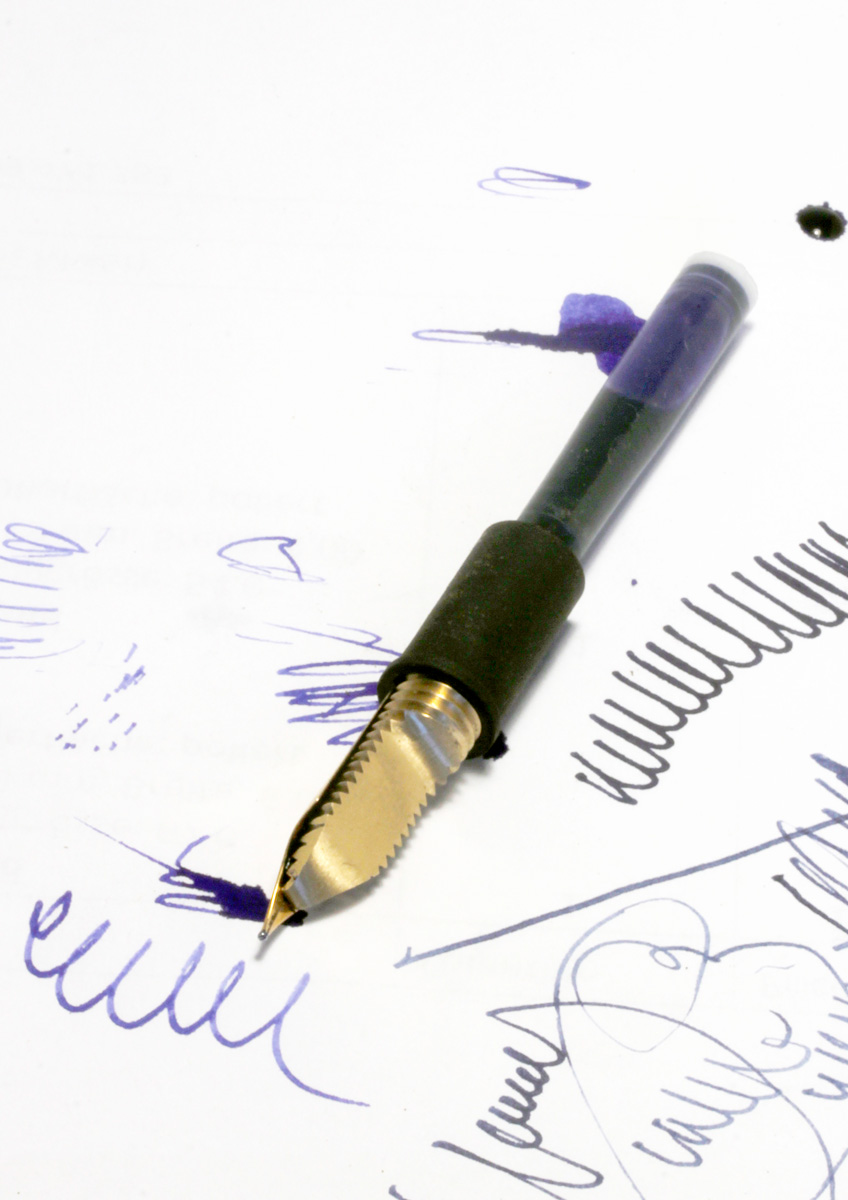

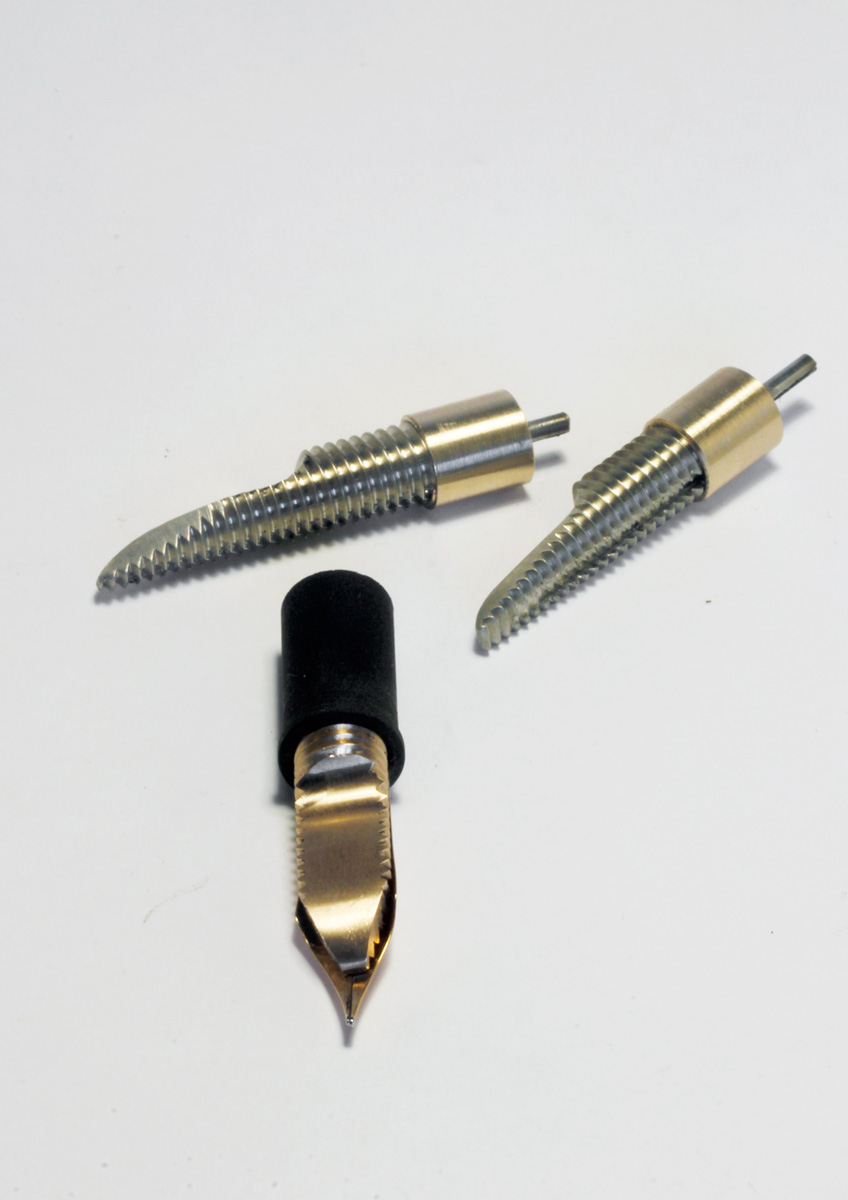

Since a long time, I am thinking and experimenting around to find a possible simple solution for ink feeds. Over the weekend I had the "divine inspiration" just to use a simple screw. The first feed was made from an 8 mm brass screw. Some adaptions were made on my Hauser 2BH high precision coordinates drilling machine. And Ha! – it works, great ink flow. The final idea is to have stainless steel feeds. The extra weight of a metal feed makes writing smoother I find
That is really cool, I would love to try one, please keep us in the know of when you decide to sell any
