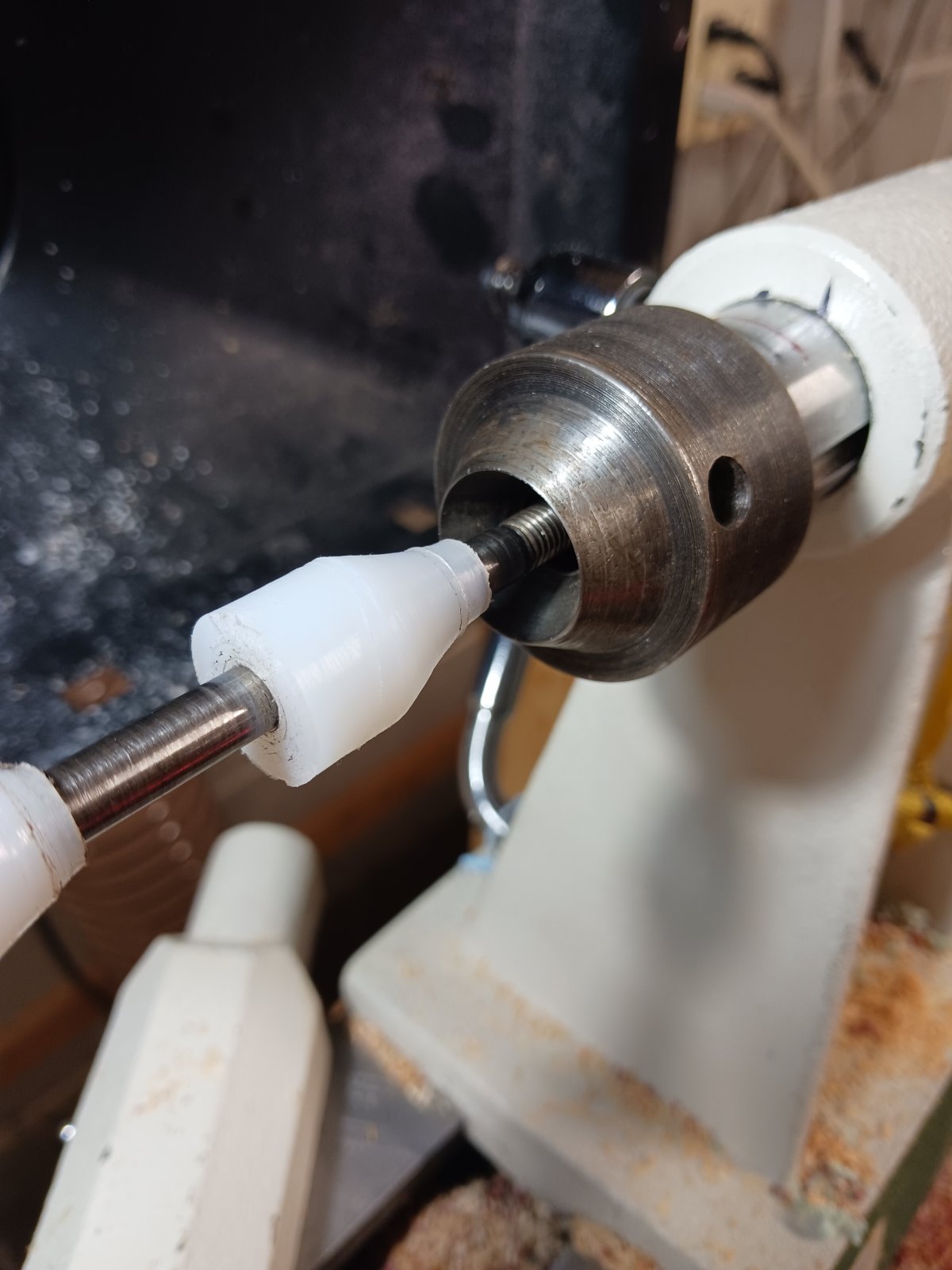

I tossed my HDPE bushings as I had drilled to 7mm instead of 1/4 inch. Worked for me but the ID caused a blank to turn off center. One side was thicker than the accepted diameter and the other side was so thin I got down to the tube. I'm pondering turning bushings that are drilled 1/4 inch for the mandrel and tapered to accept a number of IDs for tubes. An engineer said he used aluminum 6061 T6 and said it turns good. Should turn with HSS tools. Softer alloys not so good.

Have all that but I want to eliminate the bushings for the kits. Only one that would remain the same is the 7mm bushings for Slimline and similar kits. I made a mandrel saver by removing the point of a live center. Here it is. Eliminated the HDPE bushings yesterday. Metal bushing is within a few thousandths of the opening.
I have gotten to where I don't bother to use the correct bushings. I just grab a set that fits the tube ID and slide them on adapter bushings (see pic) made specifically for TBC (turning between centers). Once I've turned them down close to the proper size, I take the bushings out completely and TBC as @Curly said, with the brass tube directly on the centers. Obviously, you don't want to tighten the tailstock too much as it will flare the tube and, even worse, damage your blank. I use calipers to measure the barrel diameter ends so that they match the hardware in the kit. I'm going to do that anyway, so why bother with exact(ish) bushings? The trick is that you need to have the ends trimmed/sanded completely flat and even at the tube ends or you will get an out of round finished barrel.
The HDPE bushing has been eliminated as per my previous post. I want to copy that general profile with the taper to fit several different tube IDs.
