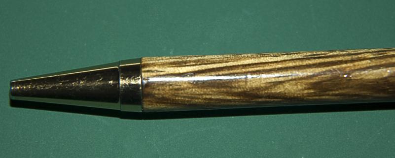

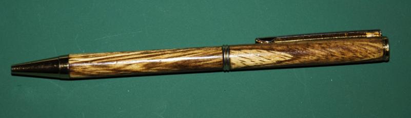

Yes I've used an Airbrush quite a lot!
I've used an airbrush quite a lot and found that Melamine Lacquer thinned 50:50 with Cellulose thinners works very well. It gives a super shiny finish, with not quite the depth of polish or grain enhancement that I get with proper french polish applied in the traditional method , off the lathe, with a polisher's rubber.
The finish you get with melamine, however is very good indeed and survives the test of time brilliantly. A slimline I made over 10 years ago still shines like a good 'en - yes its got its fair share of dents but has not separated or chipped as other finishes I've tried have. (See the couple of pictures below taken tonight)
I usually give the pens between 12 and 16 coats, leaving each coat about 10 minutes to flash off and "de-nibbing" every 3 or 4 coats and the penultimate coat (after 1/2 an hour) using micromesh just to get rid of any settled dust!
The last coat settles down to its final finish over night and usually is great without any further work.
