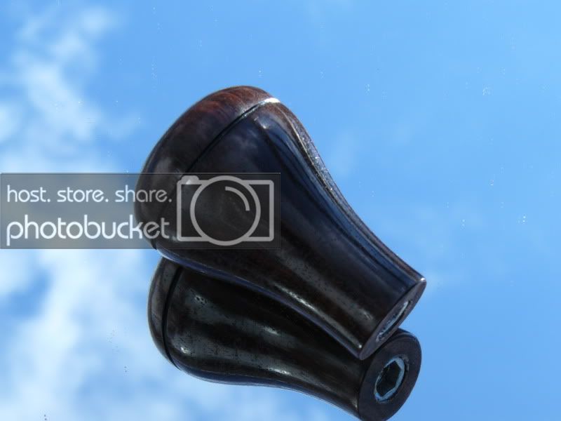

I've had several inquiries to make gear shift knobs which I've played around a bit to get a nice shape and get the threading right. What would be the best finish to use? I don't think I'd want to use a CA finish. I'm leaning toward a good durable wax finish that would hold up well. Any suggestions?
