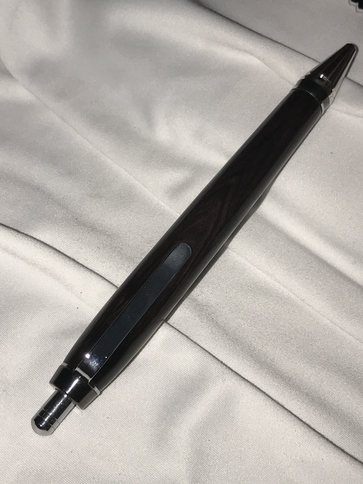

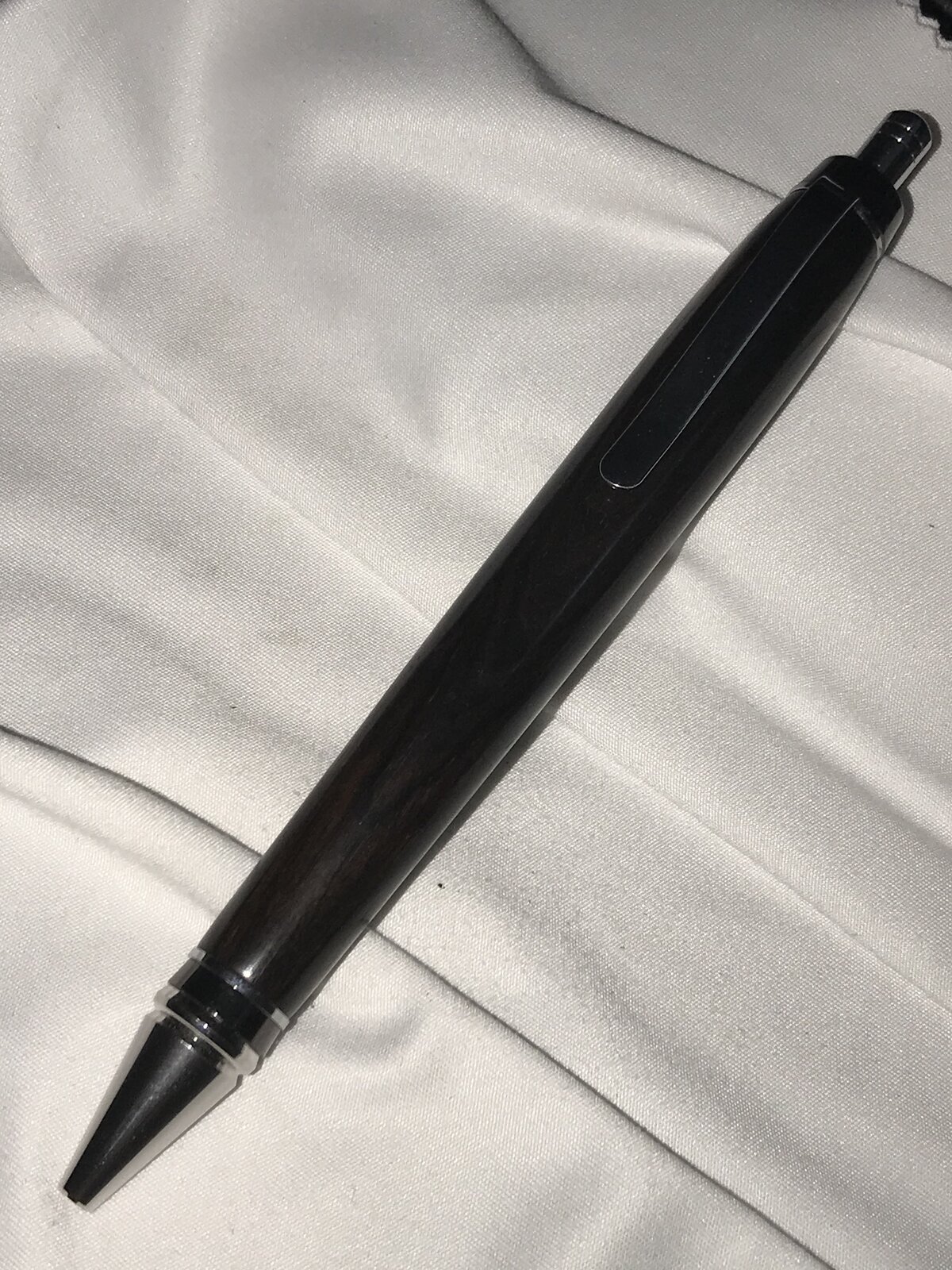

Couldn't watch the blow-out any longer, so went into shop and turned this Cigar Click in African Blackwood. Finish is 2 coats of Mylands Cellulose Sanding Sealer, hand rubbed after each coat, followed by 3 coats of Pen's Plus, again hand rubbed after each coat. This was much more satisfying than watching what is arguably the WORST defense in the SEC.
Comments are always appreciated.

Yup you passed the test; it is on backwards. Noticed it after I made the post. On these Rizheng kits, the decorative ring on the pen nib is not threaded, it just slips on, so, when either it sells or I need to change the refill, I'll turn it around properly.

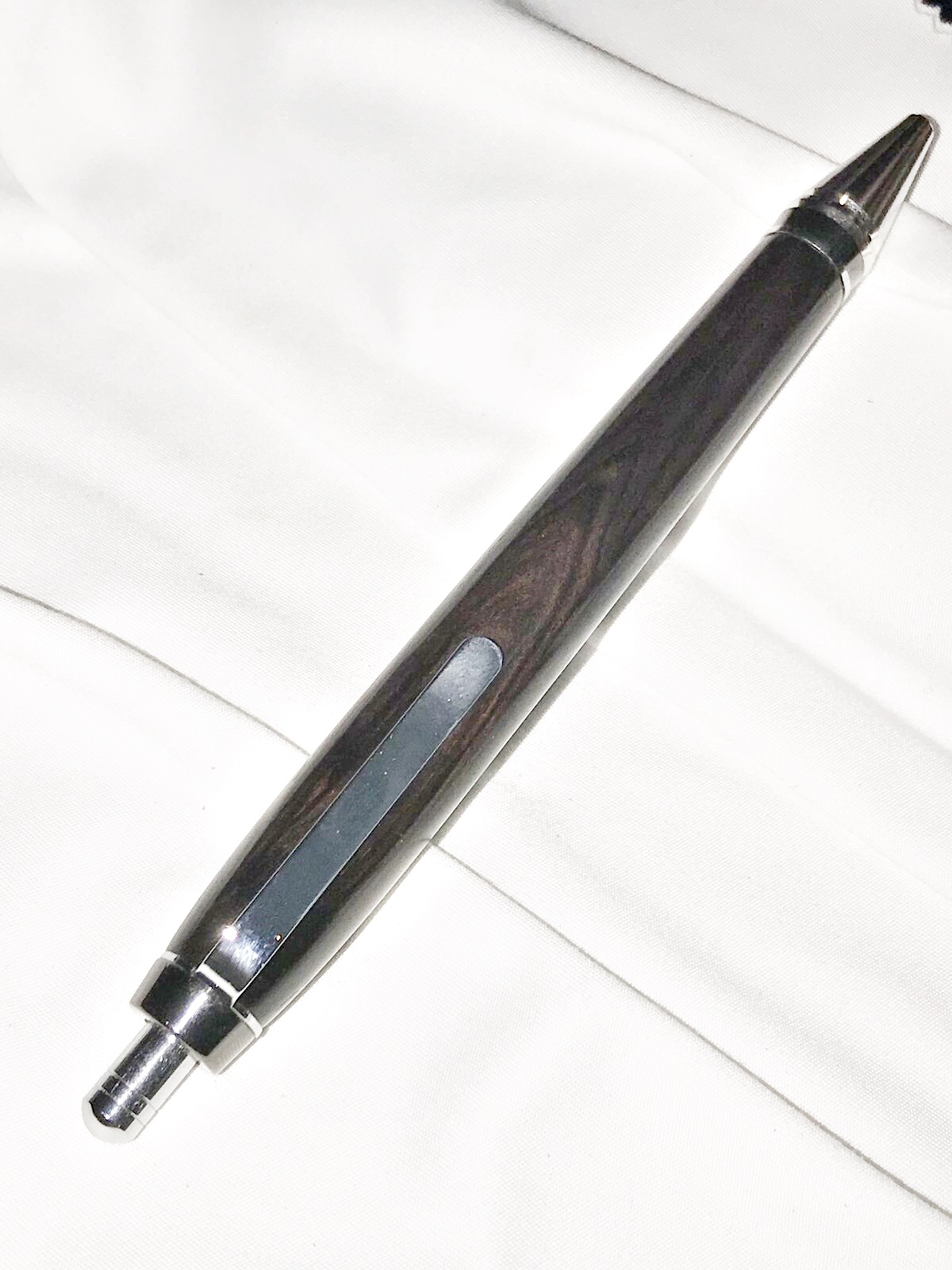

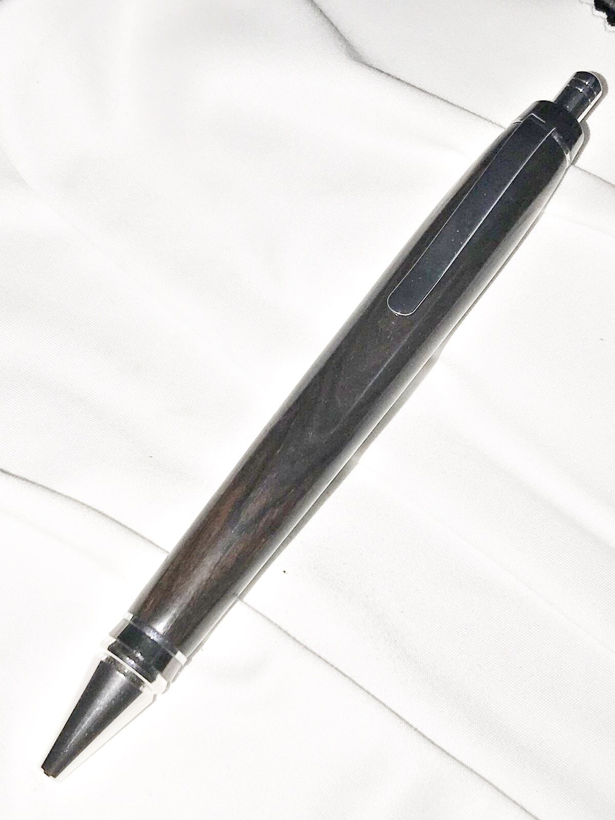

Nice pen. Where did you get the kit? I haven't seen a cigar click in quite a while. And if I may be so bold, you need to either change the lighting in your photos, and/or lighten them in some sort of editing software. I can't even see the grain in the dark photos. I lightened them with PhotoScape, and they're a little better. Are you using your phone camera in flash mode? I've found with my phone, sometimes using the flash will darken the whole image, for some reason.

Christopher, thanks for looking and commenting.
As for the kit, I don't believe they are generally available any more. The kit is, I believe, a Rizheng; I bought 5 of these from someone here on IAP about a year or more ago. At one time Craft Supplies USA had some similar Click Cigar, but they too are no longer available.
You could make a similar pen by using a Slimline Pro - 8 mm tube, I think, uses a Parker-type refill like the Cigar.
Post pics if you do. Good turning to you.

QQuake, thanks for the tip. I am many things, perhaps, a photographer I definitely am not! I'll take some time tomorrow and try to play with some of your suggestions. Thank you for giving me some direction.

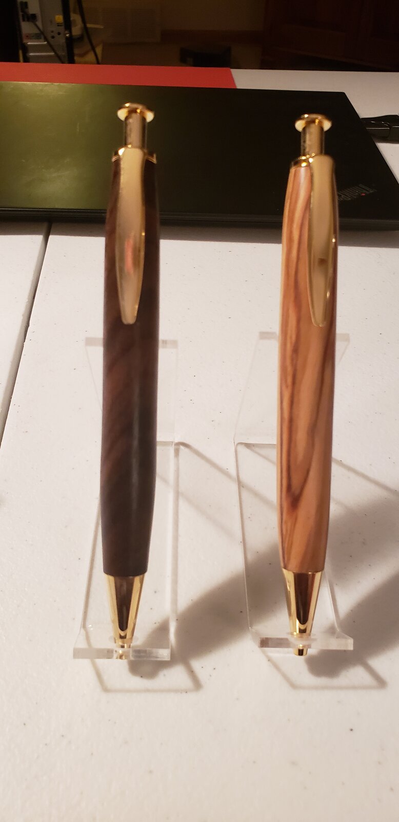

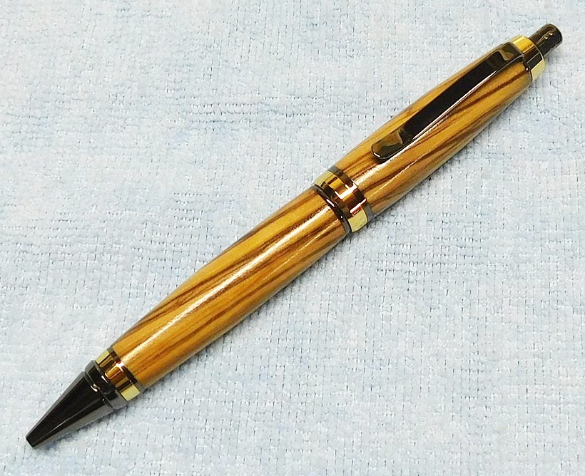

The Long Wood click pen from Rockler is similar. Drilling them out was a pain, but these turned out okay. They are zircote and olivewood.
