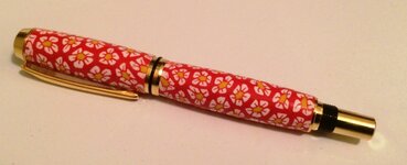

Gave Polymer Clay a Shot

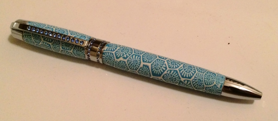

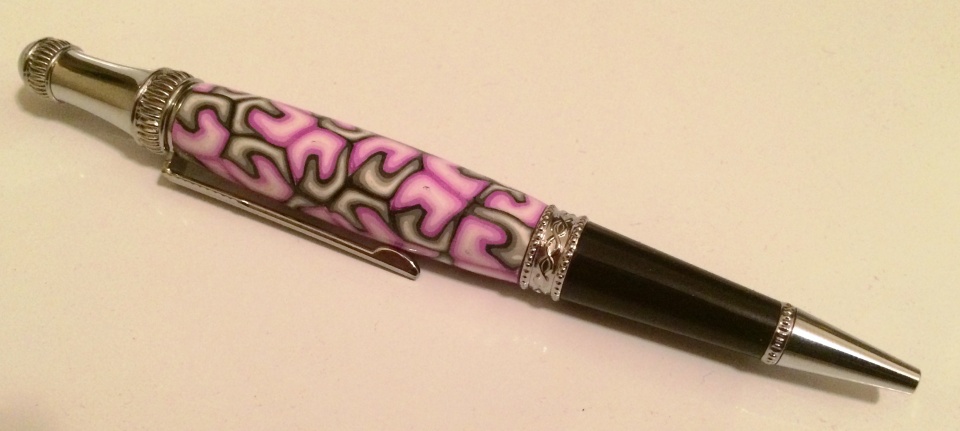

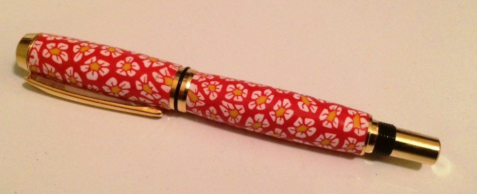

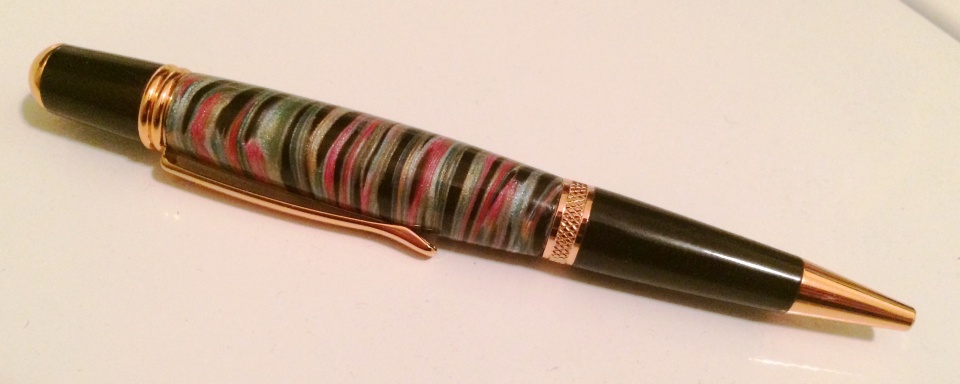

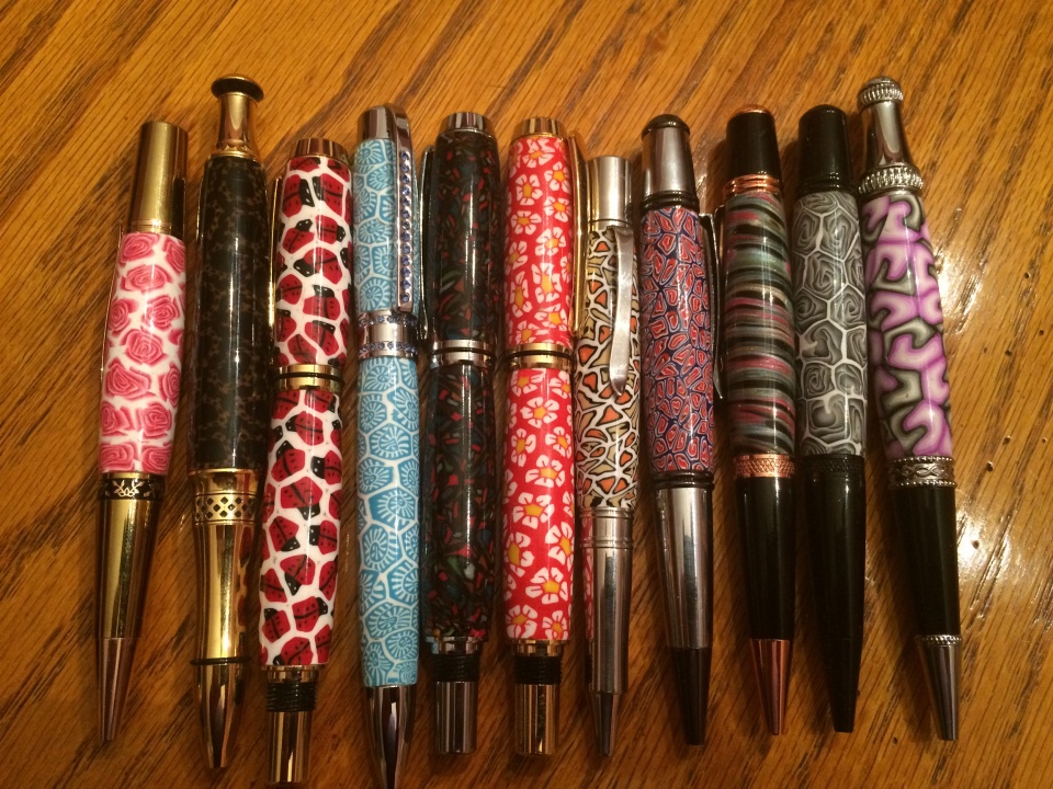

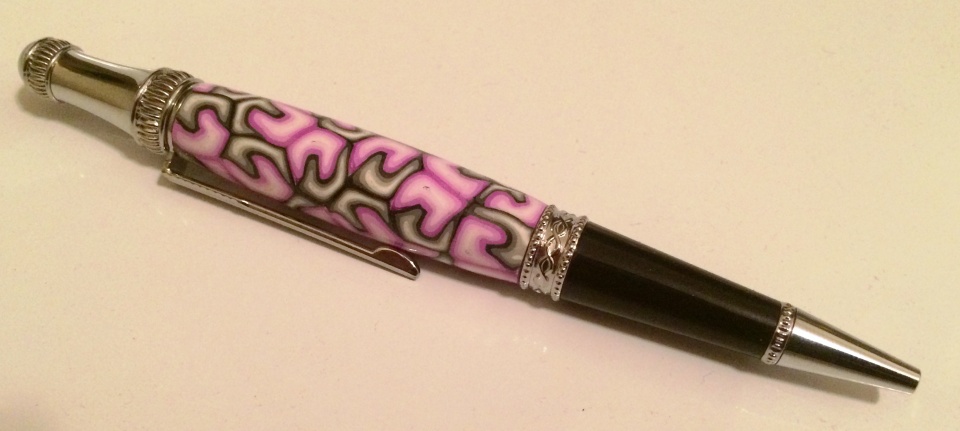

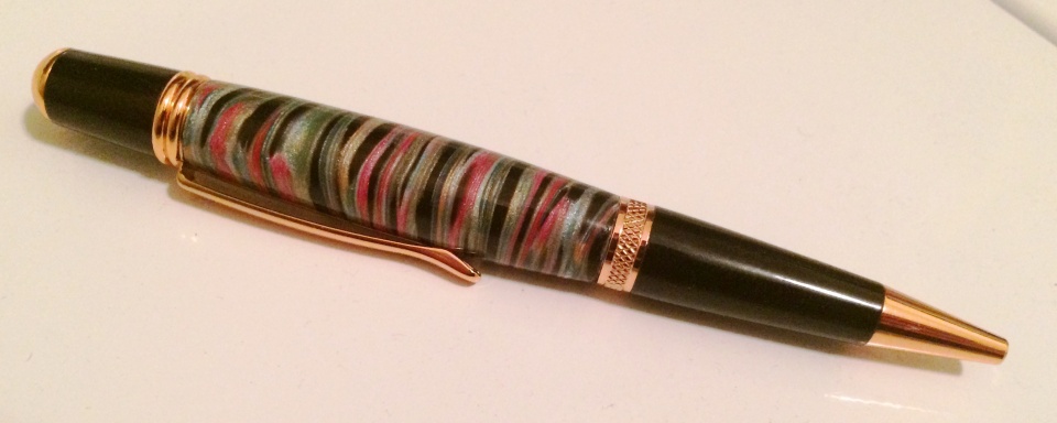

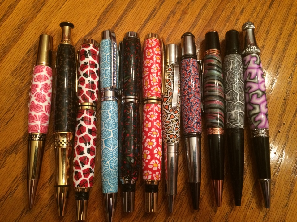

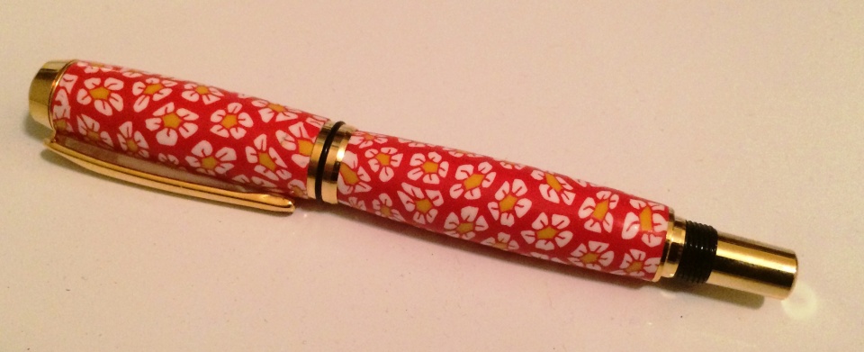

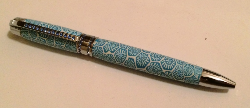

That is a great looking group of pens Jim.
I still don't grasp the concept of taking pieces of clay and making them into repeatable designs like you've done. Where did you learn the technique?
I think that technique to get that repeating pattern is called millefiori. Basically you make one large version of the pattern that you want to repeat. Then you stretch that pattern into a long "cane" so that the pattern becomes long and narrow. Then you can slice off cross-sections of that pattern and they all look the same from the end on view.
I feel that wasn't the best description. Look up millefiori on youtube and also saltwater taffy as they both use the same technique to produce a repeatable pattern.
Those pens look awesome!
I get the concept on taking the canes and applies slices to a base layer that is molded around the brass but would love to know how these are then "turned" and finished... do you bake them first, then mount and turn/sand them? What are you using to then finish the pens with? Thx in advance!
You can bake them. Toni does not turn hers. She just applies to tube and finishes.
Mike, but you have to admit, the work TONI does is beyond the level of most everyone here.
I have done a couple with clay, and it is interesting. I had no luck with a pattern, but that was OK. I applied the clay to the tube, baked it, then CAREFULLY turned and sanded it as if it was wood. I also finished it with CA. So far it is holding up.
But like I say, no luck in the pattern. but the turning was pretty much deilcate wood like
If that is "giving it a shot"; I can't wait to see when you turned a few more! Very nice.
I do bake them first, square the ends as normal. Turn just like wood blanks, only a much lighter touch. Sand with high grit sandpaper. I then finish them with CA.
Good luck. It's a lot of fun.
