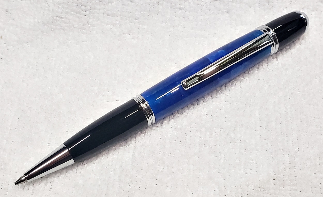

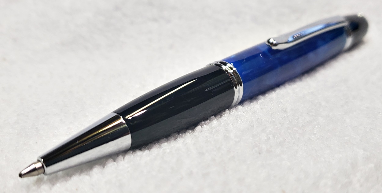

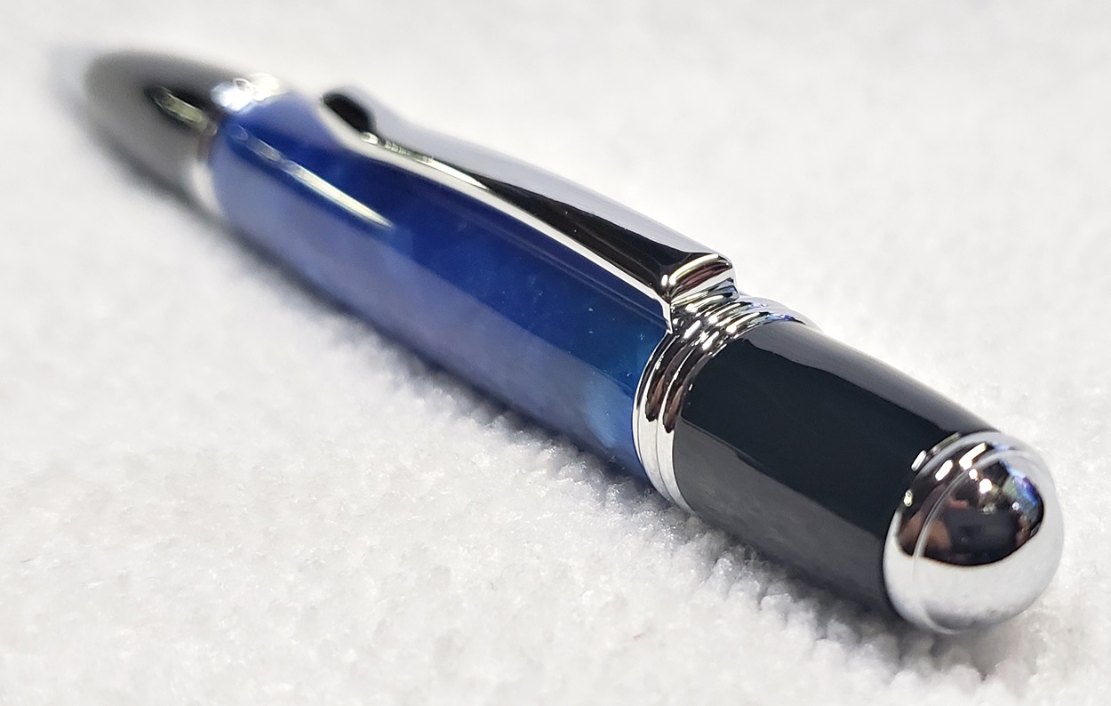

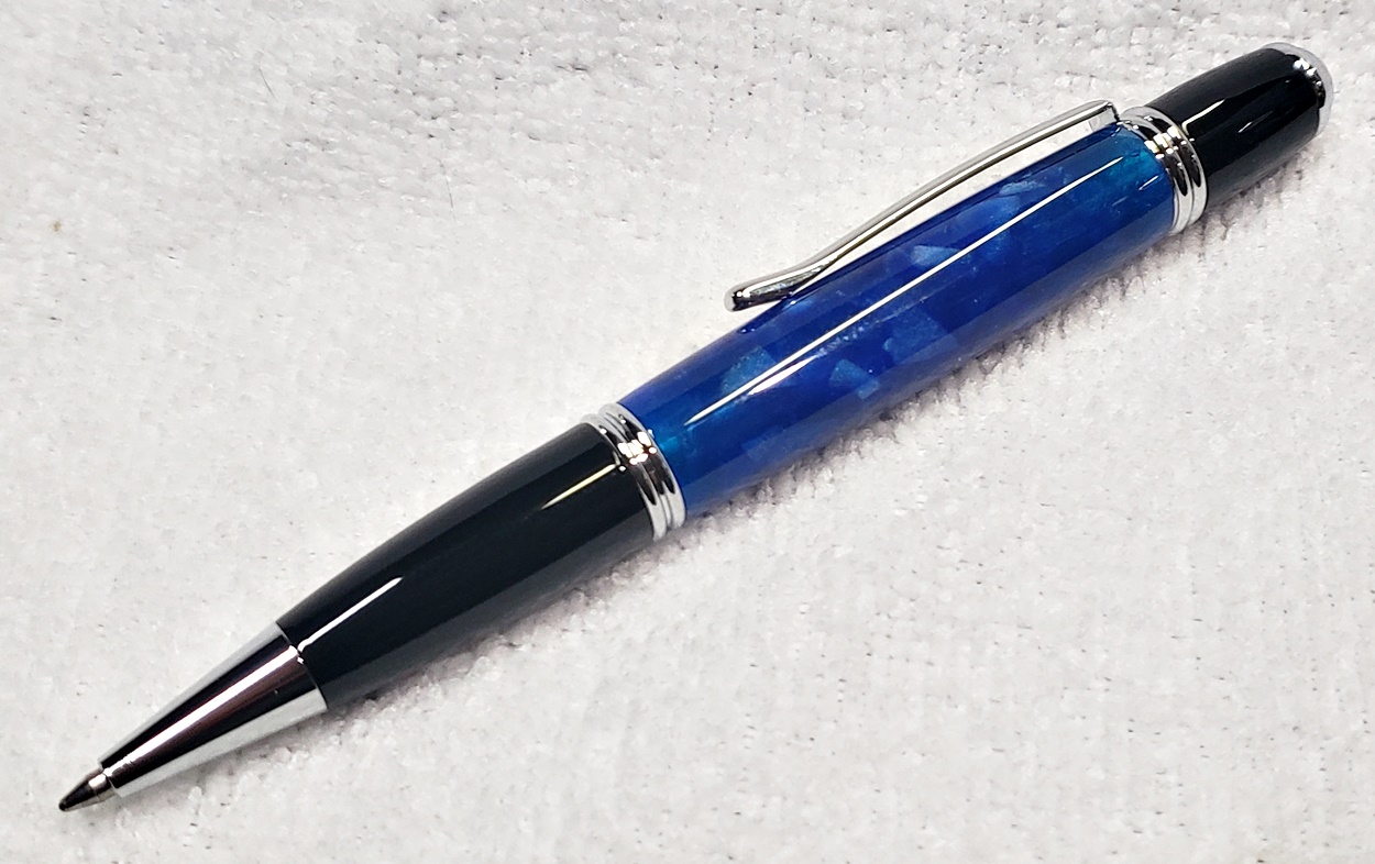

This is a black and chrome Gatsby, with a blank called Sapphire Blue, both from Rockler. The blank is like the old "Crushed Velvet" blanks. I'm a little underwhelmed, there's not much figure in it. I'm used to seeing more "flakes" in blanks like this. But overall, it's not too bad.

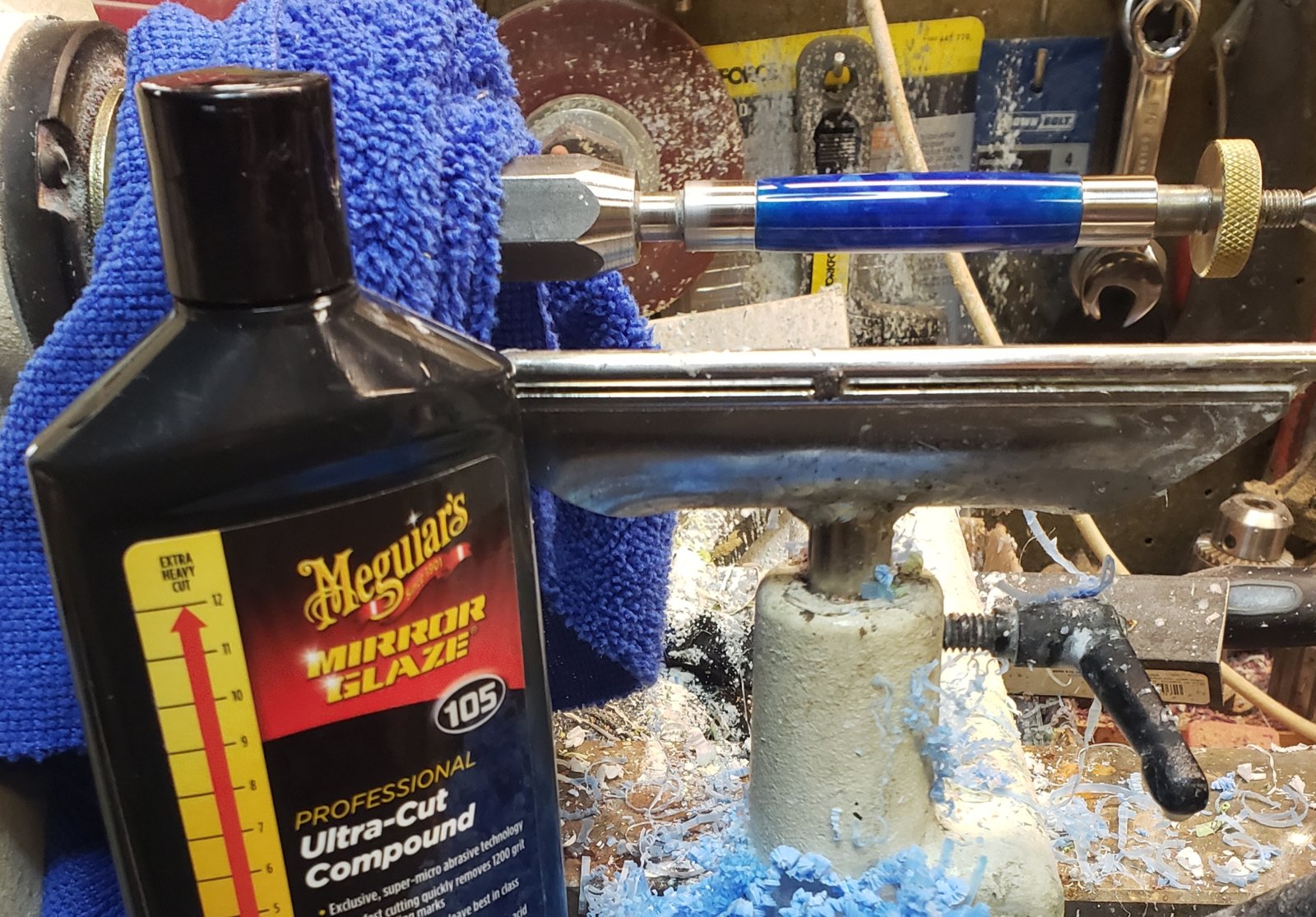

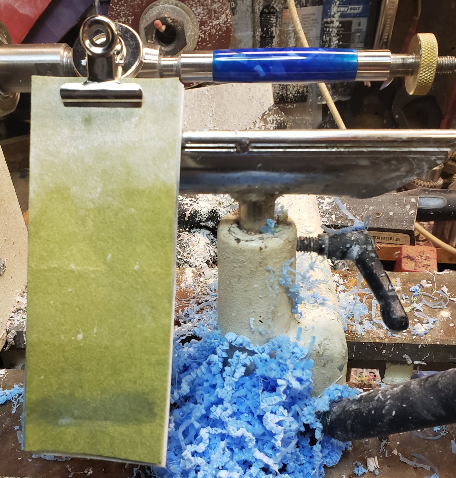

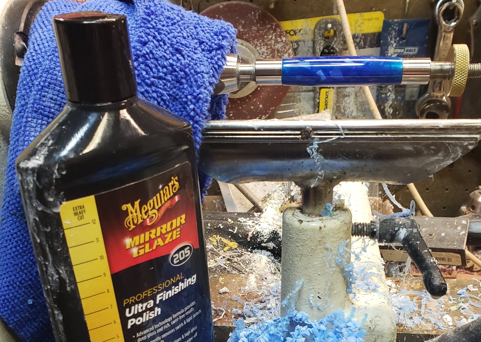

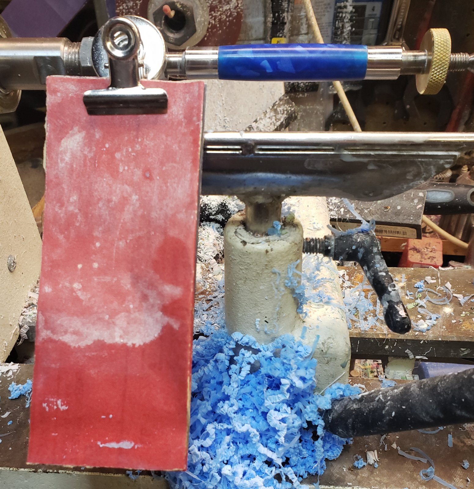

Through experimentation and with TonyL's advice, I've come up with a regimen that is working really well for me. I wet sand with 320-400-600; polish with all 6 grades of 3M Tri-M-Ite wet; then finish with Meguiars 105 and 205.
