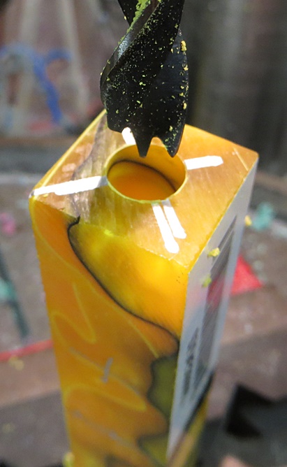

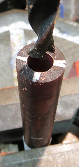

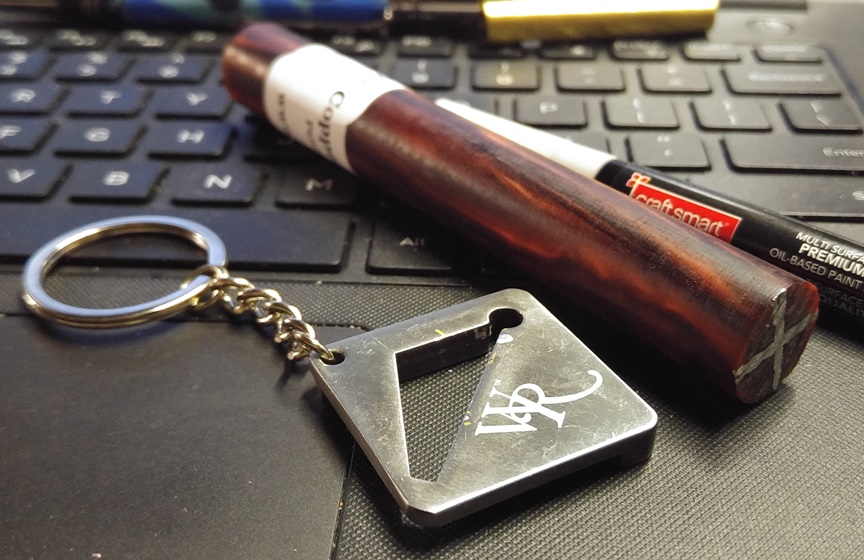

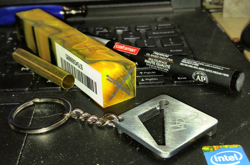

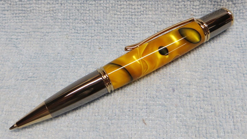

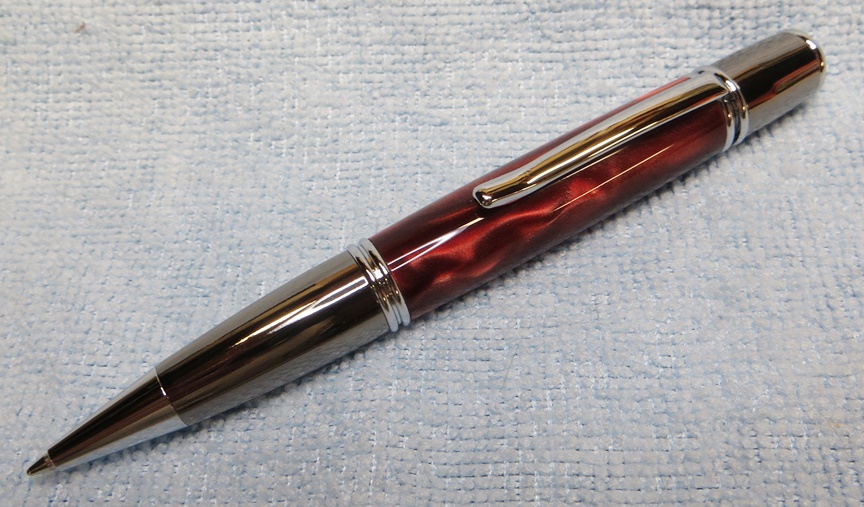

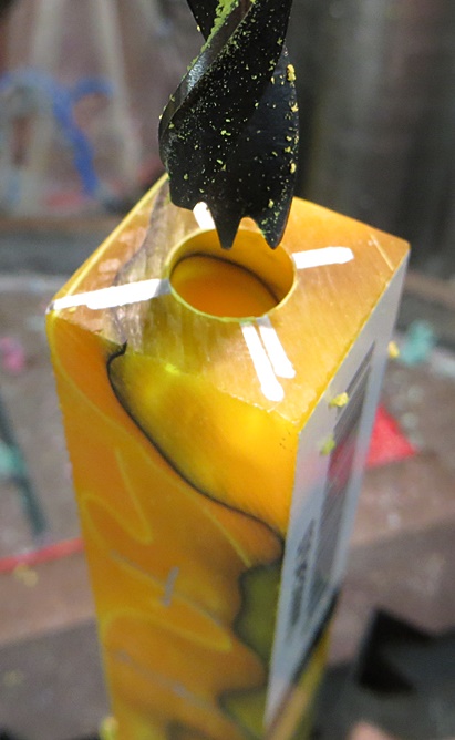

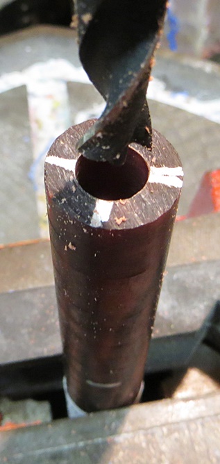

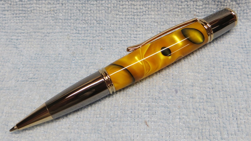

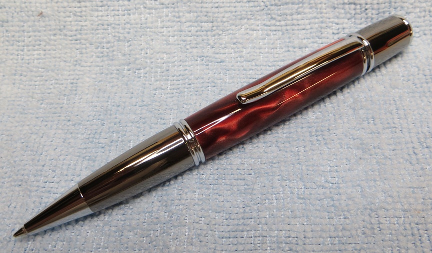

I've turned a couple, and both were with 3/4" blanks. One was round, and the other square. No problems with either.
