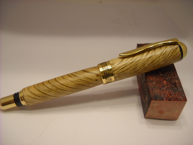

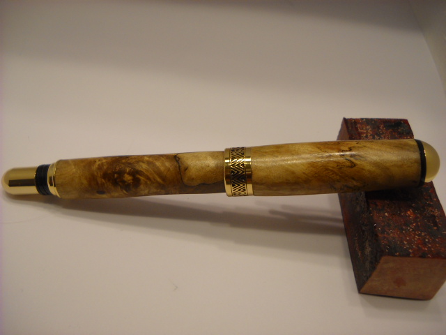

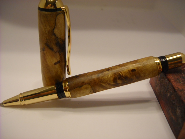

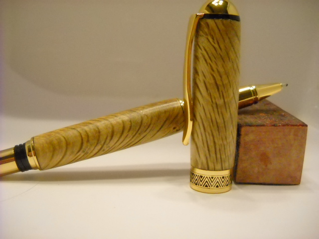

Sedonas w/blanks from Robutacion (George) game #3
The 1st 2 pic are the Tortuosa /Corkscrew Willow and the 2nd 2 pic are Holly Oak, per the timber list that he sent with the wood blanks.:cool:
Thanks George

Thanks mate,
That is the first pen I've seen from the #15Z (diagonal cut), I only recently cut those blanks and the first ever in diagonal so, is as attractive as I always imagined it to be.
The #33B (burl) stabilized, does always look good...!
I'm not sure if is the way the #33 pic comes up in my computer but, it seems to is slightly undercut at the bottom barrel's middle part, you may have hit a hard/soft patch, even though the blank was stabilized and the tool dug in a little.
Is not the end of the world but, if this is actually the case, you can fix that by, putting the barrels back on the mandrel/lathe and try to even up the high spots very gently on the bottom barrel and remove a little on the top barrel so that they will match and then, built up with CA with enough coats to bring it to the bushings size. It will be a deep gloss finish but it will improve its looks considerably...!
You always serve much better a good friend with the truth, rather than trying to be friendly with a lie...!:wink::biggrin:
Cheers
George

its the pic ,after i took the pic and looked at it i went back took another look at the pen..good to go . so i though i would post it to see if anyone would see it .. and say anything and George was on it . and boy is that holly oak hard or what
Well mate, I know your work, and got me puzzled that I saw the same indentation on both pics so, and as always, I call it as I see it and if I see it wrong, I appreciate to be corrected.
The whole this is that, other that may not know your work, may have looked at it and simple think that you aren't much good, when I know, you do good work so, bringing the attention to the issue publicly, would give us the opportunity to clarify any doubts that could go through some people's minds, and I don't wanted that to happen...!
The issue of taken quality and accurate pics is even more difficult than turning pens, photography is an art all on its own, some simple cameras do sometimes a great job for people with not a lot of knowledge about the issue but, I've seen a big increase of pen turners investing good money in cameras and other equipment such as tents, lights etc. that can produce some extraordinary pic quality but I have to confess, not for me, I'm a "point and shoot" type of guy so, I know my limitations also...!
As for the #15 Holly-Oak, yes it is a dense wood that is also very tough however, it finishes easily and beautifully, indeed a quite different wood to work with than most...!
Cheers
George

George thanks and if i had not seen the pen in my hand i would say the same thing. i did not think how it would make me look,if i had it to do over, i would not have posted to see if anyone noticed the curve that my point and shoot camera put on the pen,i would have reshot the pic of the pen...but its to late by the time i get home this afternoon it will be on its way to Tenn.
