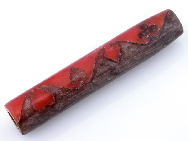

I tried to do a polyester pen with two different colored resins in an interlocking pattern. I wasn't thrilled with the results. I had tried the same technique on the Puzzle pen I had done and never got the resin to cure. That was done in wintertime, so I wondered if the temperature had a lot to do with that. I tried it again and got the resin to cure, but it still didn't fill the alternate areas like I would like. I had to laser the pattern pretty deep in order to fill above it, and the heat distorted the cut line slightly. I think that the residue left over from lasering must play a part in the resin not curing right in the dividing point.
I am still toying with the idea of doing it in two colored woods, but the laser beam gets wider as the wood gets thicker. I would need to compensate for the beam width and match the draft angles to make that work. I think I would also lose a lot of detail that way. Another thing to try is simply engraving a shallow distance and coloring the lasered stock in a contrasting color. The detail is much crisper that way. The top of the pen will have rotating dice to complete the theme. :)

Cteaglesc and Pastorbill, the laser did fairly good job on cutting the one side. I did it very similar to the way you described, but the laser runs into trouble if it gets far enough down to reflect the beam off the brass tube. You get reflections of the beam cutting through the part in places you don't want it. The extra heat also remelts or ruins the plastic. For this reason, I didn't go through, but rather just cut the design and got rid of the extra material in between with a hatch pattern. I used low power and repeated the burn several times to get the depth I wanted. I went back and cast another color over the first and turned them both down. I just don't seem to ever get great results when trying to cast like that. It does look a lot better in person than the picture allows, but not the quality I had in mind. I imagine it would look a lot better if it were sent to someone more accomplished in casting. I think I could use tinted CA and get better results than I did with the second color of polyester.
