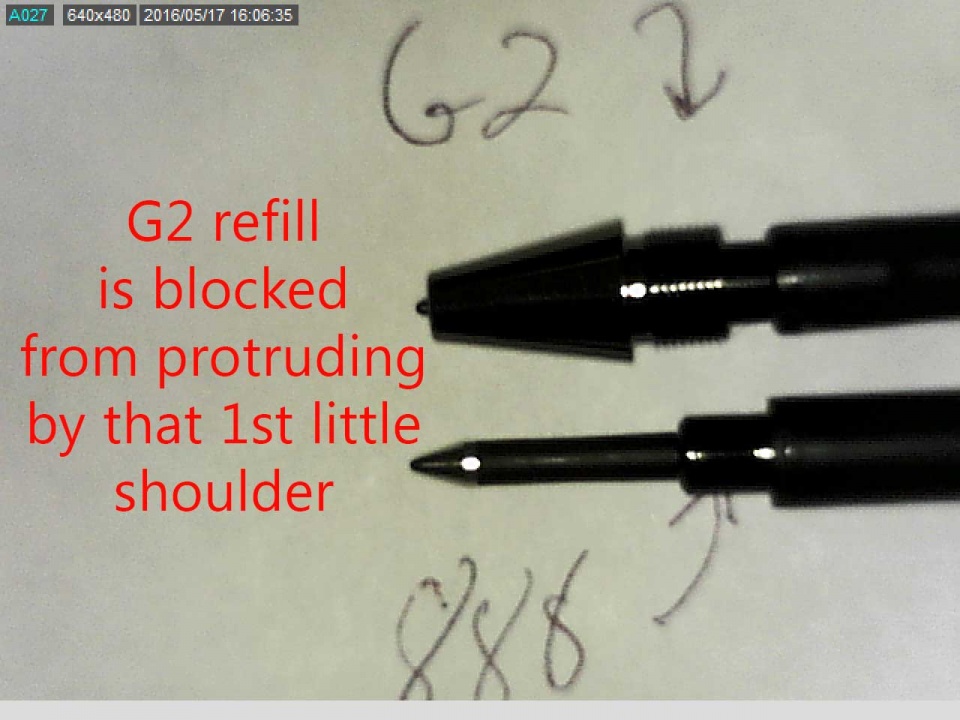

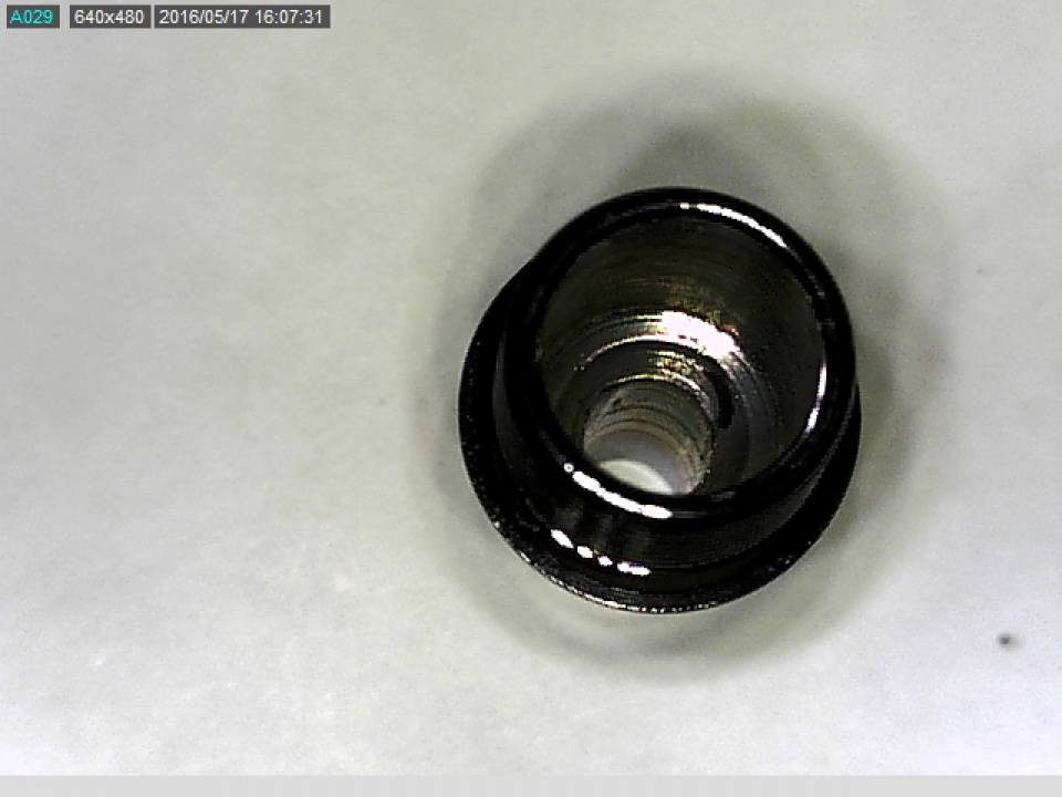

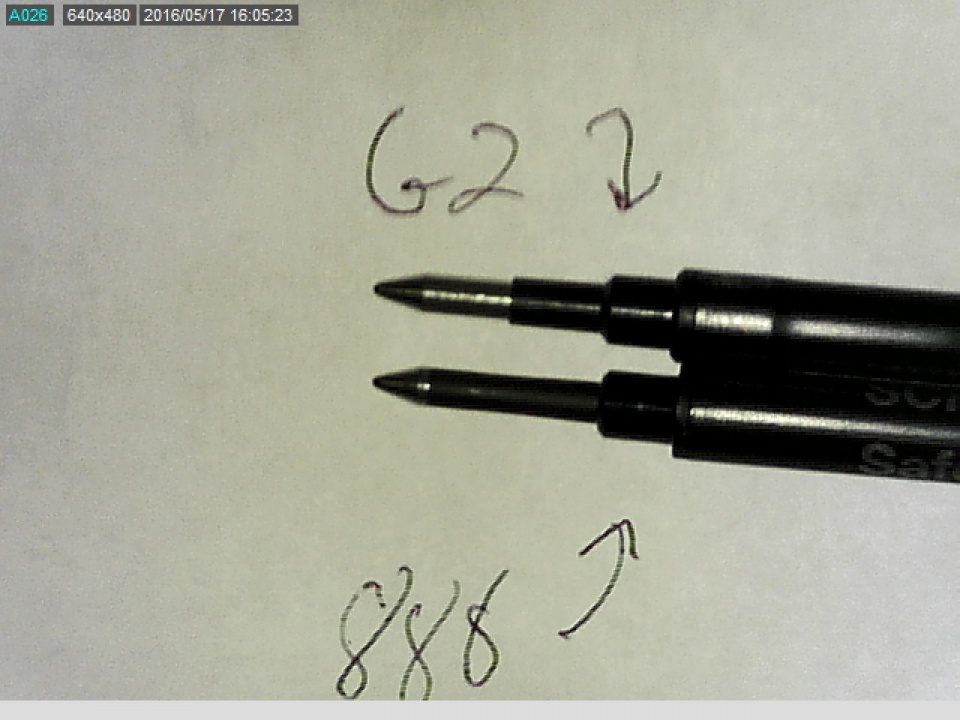

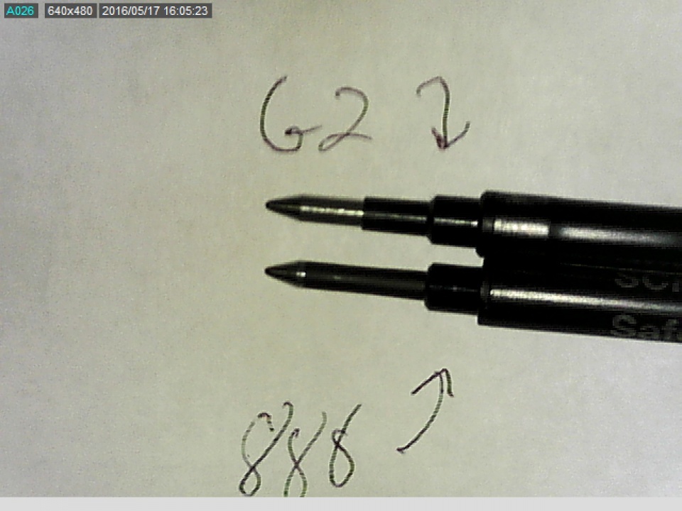

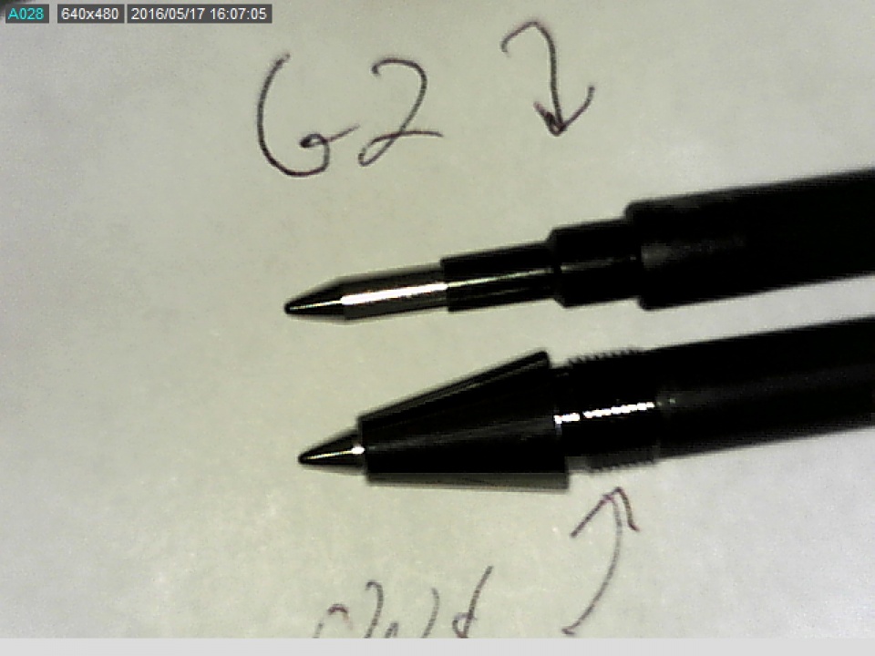

I prefer the G2 Gel, but noticed it was a no go in a recent JR. Gent I did... so I used a Schmidt 888.

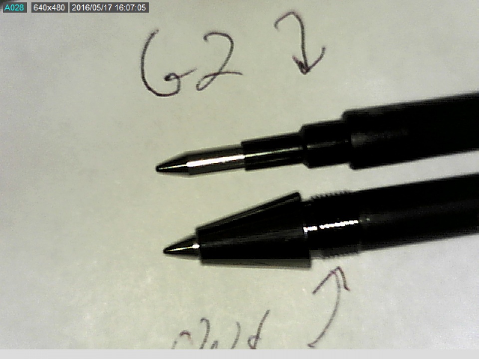

While the tip on the 888 and G2 is the same, the 888 maintains the narrow width to a greater dept than the g2. G2 has a little step collar before the big shoulder. For a Jr Gent to accommodate the G2, it looks to me like the inner diameter would need to be drilled out a couple of mm on the body side. With this mod, I think it would still work for either.
Anybody tried this?
oops... should clarify -> Rollerball version
Oh, I think I should have said "Jr Gent II Rollerball non-postable" as I suppose the ballpoint is different than the Rollerball.

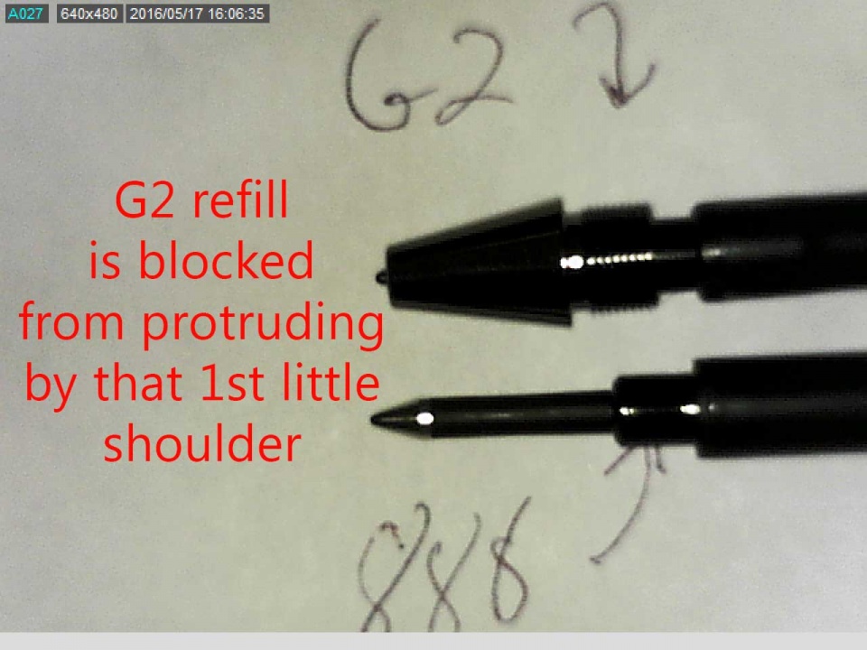

I'll attach a couple of photos to show what happens when I try to put the G2 Gel in - it just barely protrudes before it catches on that little shoulder that doesn't exist on the Schmidt 888.

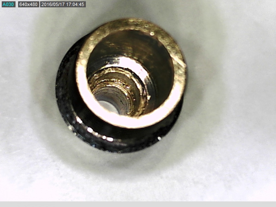

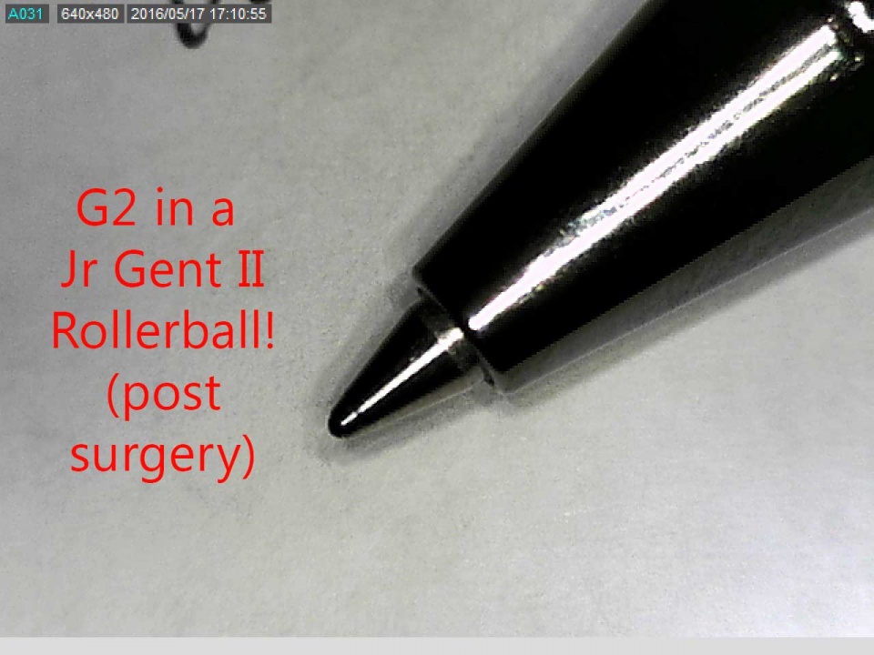

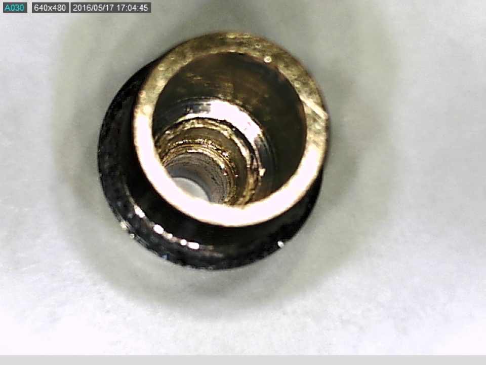

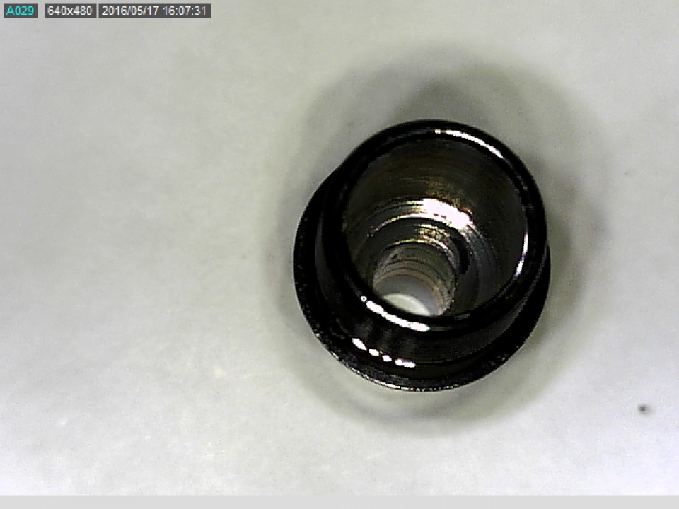

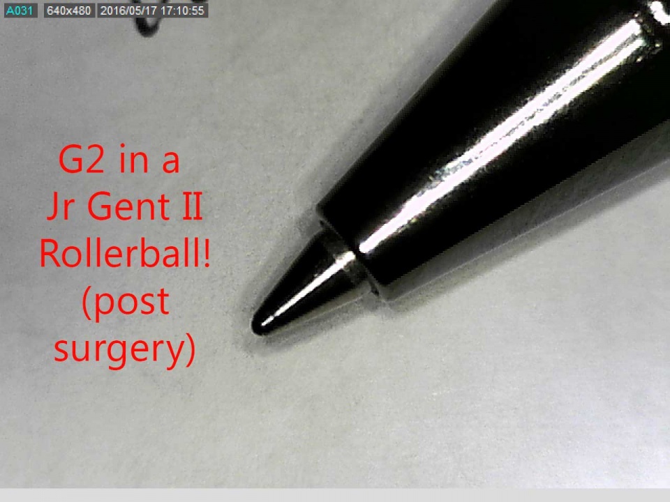

Ok, got it sorted...
I just took an 1/8" bit and drilled out a few mm (drill, test fit, drill, test fit, etc.)
Then the big shoulder was blocking just a little bit (less than a mm). This is the same thing that happens when you try to put a G2 Gel in a Baron. So I solved it the same way - by lapping a bit of the threaded end of the nib like you had to do on a Baron when you put a G2 gel refill into it.

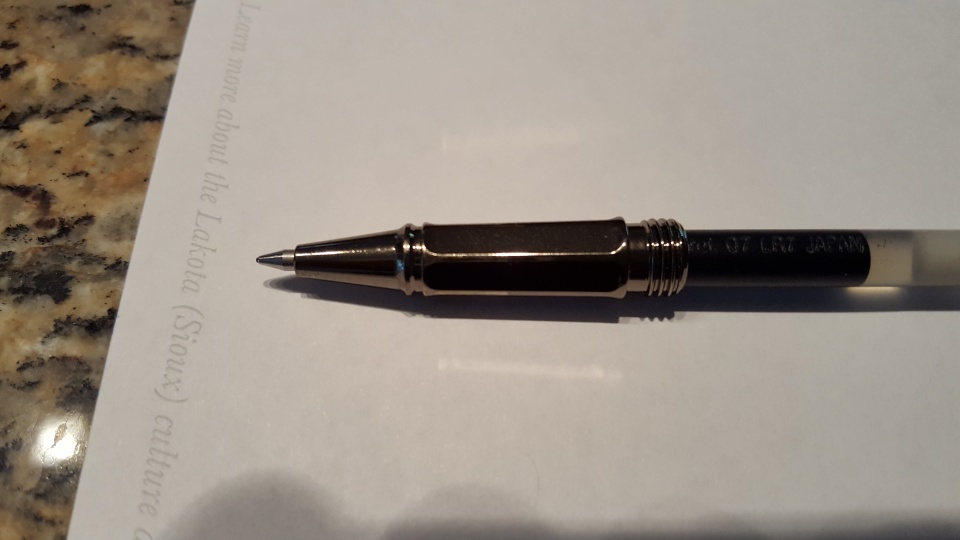

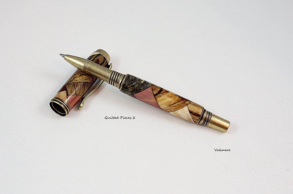

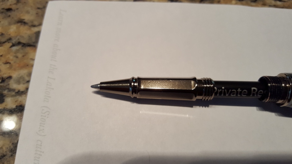

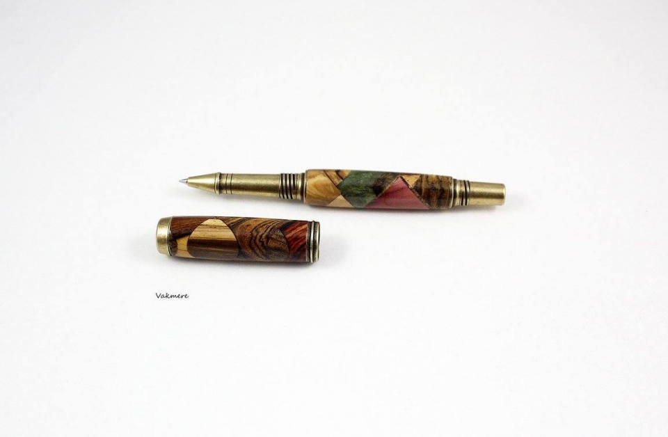

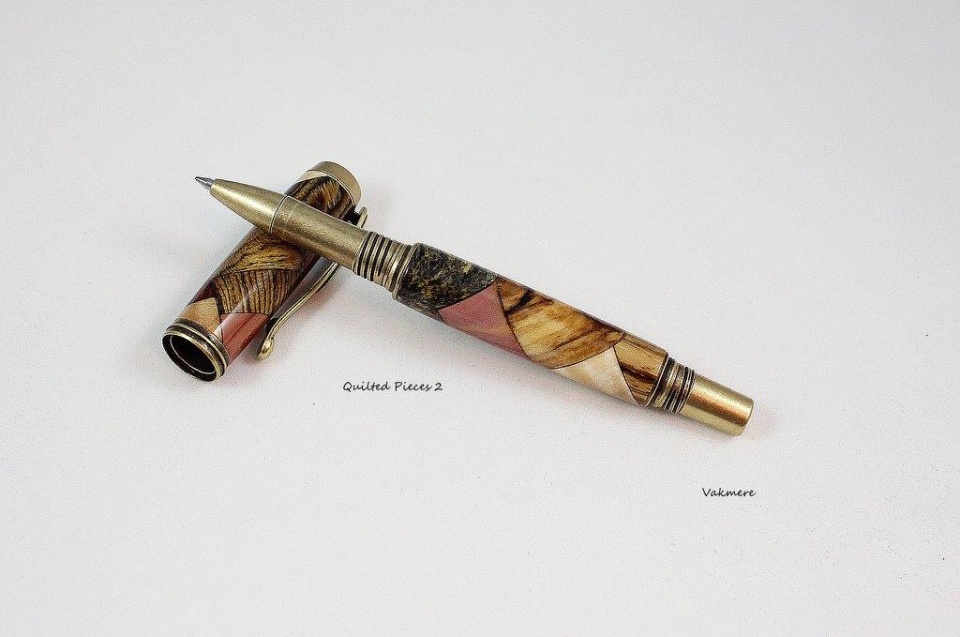

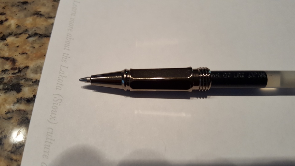

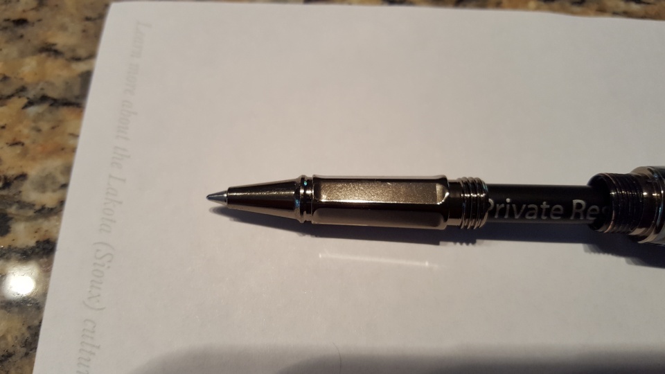

Good video, here's my trials with the rollerballs in a Baron. Pic#1 - Pentel, Pic#2 - Schmidt, Pic#3 - Jr. George & Pilot G2-07, Pic#4 - Jr. George & Schmidt. So it seems the Schmidt protrudes just enough to be annoying but the Pentel, for me, is far enough out where I like it. The design of the front end dictates what we can substitute. I also use Pilot and Papermate rollerballs however I have to experiment with each kit to see which fits better. THE BIG DEAL is which one writes better. I prefer the Pilot G2-10 and the Pentel .07 over the others.
