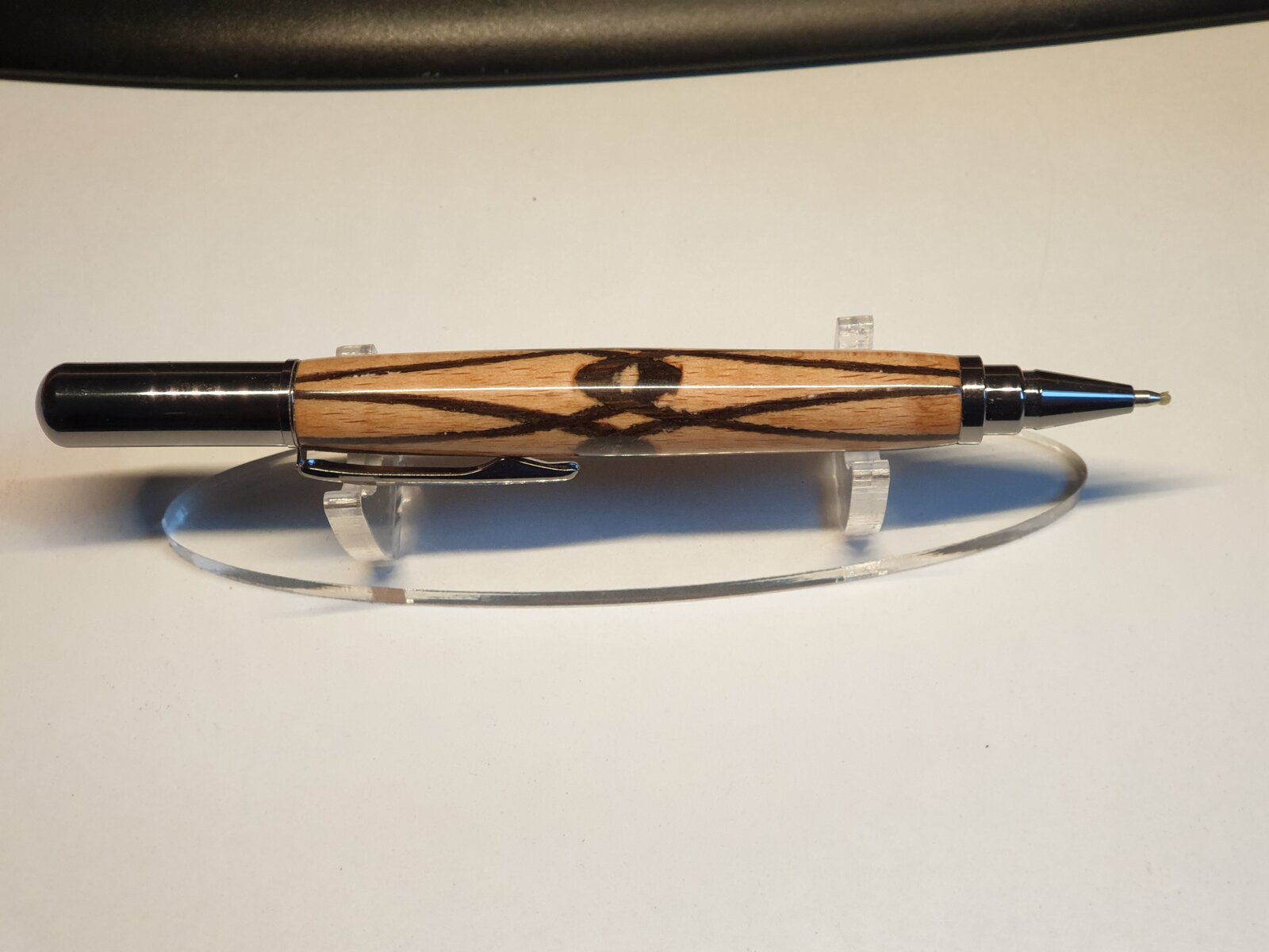

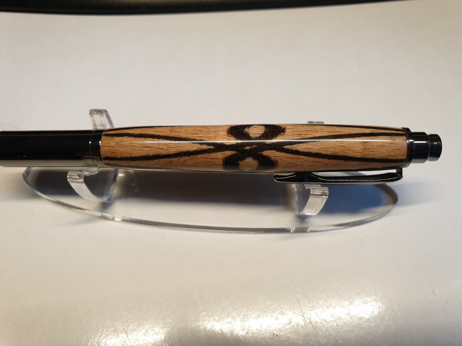

My bandsaw circle jig works well but the blade is not cutting very smoothly.
Nevertheless used it for a rollerball.
The knot i didn't expect, wanted some curved lines.
CA finish

I think you are on to something. Exciting when something surprises like that! Well done.
I wanted to turn slimmer but the knot-effect would be gone. I measured all with a digital caliper and wrote it down.
The initial blank was about square 24.6 by 24.9 mm.
Drilling was perfect in the middle i thought, measuring the wall thickness from all 4 sides showed that there was a difference of 0.4 mm between 2 sides. The other 2 sides were equal to eachother.
The bandsawblade that i used has 6 tpi, 12 mm blade and a 1.2 mm kerf, my other blade 4 tpi 18 mm blade kerf i don't know yet.
So i ordered 2 new blades. Tomorrow i try the scrollsaw, but the kerf?
