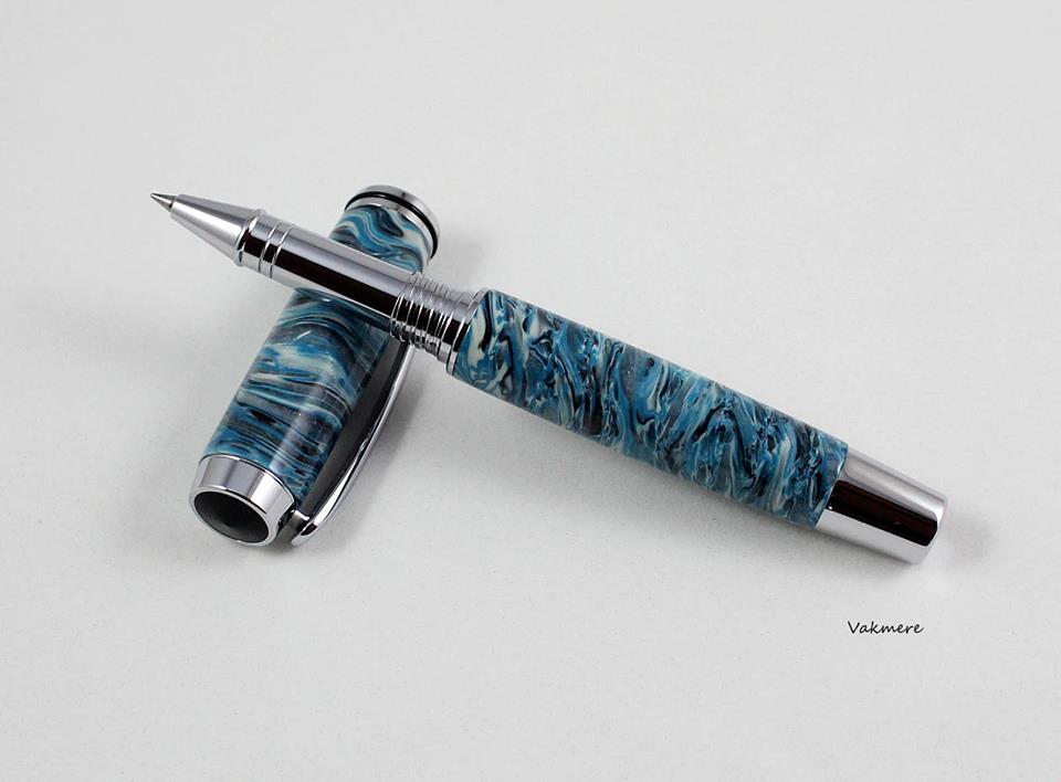

So many creative and art worthy pens on this site this may pale in comparison however it was fun twirling around different colors of poly-clay, wrapping it around a tube and not have it fly off. Looks like oceanic storms. Enjoy.......:musical-note:

That's an interesting technique. I'm assuming you fire the clay and then turn it? Or do you just use abrasives to achieve the final shape and finish? Well done!
-John

I first rolled the clay up in a thin snake likeshape and wrap it around the tube. I bake it at 280 degrees for half an hour. I turn some of it down on the lathe and then sand the rest of the way. Several apps of CA.
Very nice result ... congratulations !!! . I need to try this ... do you give lessons ? :smile::smile::smile:
