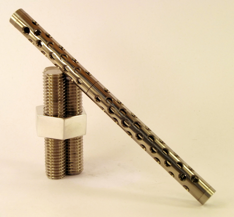

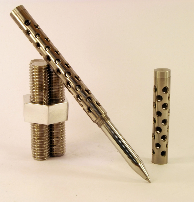

Could this be the first pen posted on IAP this year??:biggrin:
Basic, clipless pen with Titanium barrels, stainless other bits and a Schmidt 5888 roller refill as it has a metal body.

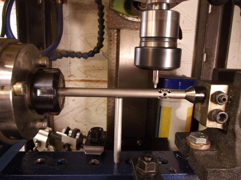

Drilled all the holes on the mill with a centre drill. Used a piece of aluminium tube as a support to stop the Ti flexing so I could ensure good pressure on the drill. Going to make a screw jack this year...:wink:
Had to put it back on the mill to add more holes.....measure twice cut once...:rolleyes:
Can't decide if it needs the 'gas torch' effect? Waddaya reckon?:confused:

Yup, I would say yours is the first for 2017 !!!! . Better apply for your prize for that !!
Lovely work, Steve !!!! . I would say leave it uncoloured. . Make another and colour the second one.
Where do you get the titanium ? ... and is it expensive ?? ... hard to work ?

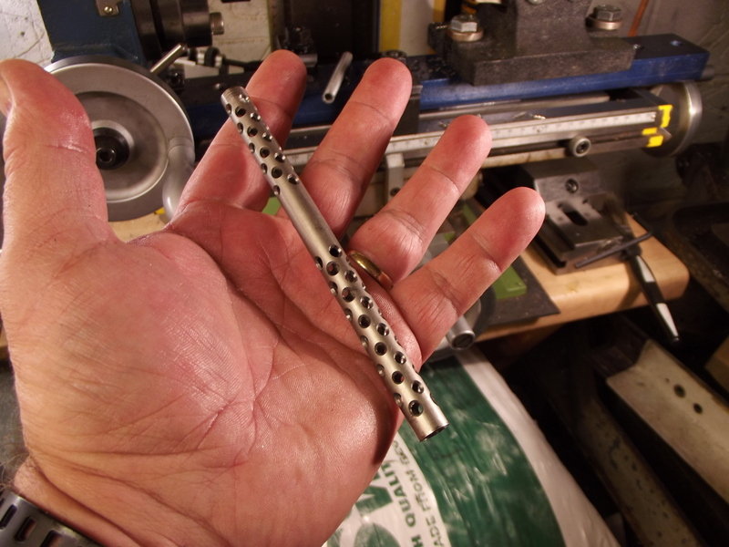

Oh my... either that is a very small pen, or you have very large hands.:eek:
It looks a lot like a rifle barrel I've seen. I like it they way it is.
:biggrin: John it is fairly small but I do also have pretty big hands too...
It's 10mm diameter and 145mm long capped and a shade under 30grams

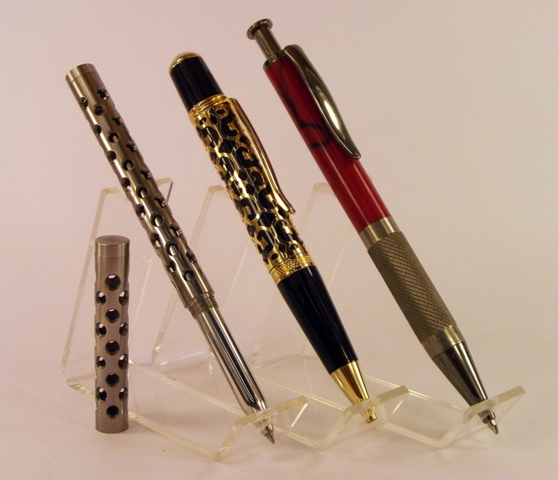

Here's a comparison pic... This pen, a Filigree Sierra, and my daily user, a long clicker with a Ti knurled grip and my own resin mix.

Beautiful Pen, Steven.
Great Concept, and Execution.
Excellent Proportions,
Superb Machining.
I am joining the Each Way group, I would like to see a second one, Flame Coloured.
I think the Side by Side Comparison would be Spectacular.
I loved your Aluminium "Prop" , Ideal, Simple and Functional.
Congratulations,
Brian.
