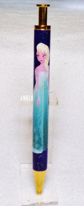

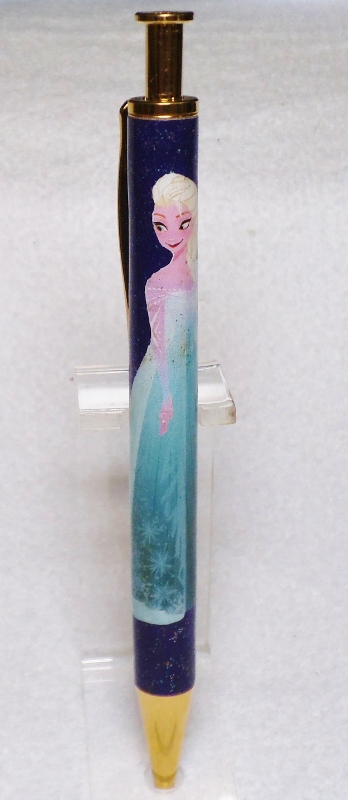

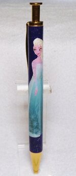

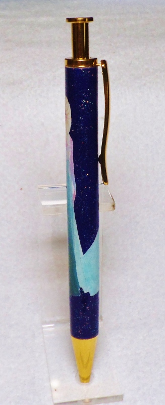

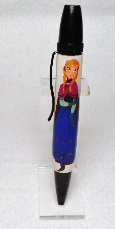

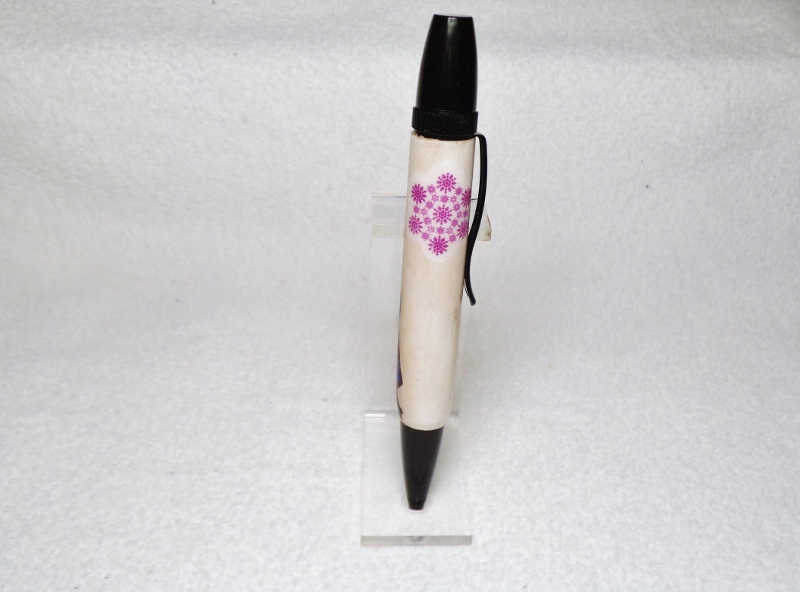

A couple of pens I put together for my 2 four year old Grandaughters over the weekend. First is Anna on a Longwood Click Pen kit in 10K gold from Rockler. The base is a turned Maple blank colored in Dioxazine Purple. Anna was added and iridescent diamond dust covers the purple background, giving it a star filled sky effect. Deco-Podge sealed the transfer sticker and background. 15 coats of thick CA built up the finish. Maple barrel was colored sanded to remove all grain. CA finish was sanded to 600 and One-Step Plastic Polish brought the pen to a shine. White spots in third photo are the stars shining. You need to turn the pen to get the full effect !!
Second is Elsa on a Artisan Patriot Pen kit in Black Chrome from CSUSA. A Maple blank also was the base for this pen. Barrel was coated in Snow White, Elsa added, and again Deco-Podge was used to seal the entire pen. A mauve snowflake was added to the rear of the pen, and 15 coats of thick CA used for the finish. Sanded to 600 and Polished with One-Step. Jim S
