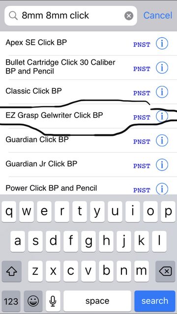

Is she one of those people who sits in a meeting and keeps clicking her pen? Also before you call them you can use the IAP tubes and bushings app. Go to the search bar and type in "8mm 8mm click" or "7mm 7mm click" (without the quotes) and you will get a list of click pens that use an a 7 or 8mm tube in one or both halves. Probably 60 or so show up. As an example...
EZ Grasp Gelwriter

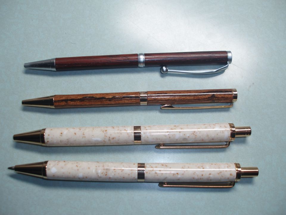

Someone else recently asked about the thinnest pens that take Parker size refills. I suggested a Slimline Pro, which is a click pen. I included a photo showing two Slimline pens (for size comparison) and a Slimline Pro pen and pencil set. See below.
The Slimline Pro gets mixed reviews from others, but I like it a lot. That pen and pencil set in the photo are my everyday favorite set on my desk. It has a firm, clicky-sounding clicker.
