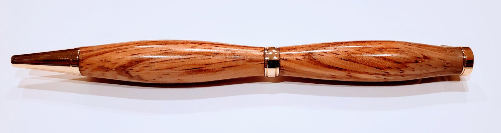

Trying another other one..
Really having issues with getting a good finish...
magpens
Feb 2, 2011
15,913
Canada
What kind of finish are you using ? . And what do you mean by "good" ?
"Good" depends quite a bit on what you are using as a finish, as well as on the quality of the wood surface when you apply the finish.
It also depends on how long you let the applied finish "set" before you go to the next stage ... whether the next stage is another coat of finish ... or whether the next stage is sanding ... or polishing ... or ??? . There are many things to consider.
Also, the more pens you do the more you will learn. . I think we all have trouble at first in achieving what we perceive to be "good".

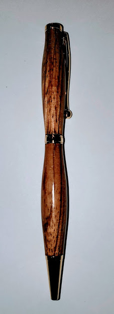

So this is what it ended up as - even after resanding the CA off and wiping down with DA.
First coats of CA went down nice and smooth.. Put 6 applications of Med CA, letting each naturally dry in between.
MicroMeshed, wipe down between each pad and put some Renaissance wax.... What am i doing wrong?
Normally I would get aggravated but its just wood and I can turn again.
