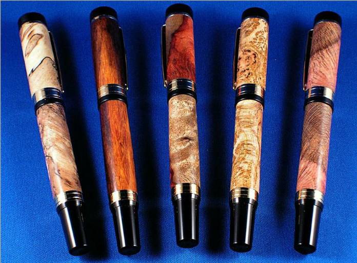

Has anybody tried using a coat of friction lacquer as the final step of a CA finish? In other words, do all the steps you would do to get a good CA finish, and then burn a final coat of friction lacquer on. It sure brings up a very high gloss, and seems to be hard as a rock. No clue though as to longevity.

I actually asked about using lacquer, not shellac. I had already tried shellac and Krystal Coat, and found both to be too soft. I think the heat from the friction may help the lacquer bond to the CA. I just made 5 El Grande pens using this process. They ranged from Spalted Maple to Desert Ironwood, (even did a Juniper one), and I thought they all came out well.

BTW, OGraywolf, those are somre real beauties!
