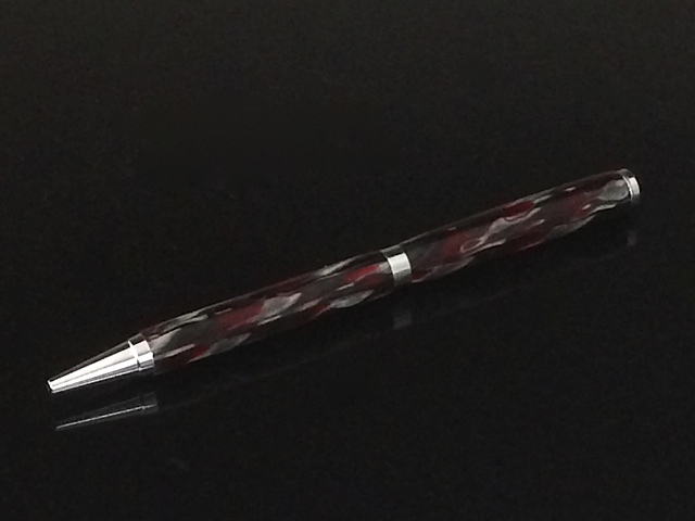

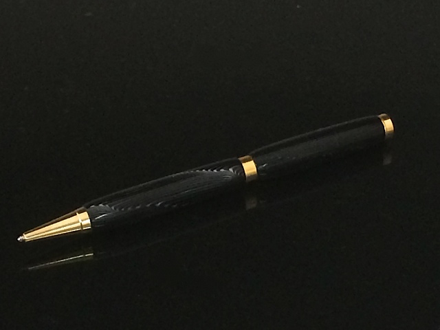

After seeing some of the posts of pens made with Galalith, I found some vintage French Galalith (1920's era) on eBay. Drilling at slow speeds with a sharp drill produced a strange smell, as well as smoke when the drill bit was withdrawn (I drilled on the lathe and kept spraying water so it wouldn't overheat or crack).
The first one is a silver marbled black Galalith, while the second one is a multi-colored marbled blank.
C & C welcome.

Pens are very hard to see !! Suggest using a lighter background to bring out the detail of the pens. Pens look very nice. Jim S

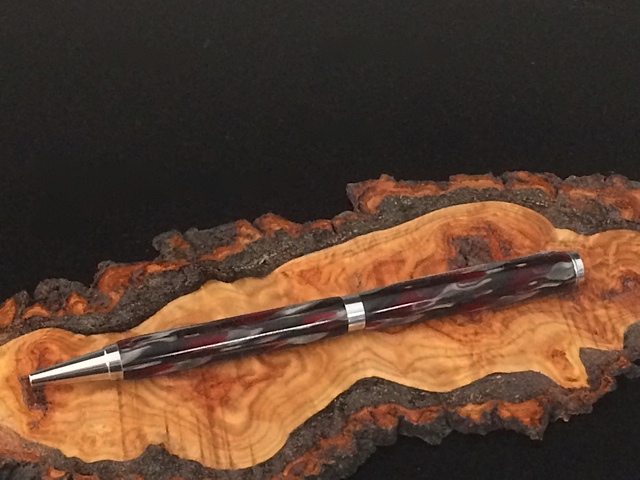

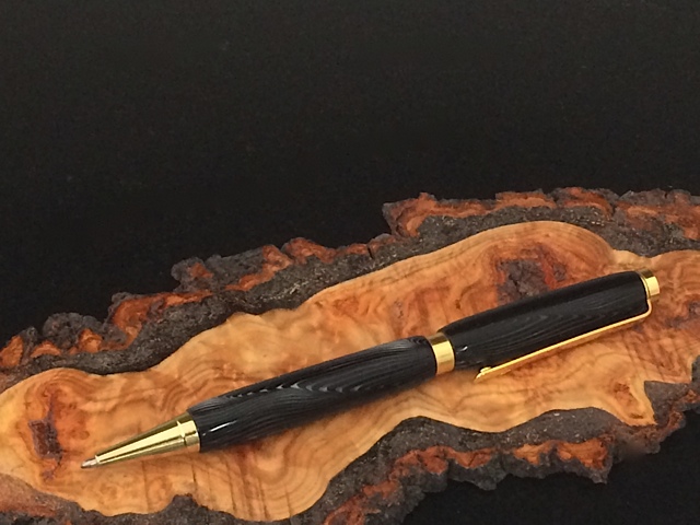

Ok, I think :big grin: In response to the "too dark" comments, I'll try to repost them on a lighter background. Hope this helps.
Thanks, all.

Much better !! They realy look nice on that piece of lighter wood. Jim S
Galalith is just another name for Casein that was stabilized with formaldehyde, it is still hydrophilic, meaning it will expand and contract with the humidity in the air.
Thanks, everyone. Richard, thanks for that bit of info. That may be part of the smell I noticed.
