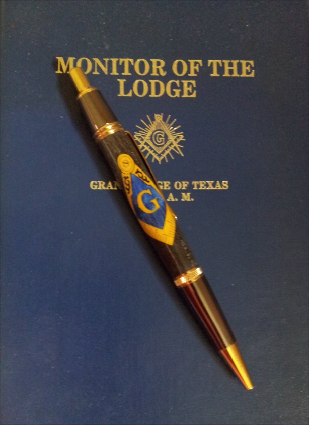

I just got in the Mason inlay kit from Wood-N-Whimsies. I have enough experience with inlays to tell this one is going to be easy. It has a deep blue background and the square and compass are yellow so it really pops. It has the G also. I showed a picture of it to a Mason and it immediately sold. Now I just have to make it.
I agree with Sabaharr - I like the black barrel the best. This one comes from Lazerlinez but you might be able to find it in your local Woodcraft (that's where my son got this one) since they carry some of the Lazerlinez inlay kits. And, my second choice would be the blue barrel one from Wood-N-Whimsies - haven't done one of those yet but it sure looks good.
One thing to watch out for on the one from Lazerlinez is the scroll work on the upper legs of the compasses can break if you're not really careful. I think it is a little safer to mix up a dab of epoxy with a drop of black acrylic paint and fill in the scroll work using a toothpick after you glue in the tube before you try to sand it. But, maybe I'm just a klutz with delicate things like that and nobody else would have a problem if they didn't do that. :redface:
This is a poor picture of the one my son made me for my birthday last year.
I made a bunch of the Laserlinz masonic pens for my year in the East. A pen for each of the officers. The trick was that you need to break and reglue the Blue to get the Gold G to seat. Black epoxy worked well to "top dress" the blank before turning. Also used a magic marker to color the tube -- just in case.

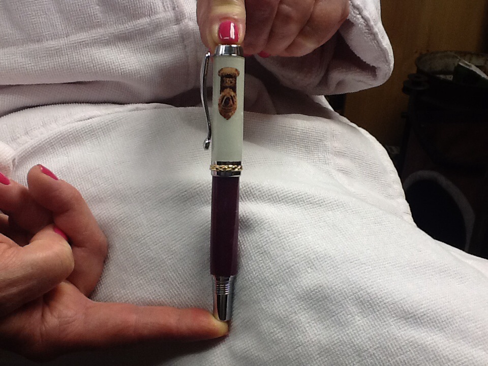

I made this one for the DD that raised my son.
He raise me 5yrs ago and my son last spring.
That is his DD Jewel and GL colors. Sorry it is not a great pic.
