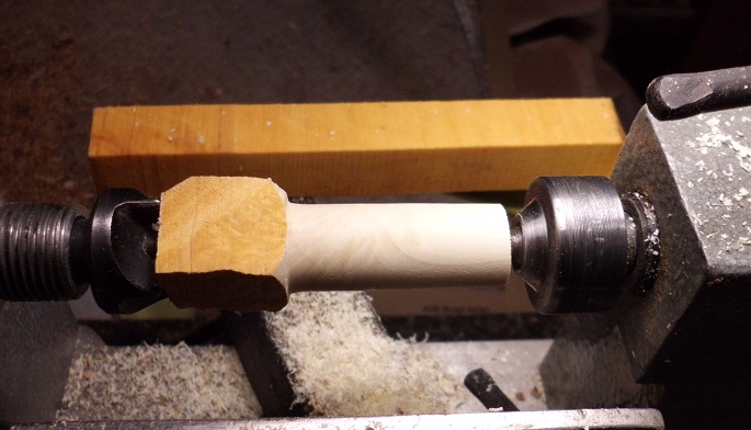

So yeah, I got me some free wood. I am not sure what species it is, but the guys from the tree cutting service mentioned taking down a large sycamore with orange/reddish wood ... They had some decent sized branches in the back of a truck that they let me have, as I wasn't interested in the large trunk pieces (way too big for me to process).

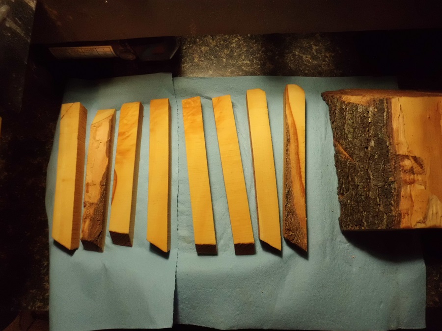

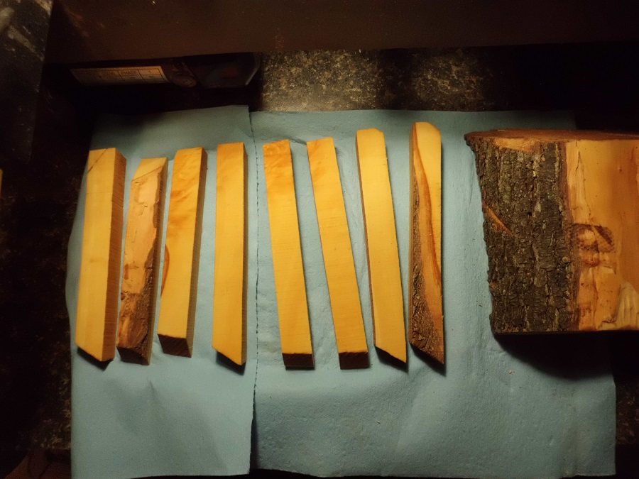

So ... as I was cutting a piece into roughly 1" square pen blank sizes to stack and dry (it's fresh cut), I noticed that the interior was a creamy off-white color. After drying on a blue shop towel for a half hour, the pieces are now a nice looking orange. I have the other half of this chunk laying to the right, so you can see the bark. It would also appear that anywhere it has made contact with iron has turned a rusty reddish color ...
What is this species?

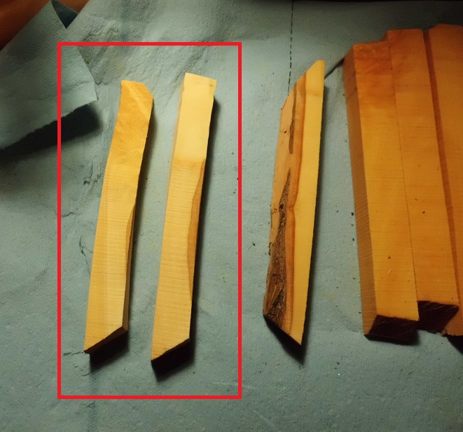

Anyways, cant turn wet wood and expect it to stay reasonably stable (at least for my purposes), so the wood that's not out in the pile slowly seasoning is getting the ultra-modern treatment. I took the two blandest looking blanks I've cut and used them for my test drying ... decided to microwave kiln dry them a few at a time. I found that 6 minutes was WAY too long (at 50% power, by the way), and ended up with a pair of charred blanks that were pretty much unusable. I dialed it back to 4 and a half minutes and ended up going from 48% moisture content (using this Harbor Freight moisture meter) down to 11% .... good enough for me. There was some warping, but with these rough cut 1" blanks, that's not a big deal.
I got about 6 branches around 4 - 6 inches thick, roughly 3 - 4 feet long, plus this chunk I was working on in the house ... perhaps 10 inches long, 8 inches across, but both ends were cut at a diagonal...
I chainsawed it down the middle so I could fit it on my band saw in halves for processing into blanks. (still have the other half in one whole piece for now)
I'll leave the rest of it out in the wood pile till late August to October, and then check the moisture before I process the rest and stick it in a shoebox... I plan on bottle stopper blanks, some small bowl/box blanks, and the rest pen blanks.
(edit concerning the charred blanks) The smoke was extremely acrid ... it was burning my throat, my lungs, and my eyes... There was no open flame (smothered in the plastic bag full of moisture), but 80% of the wood was unusable. Of the rest, the center was more charred than the outside. I tried turning it round, but it split down the sides. It did have an interesting look to it. For those that are interested to know, the Harbor Freight brand of Western Safety "Multi-Purpose Dust Mask" was awesome ... quick and easy to put on with the velcro strapping. I just had to grit my teeth and bear it with the tear-inducing smoke as I got the charred blanks into the sink.

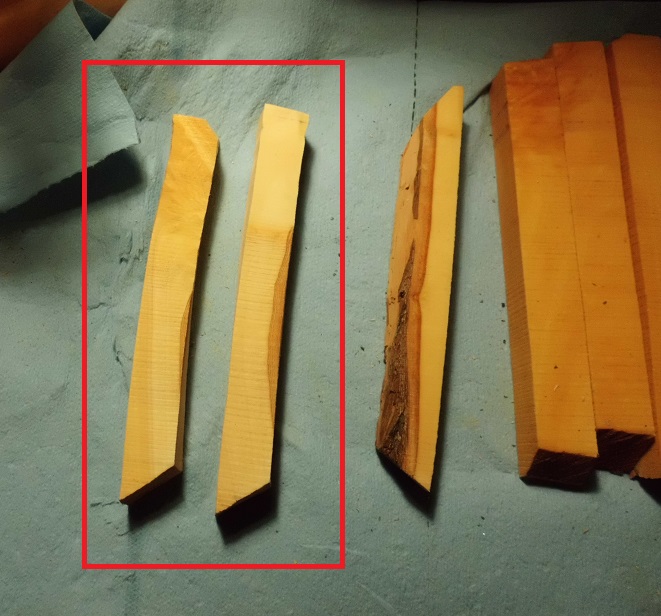

In the red box on the left is the microwave kiln-dried pen blanks. They are about 7 - 8 inches long. On the right are the un-dried blanks. You can see the curvature of warping apparent in the left-most blank.

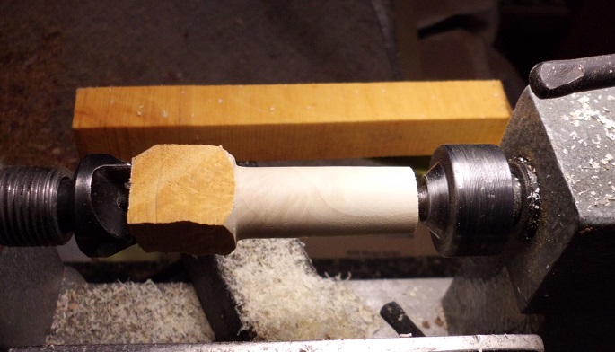

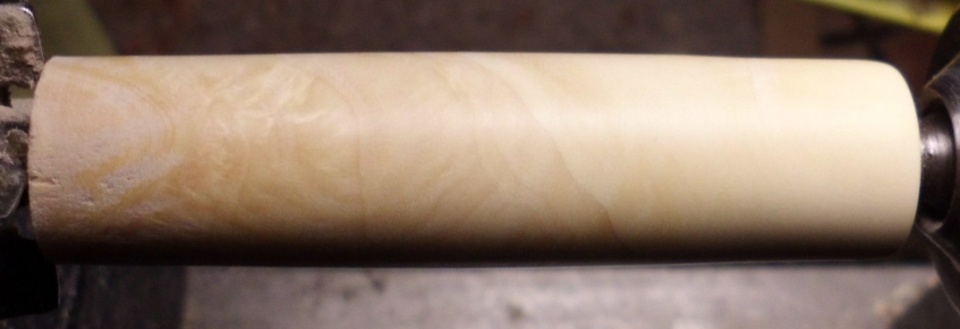

Next, on the lathe ... you can see here what I mean by "creamy-off-white" for the freshly cut wood. In the background balanced across the end of the banjo and the tailstock handle is one of the wet blanks for comparison ...

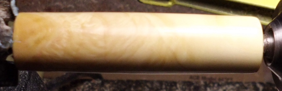

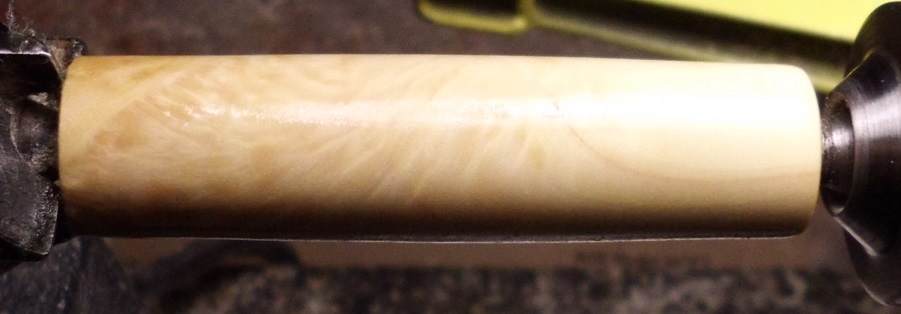

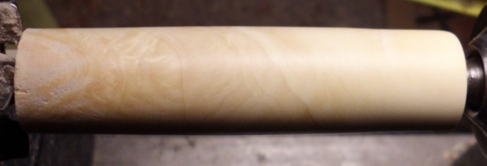

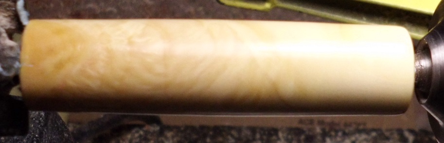

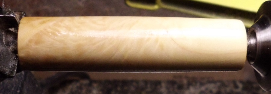

And for those who want a nice close-up look, I've left 3 photos below for you to click and blow up ... Left-most is sanded to 400 grit abranet. Center is with BLO and 2 coats of CA. Right-most is with a tiny bit of sanding to level things out at 3200 grit micro-mesh and then I hit it twice with Plast-X to see a polished shine.
