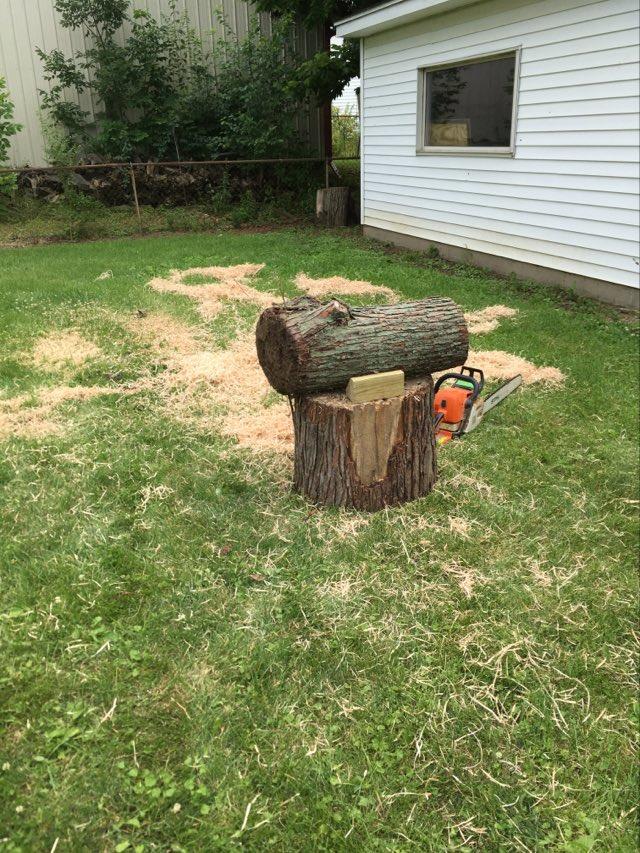

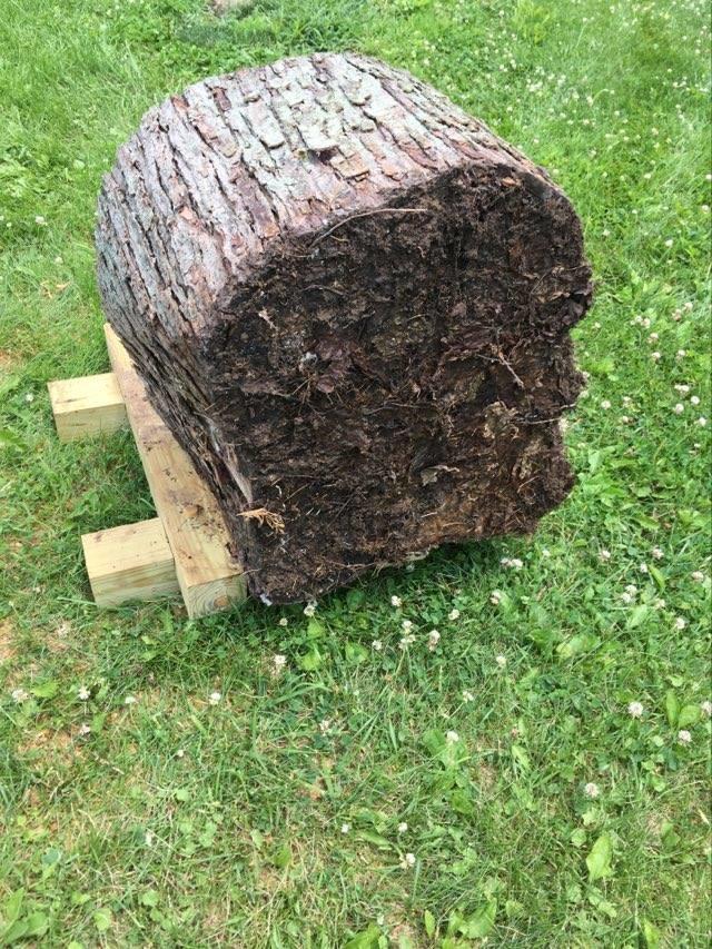

I will use a saddle buck, 3rd picture, when I cannot lift a log up on a stump. When I can lift it up, I'll use 45 degree wedge blocks to hold the log I'm cutting still. I have a designed sawbuck for woodturners where you can rip and cross cut. But this method is so much easier. There is a video out there where I learned this technique. I'll try to hunt it down for you.
