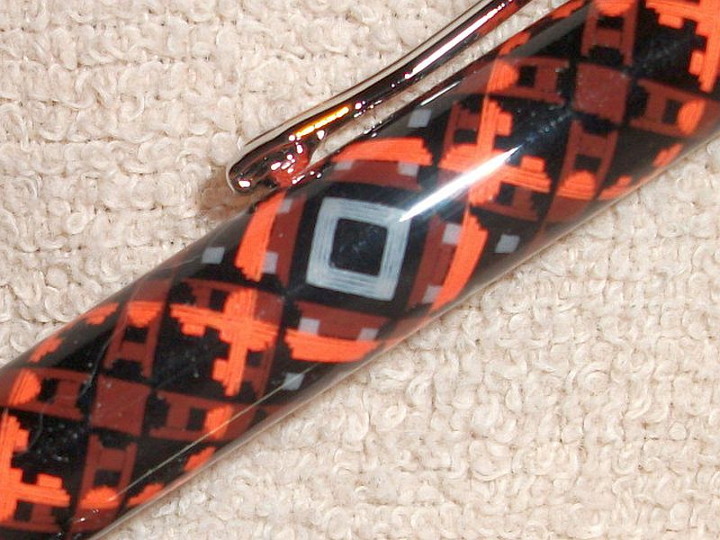

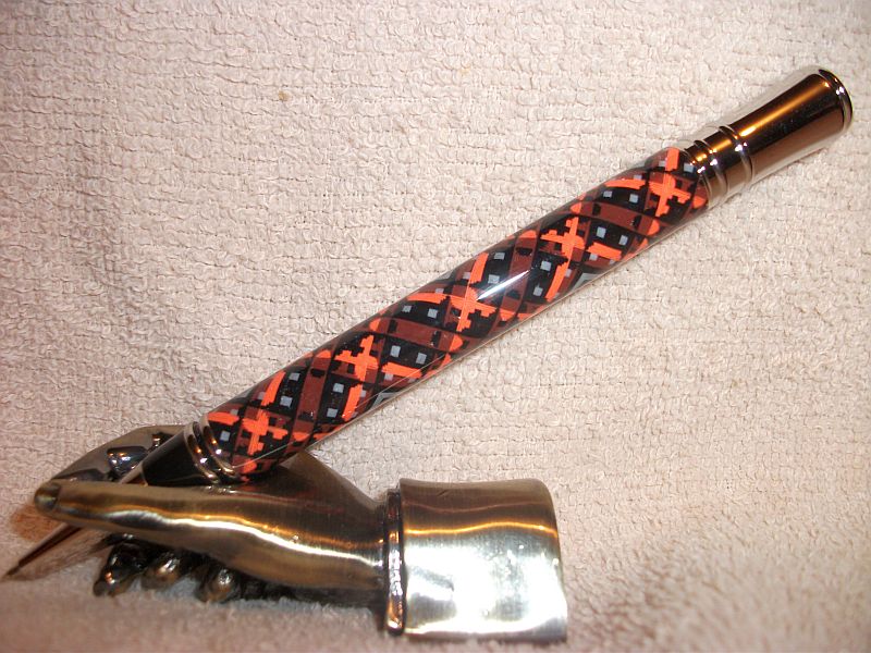

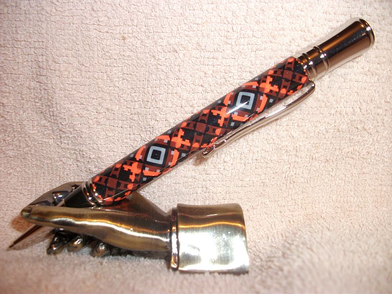

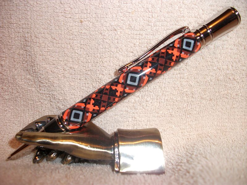

Did another wrap on another executive.This one is called Fragment. I used black and light gray nylon ncp rod crafters thread from korea, florescent orange and light brown fuji ultrapoly nocp from japan.Had big troubles with this one building the clearcoat.Got it all built up,cut back ,sanded and polished,then found a pit,an air pocket,also some debris got in there during the coating.Upset about that I was and tossed it aside.Well I got over it and decided since it was already messed up I might as well cut the finish back down to the threads and try again just to see what happens. Here's the result, I think it worked out in the end.

Thanks turners for the kind words and feedback.I really didn't think it would turn out well cutting the finish back,because I didn't know where the air pocket was.Learned I got a little more leeway than I thought.
Not sure about posting the close up pics to show the threads better.Last one had some lint trapped under the clip.This one has a hair on it.Damn it
