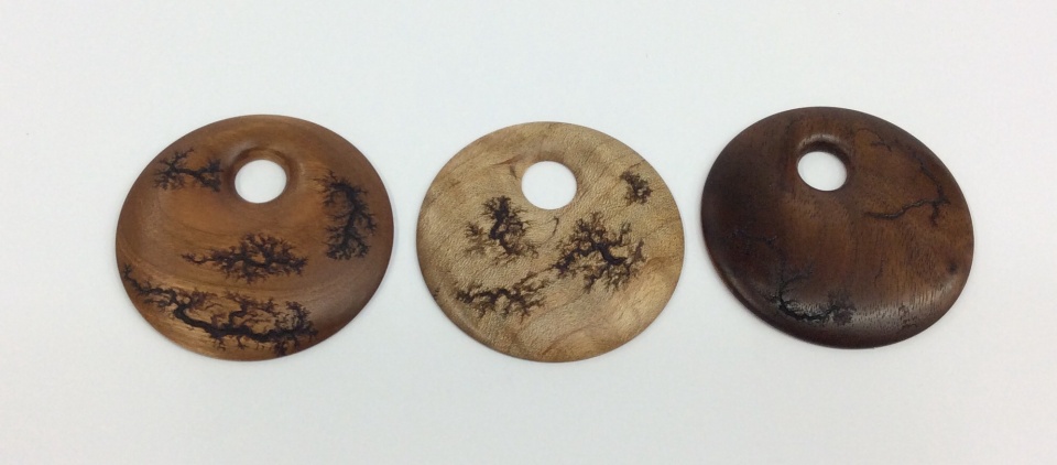

I found these pendants I had done earlier this year...added finish and buffed.
They are Cherry, Maple and Walnut. The burning worked fine on these without showing through.
