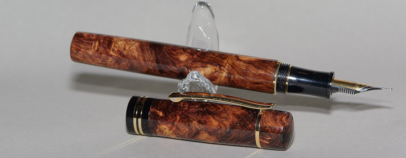

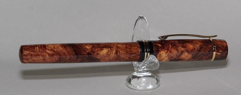

Thanks -- one that I like even better is this "modified Churchill" dressed up in Cocobolo burl.
