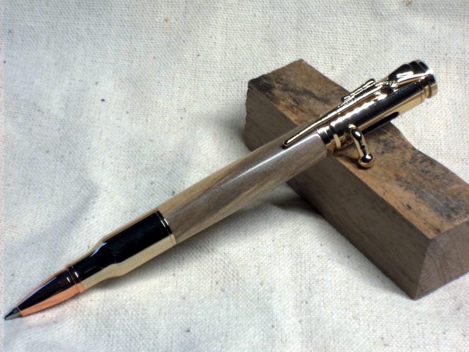

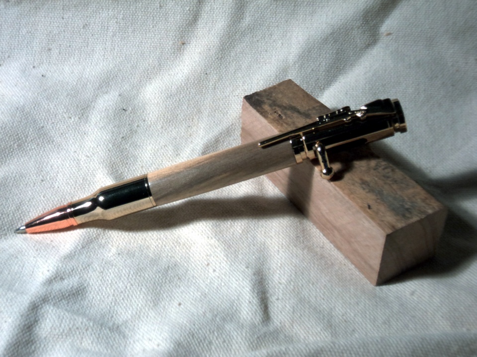

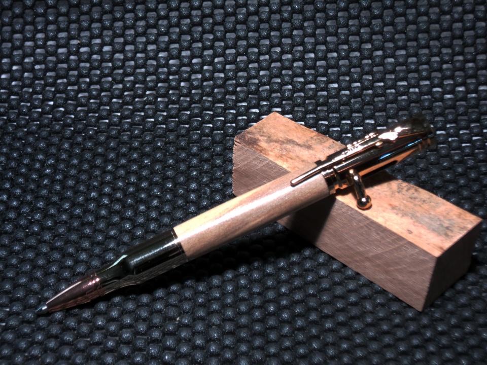

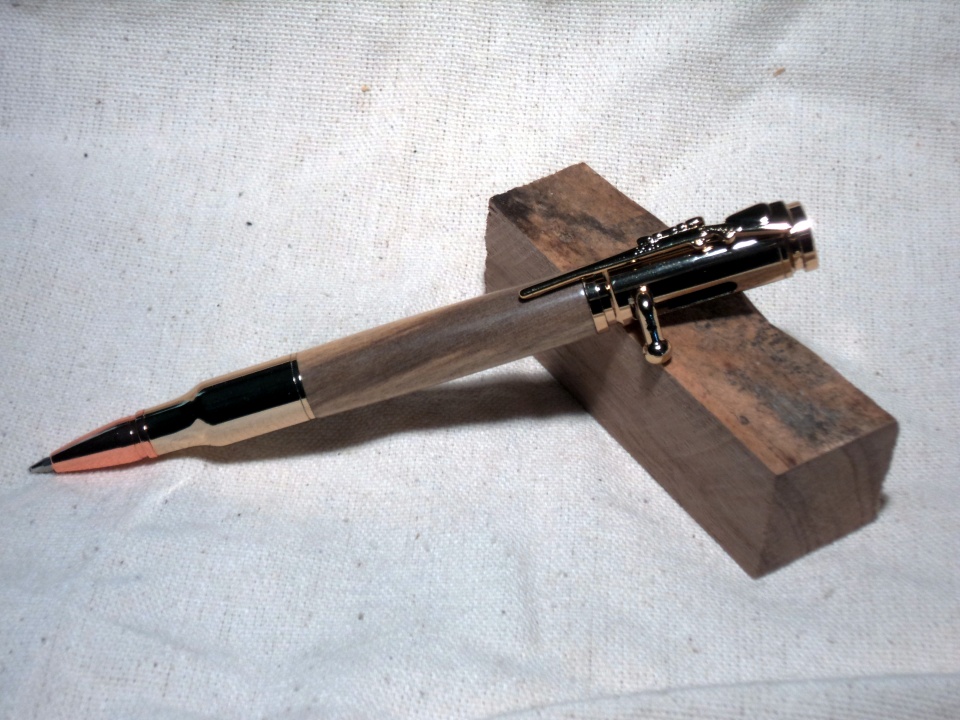

four for your comments please.
GDGeorge
Apr 2, 2010
192
Bowie, MD
Here are four of the same shot. It's a bolt action in gum with gold hardware. "A" was shot under an LED. "B" and "C" were shot under an incandescent, and "D" was shot on a different background. All were bracketed +1, 0, -1; processed with Picturenaut, and then process through the GIMP white balance filter and saved as JPG.
Each one has major loss of details on the pen, the right edge and some of the left edge is out of focus, blown out lighting in select areas from over processing and hard lighting, lastly more detail from the background is picked up than the pen itself.
I know that lighting can clean much of this up but the really confusing part is why the bracketing, that seems to be a major source of serious data loss in the image. Not just here but in just about every image that I see using that method.
