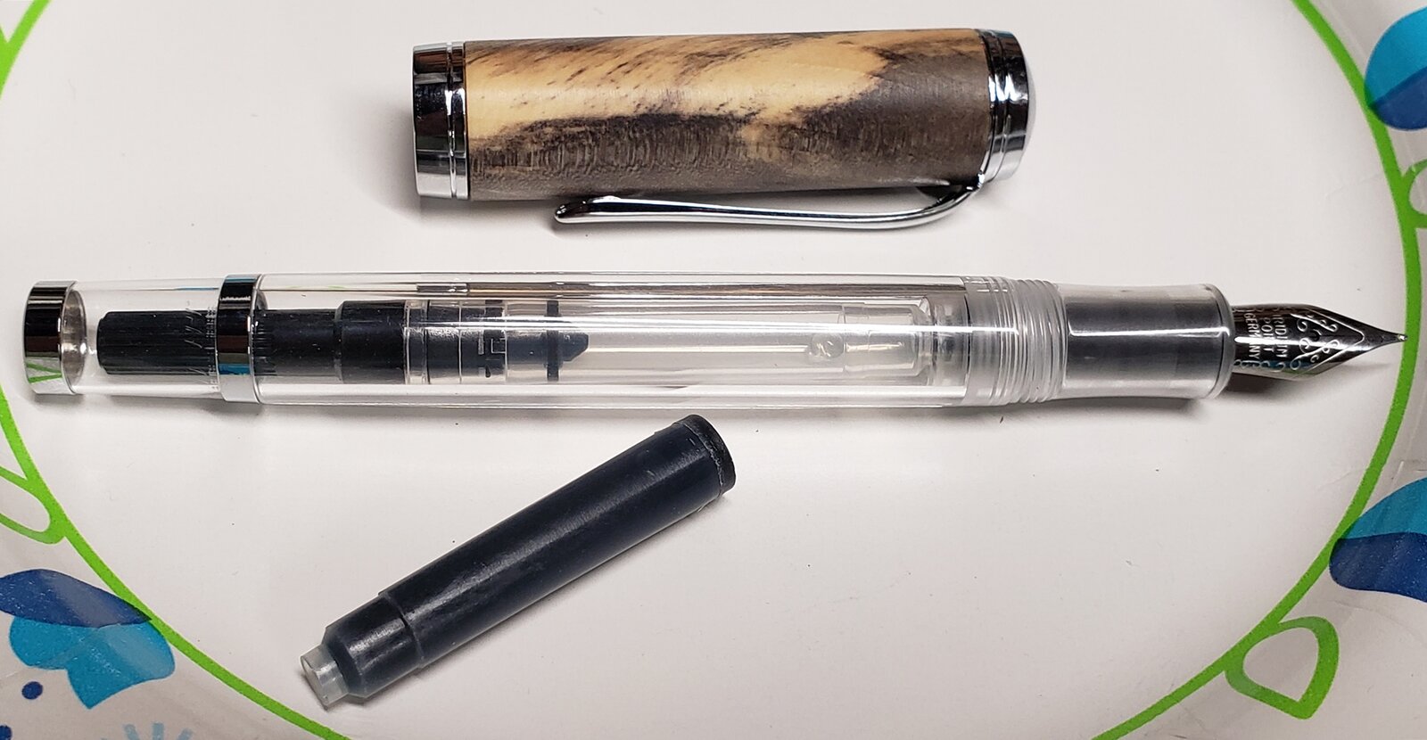

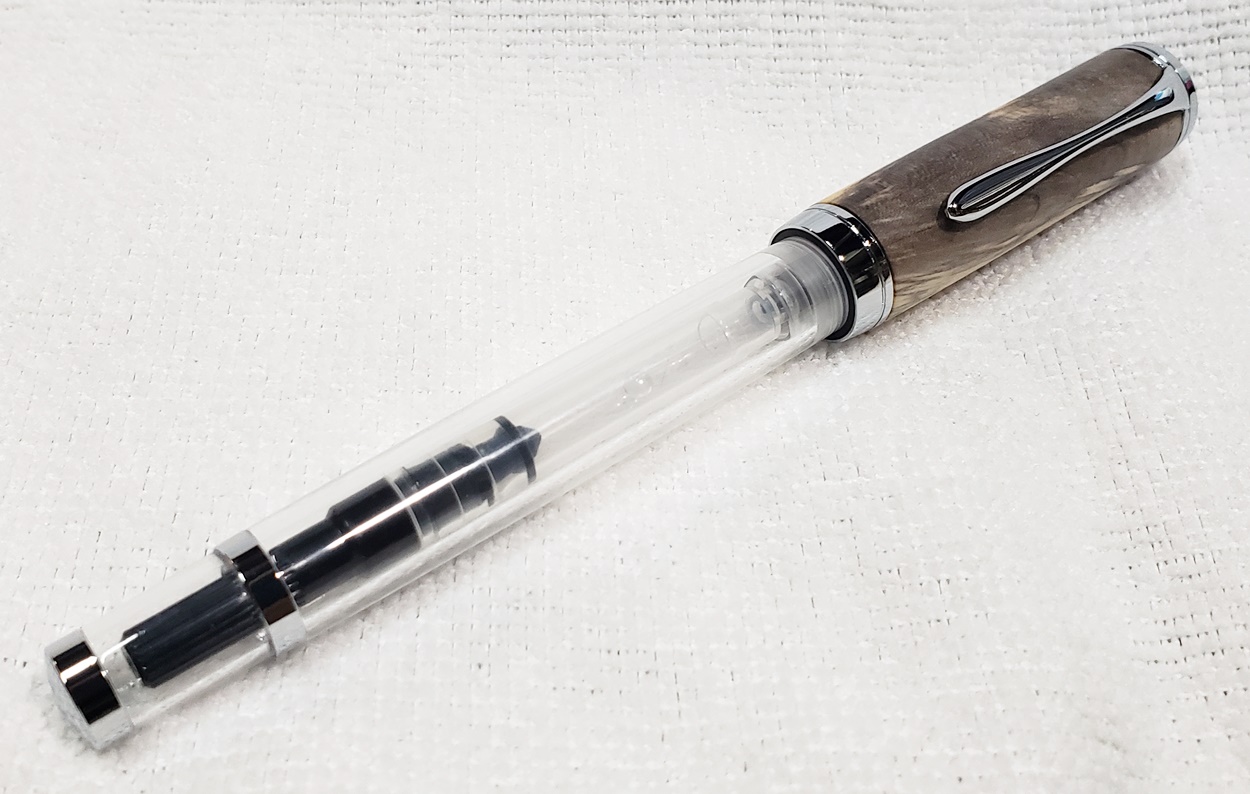

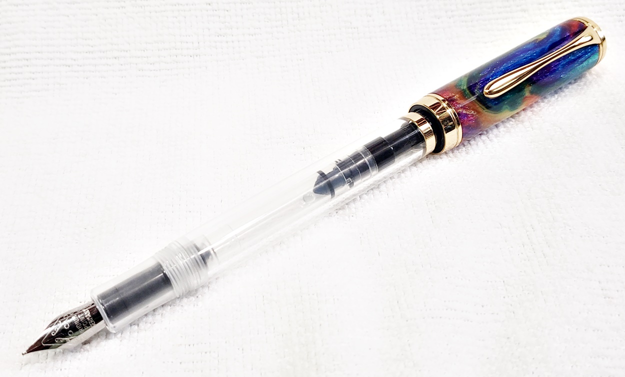

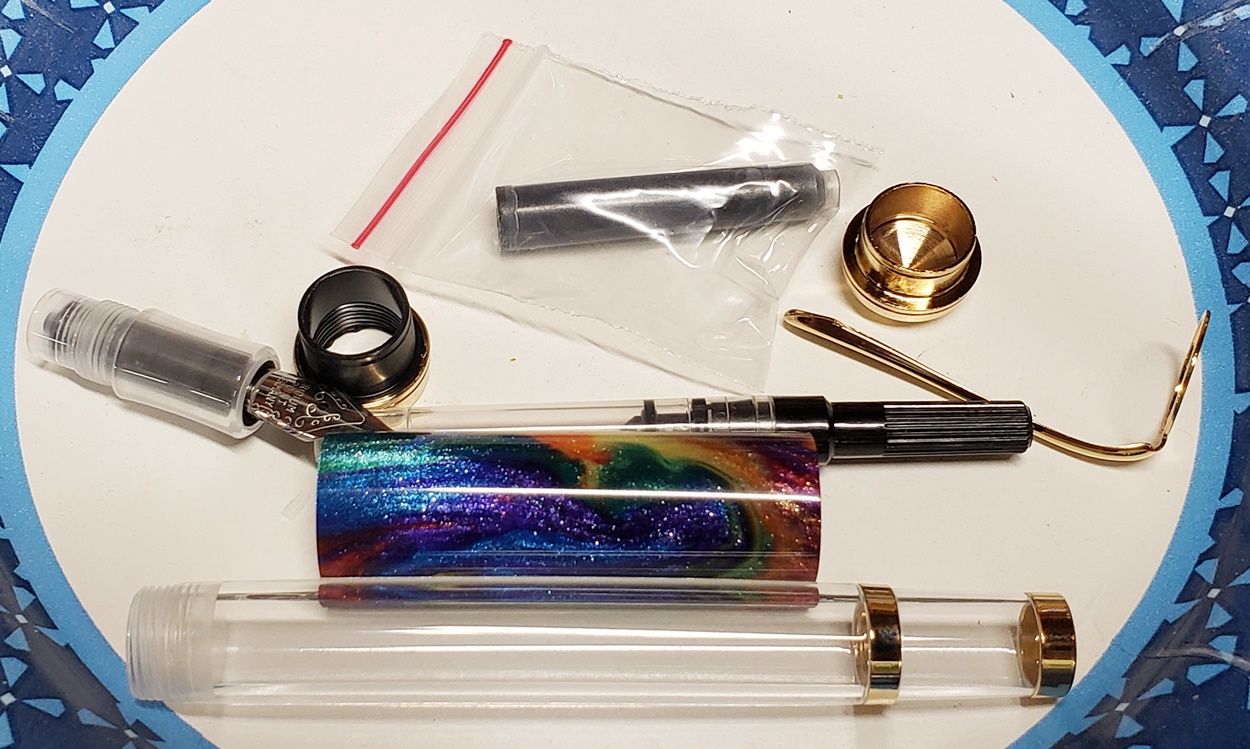

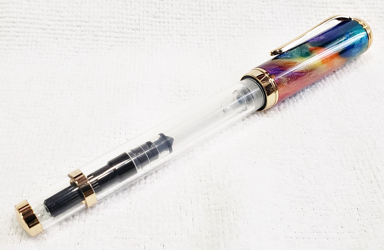

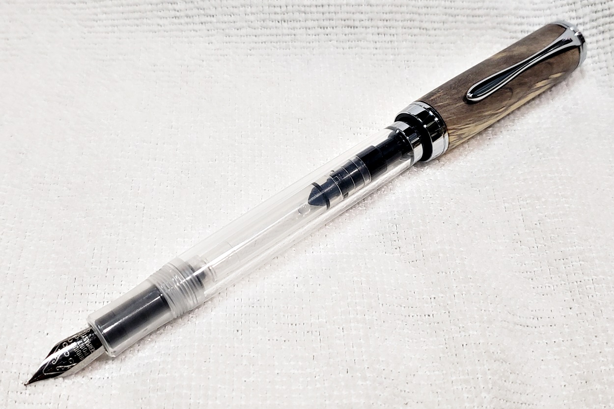

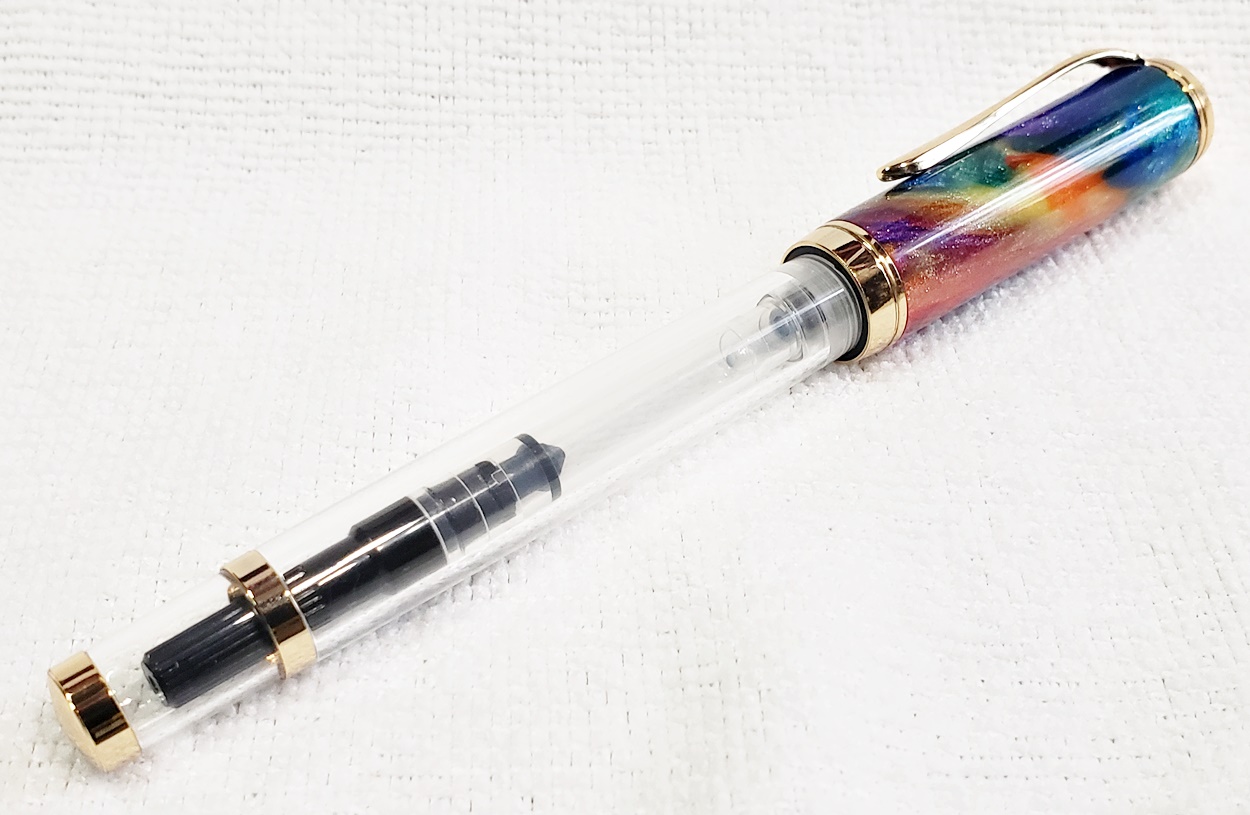

I recently made two of the Clarion Demonstrator fountain pens, which are a lot of fun. One was buckeye, and the other was Diamondcast Oil Slick. I gave the Oil Slick to a friend who is a journalist (not a reporter) and a fountain pen aficionado. She has several high end, very expensive fountain pens, and yet she loves to write with this one. They come with both a converter (ink pump) and disposable ink cartridge. Plus, you only have to turn one body.
