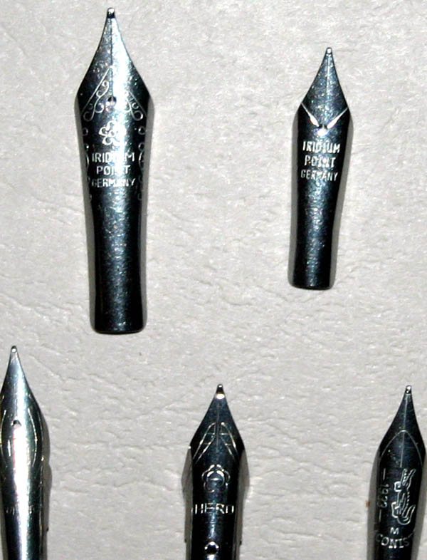

I generally do not like to post multiple comments to a thread, but this one is an exception. Nibs, like paper or the internet, will sit there and let you write anything you want on them.
Here are some Chinese-manufacture steel nibs. How do I know? I solicited 10 different nib manufacturers in Hong Kong, Taiwan, Mainland China, Argentina, German, Great Britain and Italy over the past seven months as I have decided to stock nibs. These nibs were sent to me from China via DHL International. Check them out yourself.
<br />
This is not offered as proof that CS USA or any of our suppliers use nibs like this, but they are out there by the hundreds of thousands. Somebody is obviously using them for something. [8D]
