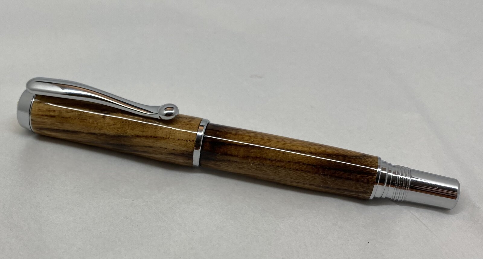

Had a customer bring me an old broken chair. Said it came from his wife's Grandmother's dining room. Wanted to know what I could make with it. So far, a money clip (another thread in "Other Things"), a frame, and this Triton fountain. I thought the wood was pine, but it is kinda hard and not gummy. This is my first time using a torch to get the grain to stand out. Comments and critiques welcome.

so I remember years ago (I haven't made many pens in the past 6 years) people were doing this. I don't remember the exact process they used, but here is what I did:
1. turned a piece round and sanded to 220.
2. used torch while blank was on the lathe and that allows me to turn the blank like a spit.
3. adjust distance to blank by how quickly blank chars.
4. Sand to 400 and finish.
Notes: the part of the blank that is closest to the lathe bed will get more char if you it it with the flame from the side (like where the tool rest is). I got a better result hitting it from a downward angle. YMMV.
If you overcook it, sanding can knock the color back.
Not sure on best woods. This was my first time. You could always try it on a thick blank and turn off if you don't like it.

That torch really did bring the grain out nicely. I tried this once on a magic wand made from a piece of plain oak. It was done with a propane torch and I recall it was really easy to overdo it. The softer growth rings darkened up really fast for me. For whatever reason, older wood seems to have tighter grain, which I'd guess would give more consistent results.
Wow, that torching technique really does make the wood look unique. The wood is beautiful. Was it lighter in color before torching, or is this the original color?
Regarding the pen kit...it looks like the gold band in the cap that is standard with Triton kits is missing. Did you exclude that on purpose? It looks really good with just the chrome band, but at first I was wondering what kit it was, since the gold band was missing.

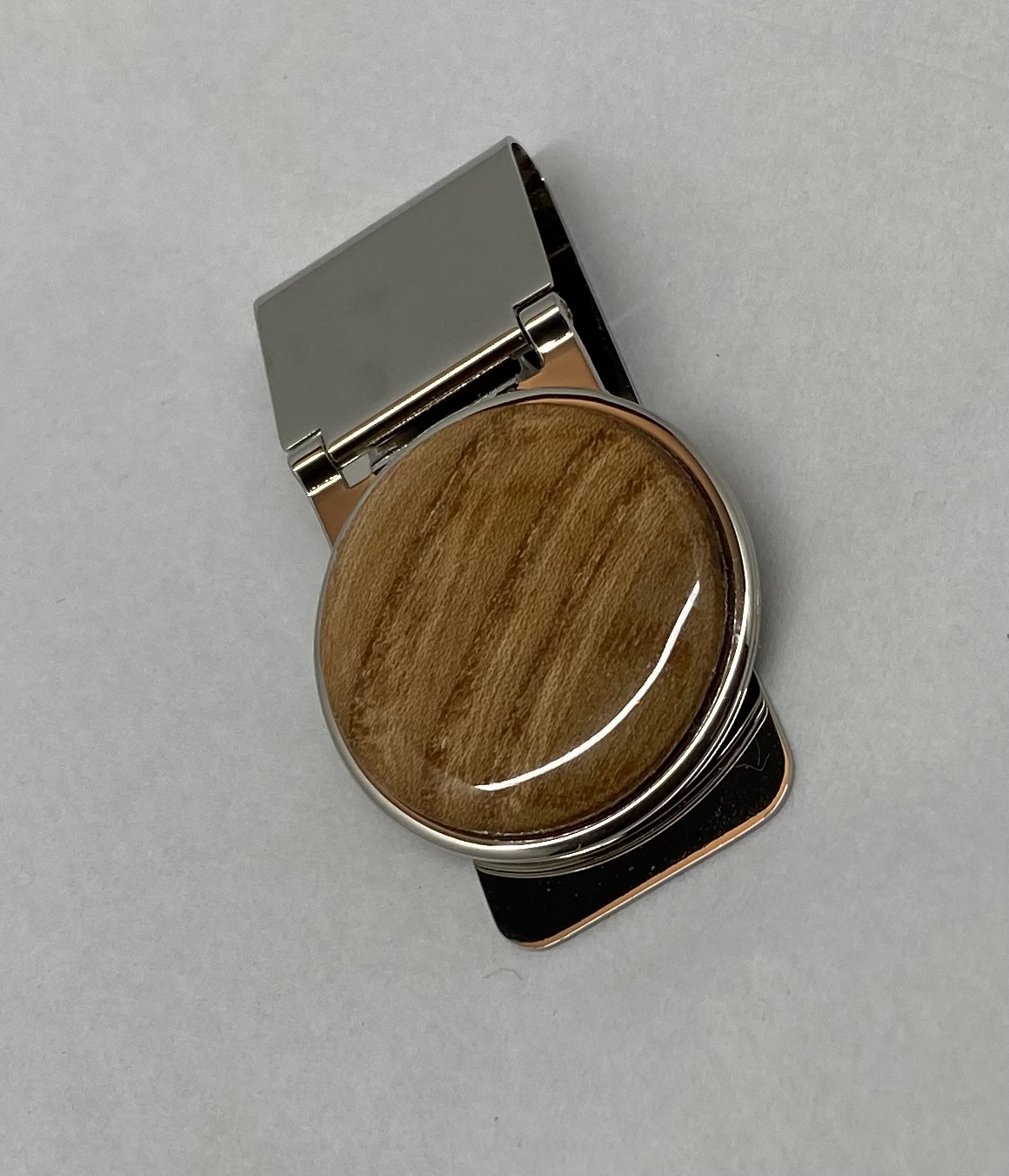

thank you, the clip below is natural. Yes, I did leave the gold and chrome bands off on purpose. That is the way the customer wanted it.
