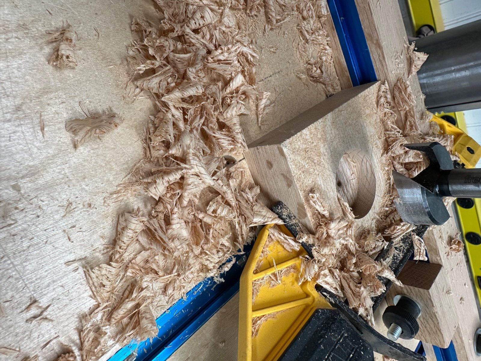

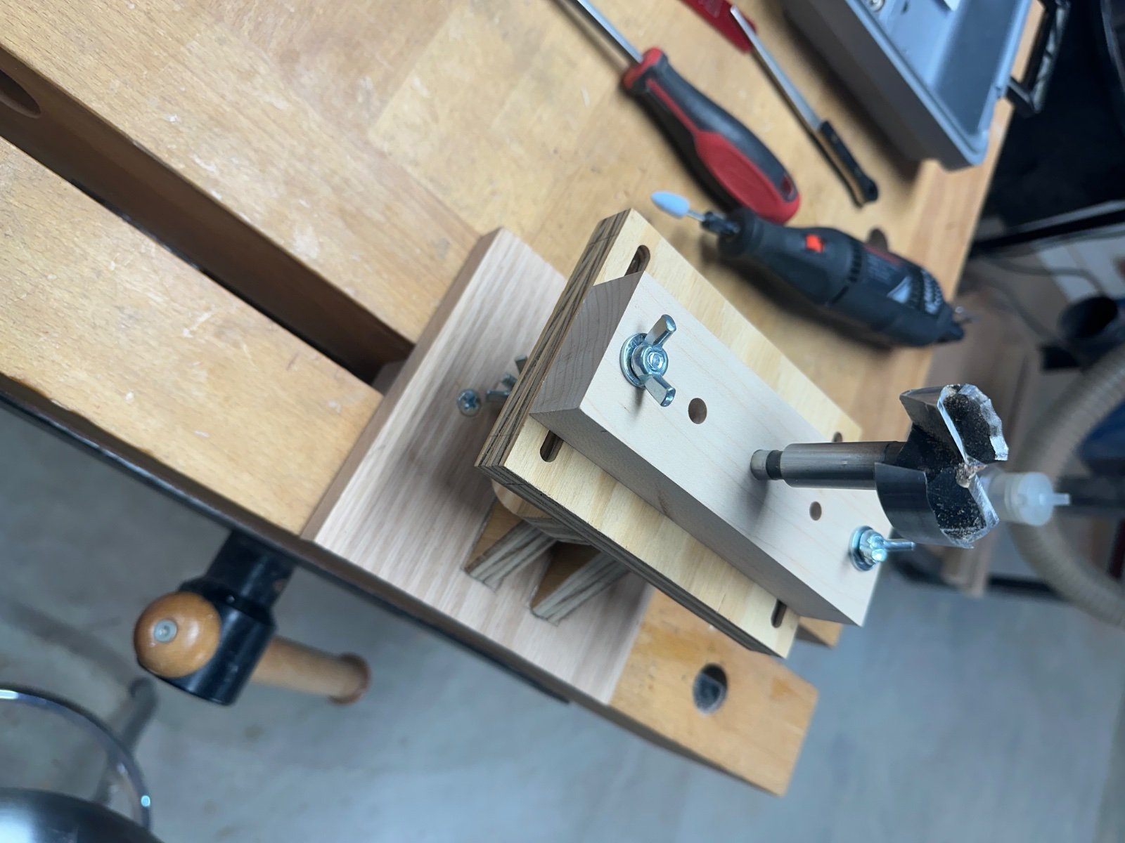

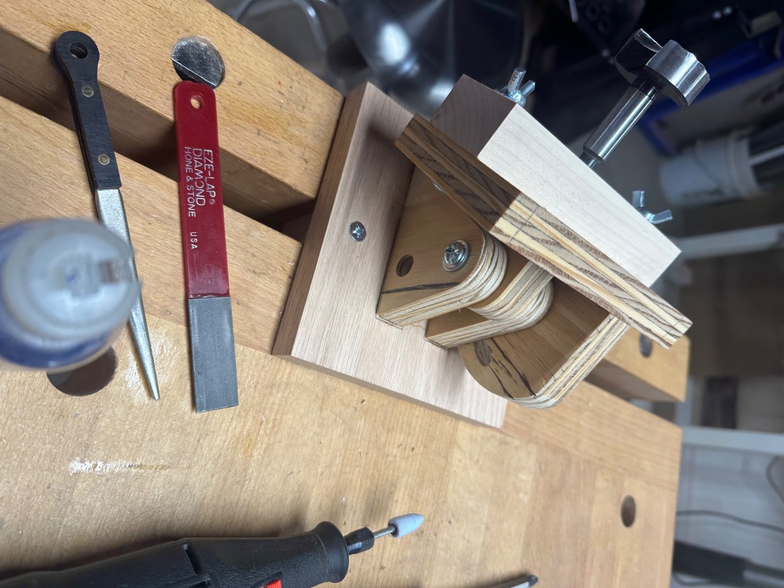

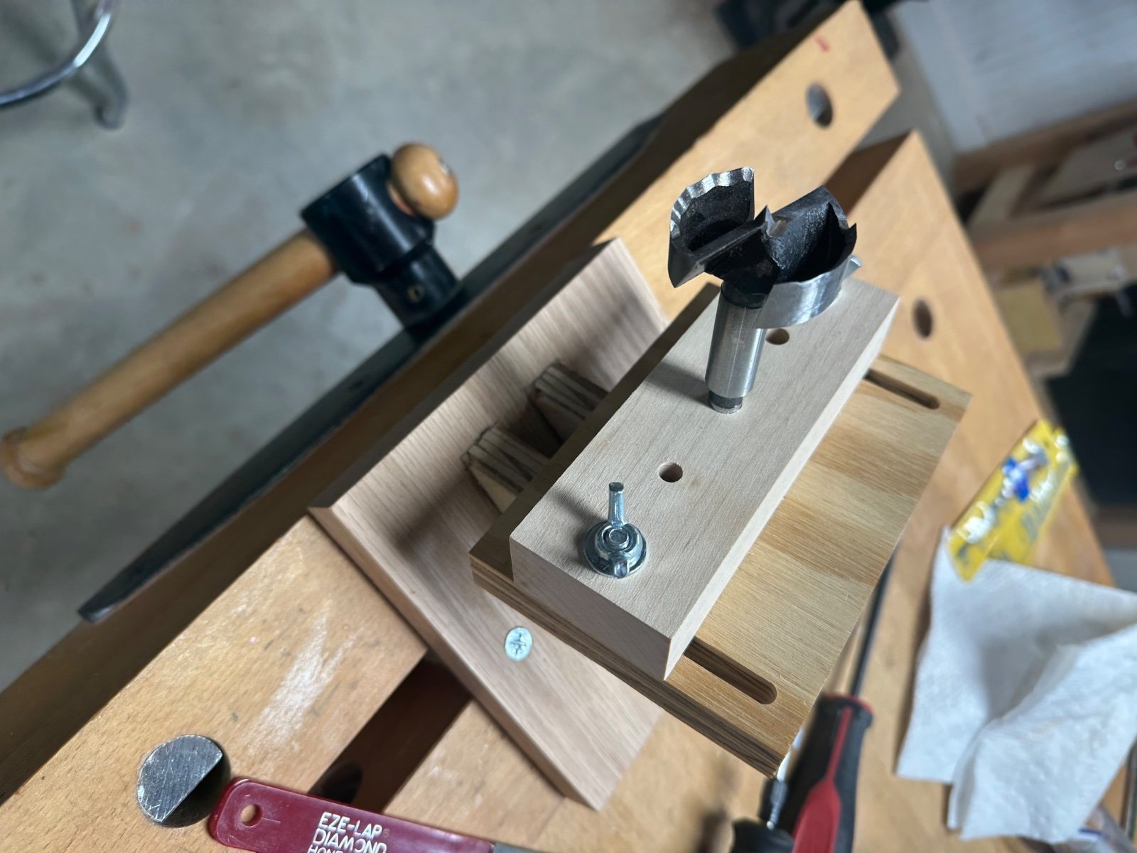

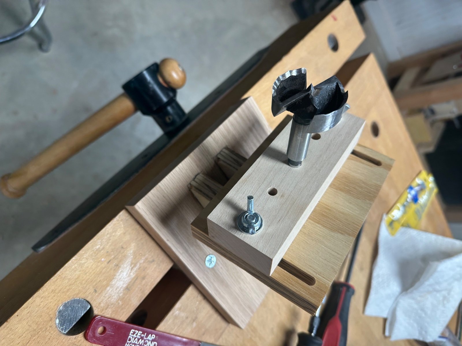

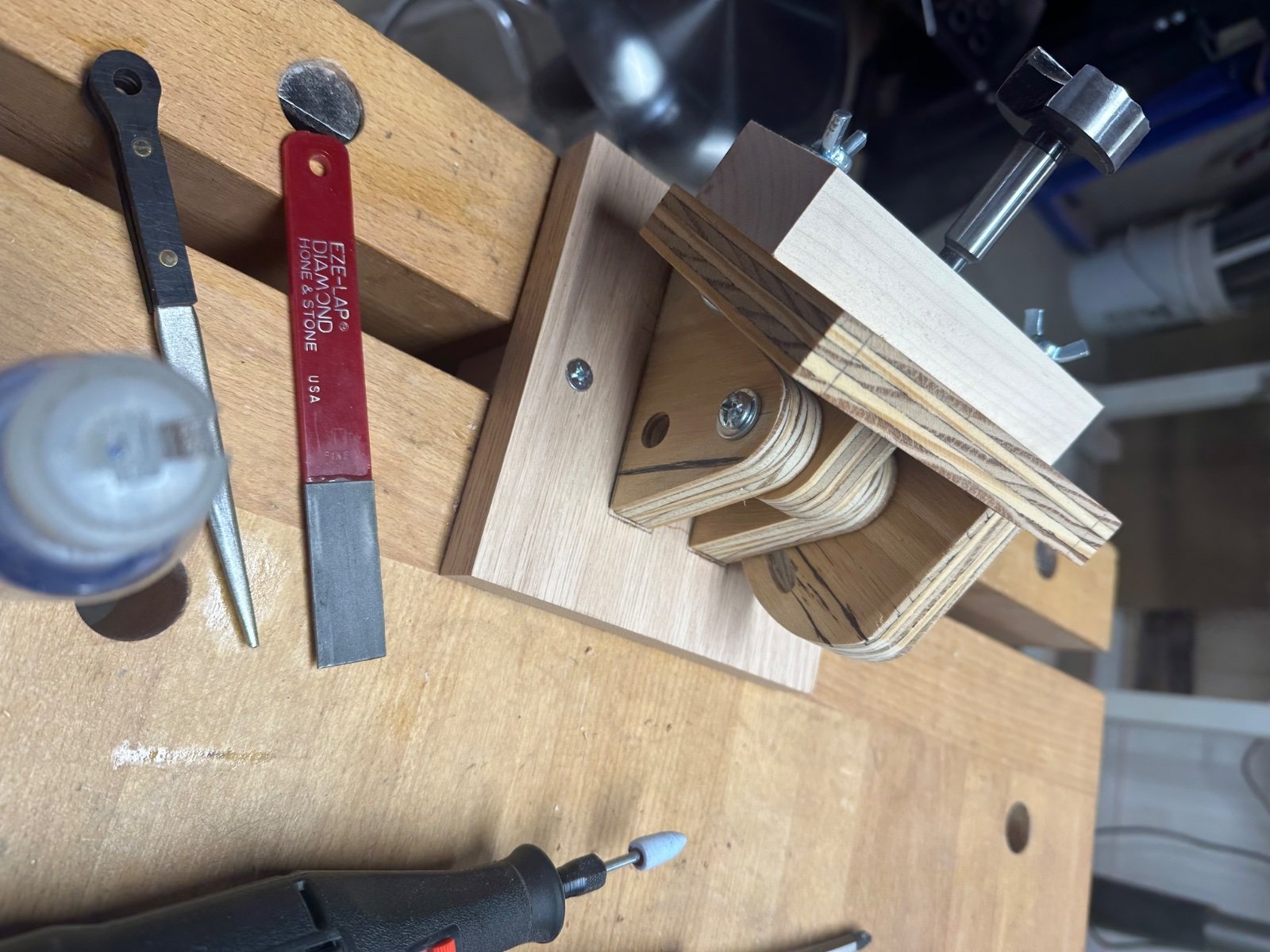

The hardest part about sharpening a Forster bit is holding it steady while sharpening. Fisch sells a sharpening jig for a whopping $280.00 dollars and to be honest I was contemplating it. However it doesn't get great reviews and just to darn expensive. Also it looked like you could get very aggressive and ruin expensive bits. The solution, build my own. It's adjustable, so I can change the angle that best suits me. It has three holes that hold the 3 shank sizes my bits are. I watched a few videos on how to sharpen Forster bits. I had a bit so dull it was virtually unusable. Took about five minutes and it's sharper than when it was new. It cut into solid oak like butter. I already had the sharpening tools I needed, a diamond file and diamond home, also a diamond dremel tool. It works great.

I admire you and your work. I went through 2 sets of HF type forstner bits before I finally broke down and bought a set of Freud about 6 or 7 years ago at about $200 or so back then (Upwards of $270 now) and I haven't looked back. There is such a profound difference between an inexpensive set and a very good quality set like Freud.
Still I would like to sharpen the HF set to see what they would do. I like your setup, and I will check out some videos on the subject. Thanks for the ideas!
I bought the Freud set after a cheap set from Woodcraft. Light and day difference. I think the wave cutter style are easier to sharpen than the sawtooth style like my Woodcraft set is. Those have never been sharp, even when new. I'm going to see what I can do with those too.
