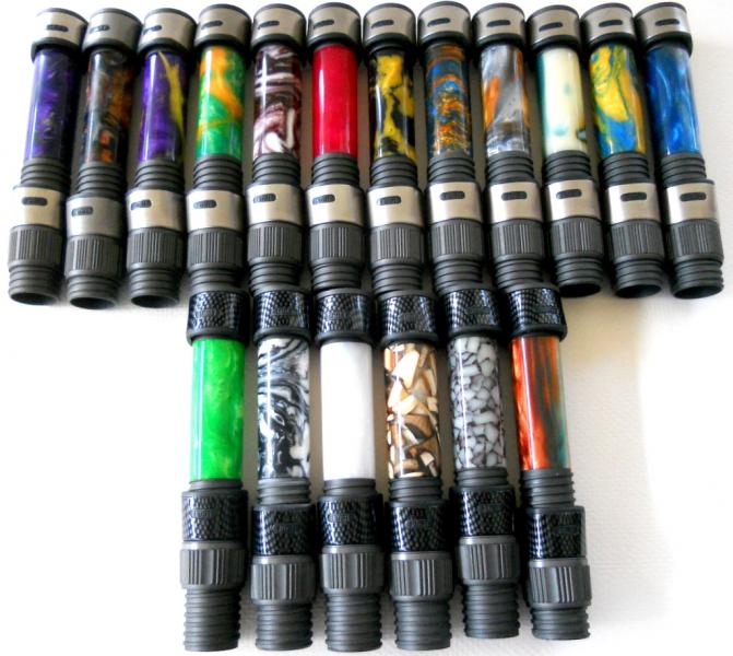

Kept busy for the last couple of days making some reel seats for a show in Feb. Trying to get ahead early and hope to have about a hundred of them made by then.
All of the acrylics came from various vendors from the forum including El Mostro, Exotics, Ankrom and a couple of others I can't remember at the moment.
Click on thumbnail for a larger view and thanks for looking, and for any comments.

Any thoughts on a tutorial? I would not mind making a set for my own use, they look pretty awesome, great job!!

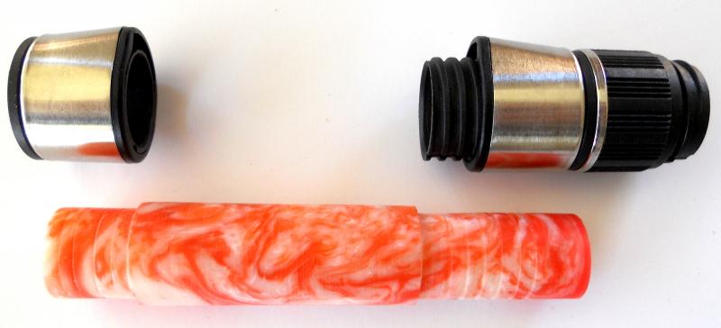

Don't use bushings, just the hardware. Use a 4'' piece and drill a 1/2'' hole, then cut a tenon on each side for the seat hoods will slip over them. I had some 1/2' mandrels made 8' long just for the seats.

Here is the photo of the turnrd insert with the seat hood and threaded barrel. Just turn a short tenon on one end and a longer one on the threaded end and turn to fit. Total length is 4''. No bushings needed as I use the hardware to get the correct fit.
