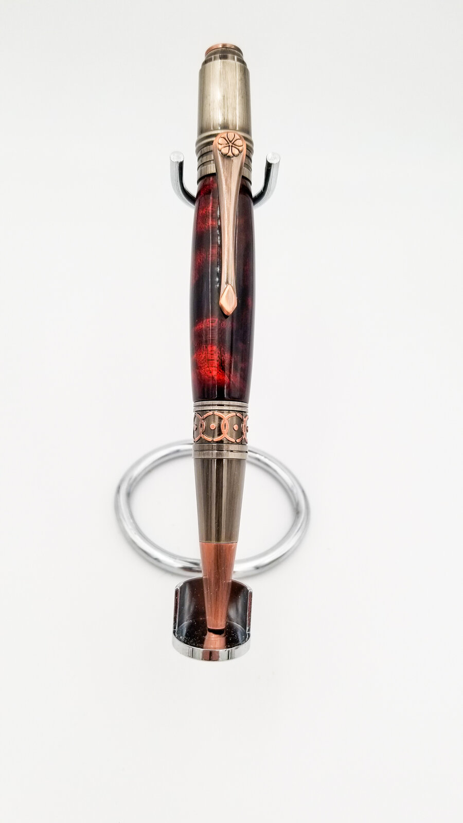

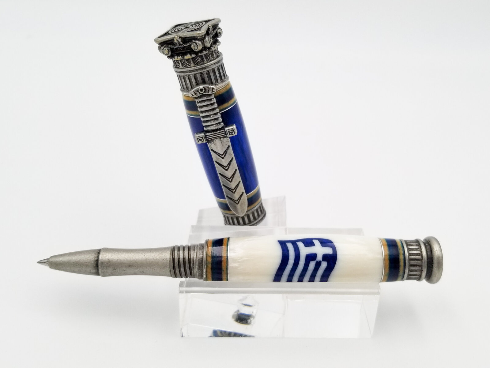

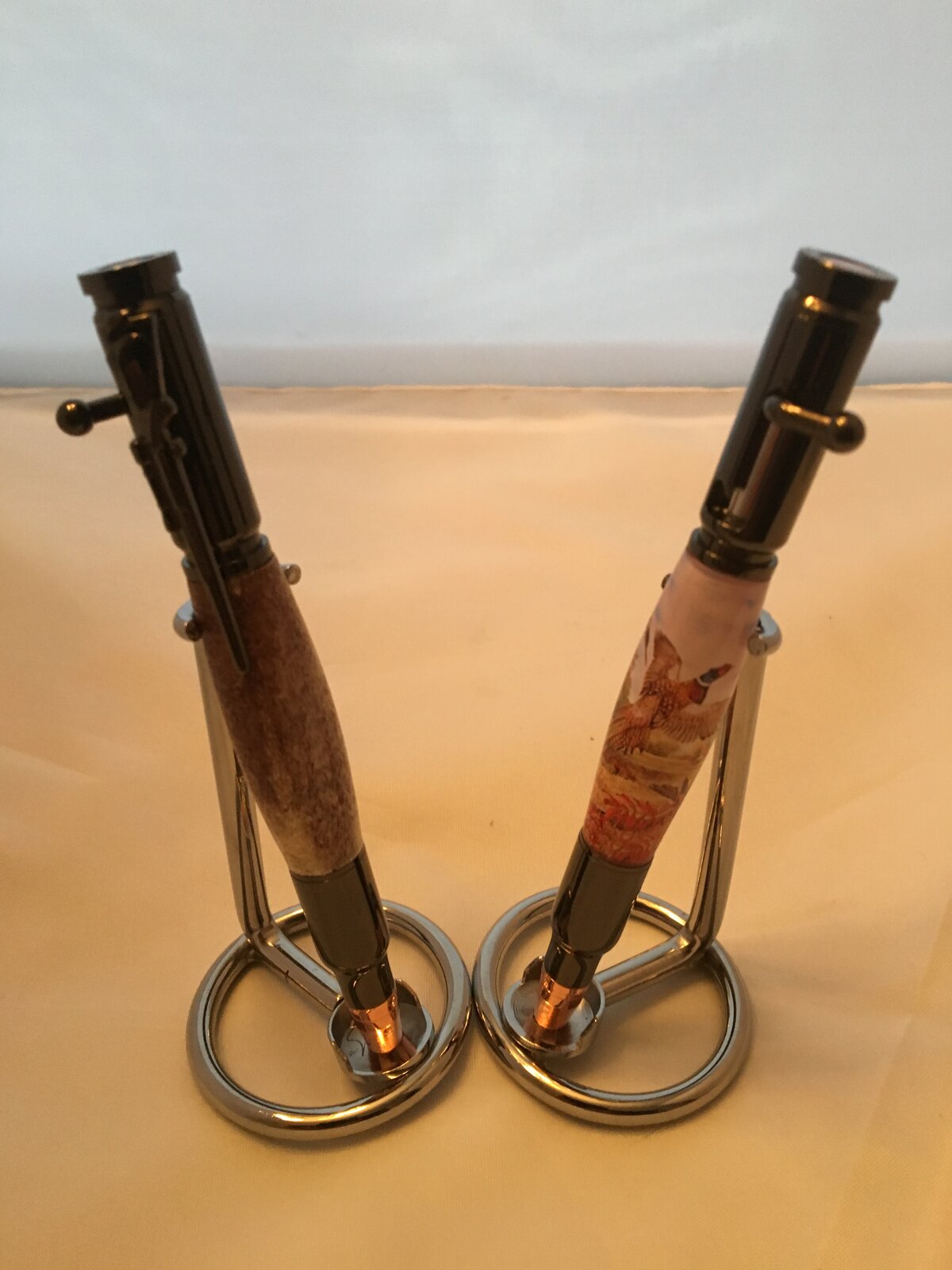

I switched from MM to Zona paper (wet) and it jumped up the shine factor but the biggest jump for me was when I started finishing (use after Zona) with the Beall buffing system but I only do the Tripoli and White Diamond as the Carnuba knocked the shine back down for me.

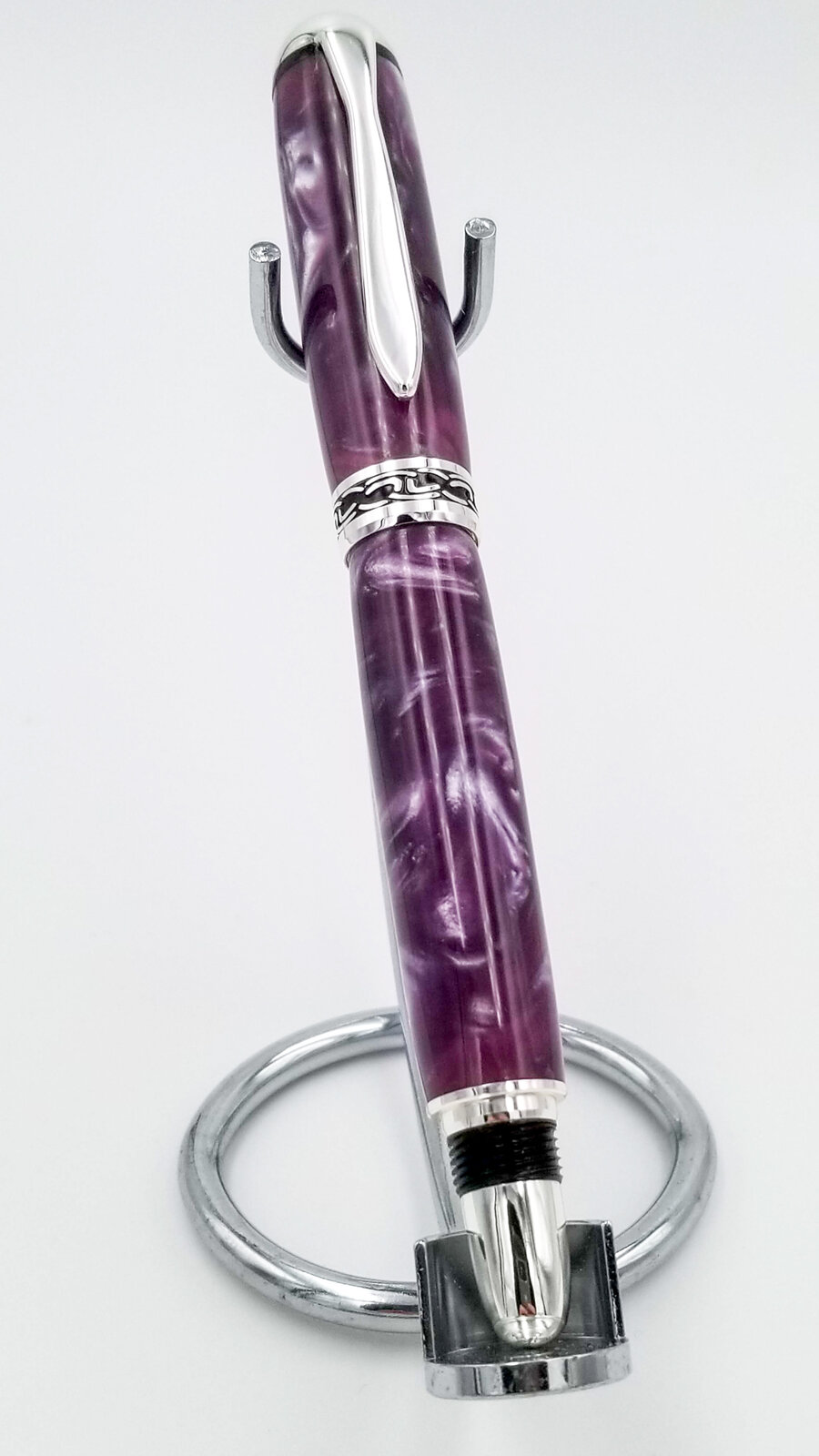

I started using a product called magic juice and it is a step polishing compound.there are six polishes and its just apply and wipe till dry. My acrylics look greatin my opinion. i also add renaissance wax as a final bit of protection. Magic Juice is available at Stadium Pen Blanks
