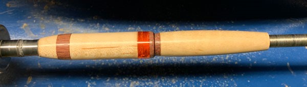

I explained I love my mandrel now. But early on I had two recurring difficulties: knowing how much to tighten the nut and the mandrels bowing over time.
These problems seemed to cascade into other areas and kept me from enjoying pen turning.
The Solution
He said, "Throw the tightening nut away. Use a Mandrel Saver instead."
https://www.pennstateind.com/store/PKMS2SET.html
He explained it's faster and better. "This is the way."
I offered the Mandrelorian a Dr. Pepper but he refused.
He said his people like using a mandrel because they can assemble pens on the lathe and begin visualizing the design's proportions more easily.

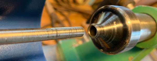

I am still frustrated with bent rods on pen mandrels. You buy them new in the woodworking store, put them in your taper for the first time, and you can see the tip circle around.
Yes, I use a mandrel saver.
As soon as I am vaccinated, I plan to go to the local McMaster-Carr, buy some straight "D" size drill rod, cut off a piece with a hacksaw, and see if it fits as a replacement for the rod in an adjustable mandrel.
https://www.mcmaster.com/8893k202
See:
https://www.penturners.org/threads/warped-mandrels-grrr.162455/#post-2055965

My frustration isn't with the mandrel saver, at least not yet. My frustration is that the mandrel rods are not always straight, sometimes even when you just bought it and haven't used it yet.
