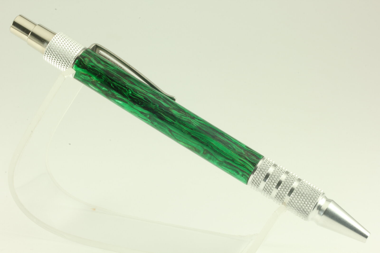

Food coloring applied to hemp. I had a hard time holding on to this one. Need more hemp.... IMG_3046.JPG
Thanks to all for sharing your experience with food coloring. What did you use for the final covering coat. CA?
