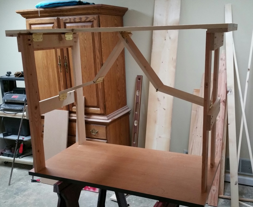

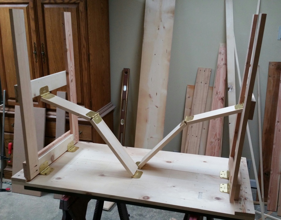

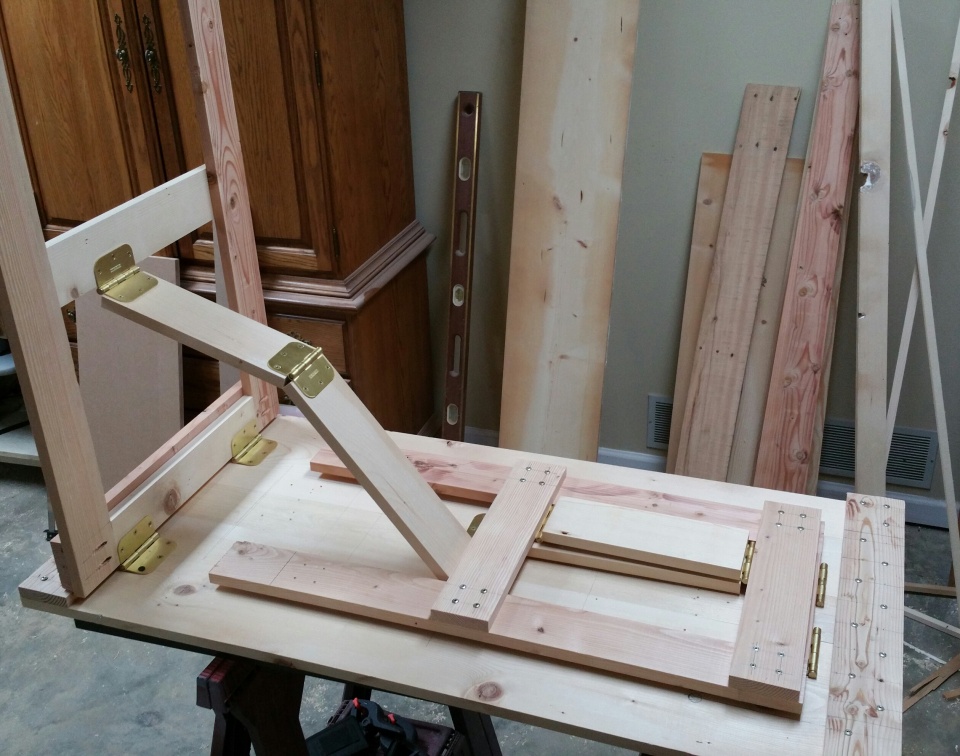

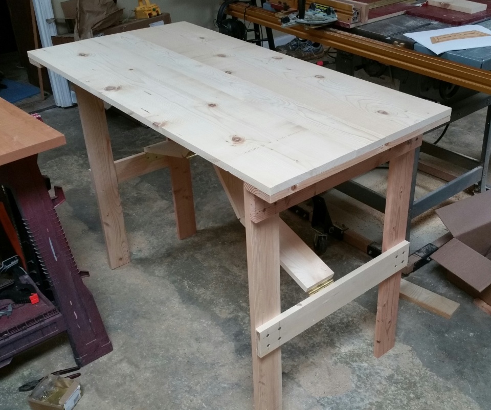

I needed a couple of tables for doing shows, but couldn't find anything I liked. After searching around the web, I found some examples that would work, but they only sell them in England. So, I figured it out and built my own. Two of them actually. The one not pictured is 6'x2'. this one is 4'x2'. They are both 36" high. They're made from scrap wood and pallet lumber. I paid for hinges and screws. The hardest part was figuring out how to line up the legs so they would both fold flat when not in use. They are sturdy enough too. My brother in law climbed on one and stood up and it barley moved.

I like the tables... do the legs lock open... I notice the hinged braces aren't completely straight when open... also how does the weight compare to the plastic folding tables from Lowe's or HD? I have several of the 6 footers from Lowe's and while they aren't too heavy, they do get a little cumbersome to move around sometimes... especially as I get older.

It appears that the hinged braces go past center(flat) and pop into a locked position when the leg is fully against it stopping point. Pushing up on them will allow the leg to unlock and fold closed.
Just watch your fingers when you place them in the locked position!:eek:
Charlie is correct. The hinges in the leg braces go past fully opened which locks the legs in place. So far I haven't caught my fingers.
The weight on these is a little more than the plastic tables, but not by much as far as I can tell. I have one of the 6' models and didn't want to use it because it doesn't seem sturdy to me. These tables are much sturdier feeling. I need to incorporate a handle for carrying, but at only 2 feet wide, they're pretty easy to tuck under an arm.

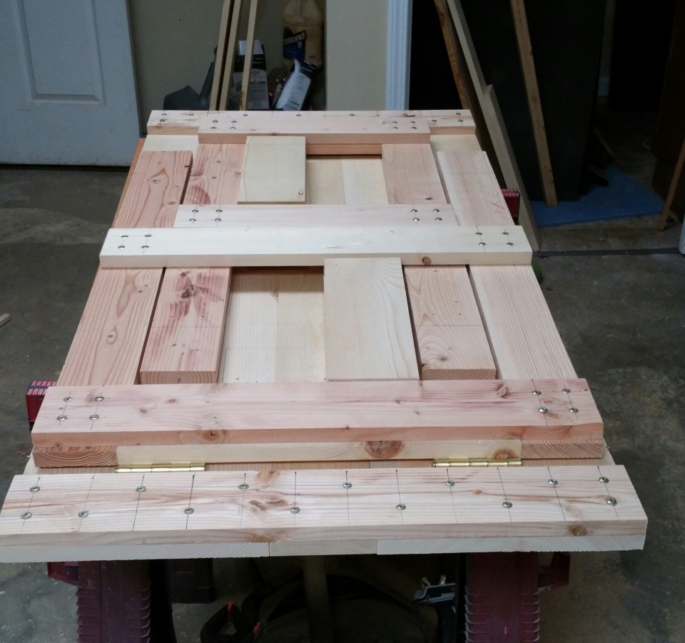

Did you glue and screw that cleat under all those boards making up the top? Wood expands and contracts. The top will expand and contract, that cleat will fight that. If you glued it up solid, expect some cracking or cupping of the top.
No glue on the cleat. The only glue used was when gluing up the top panel. Hopefully we won't experience any of those problems, but time will tell.
