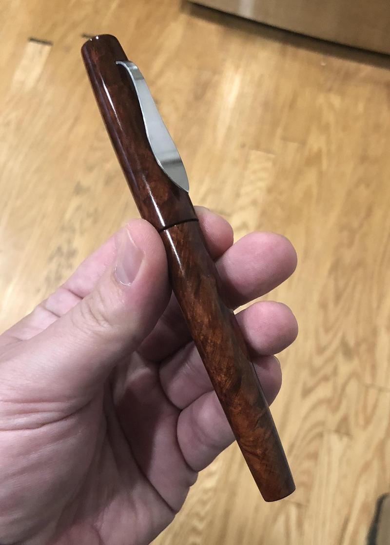

I've actually experimented with creating my own clips to the specs I'm looking for. The only problem is the labor that goes into it is daunting. Here is a first go at me adding a clip in the manner I've been describing to one of my own pens...
That pic was taken for demonstration purposes and the clip hadn't been secured or anything. It was made with 304 stainless steel sheet and I have no idea about how it would hold up or function in terms of it's bendability/springiness before literally getting bent out of shape. I imagine using anything softer than steel would be a problem unless it was really thick. I am experimenting with nickel silver and am hopeful it is easier to work with some decent strength behind it.
So the hope was that I could procure clips made for the purpose of being pen clips with pen clip properties, already designed to suit my aesthetic needs. I see they got halfway there by offering the fold-over option, but went a little goofy with the creativity aspect by making it wavy (in my opinion at least).
