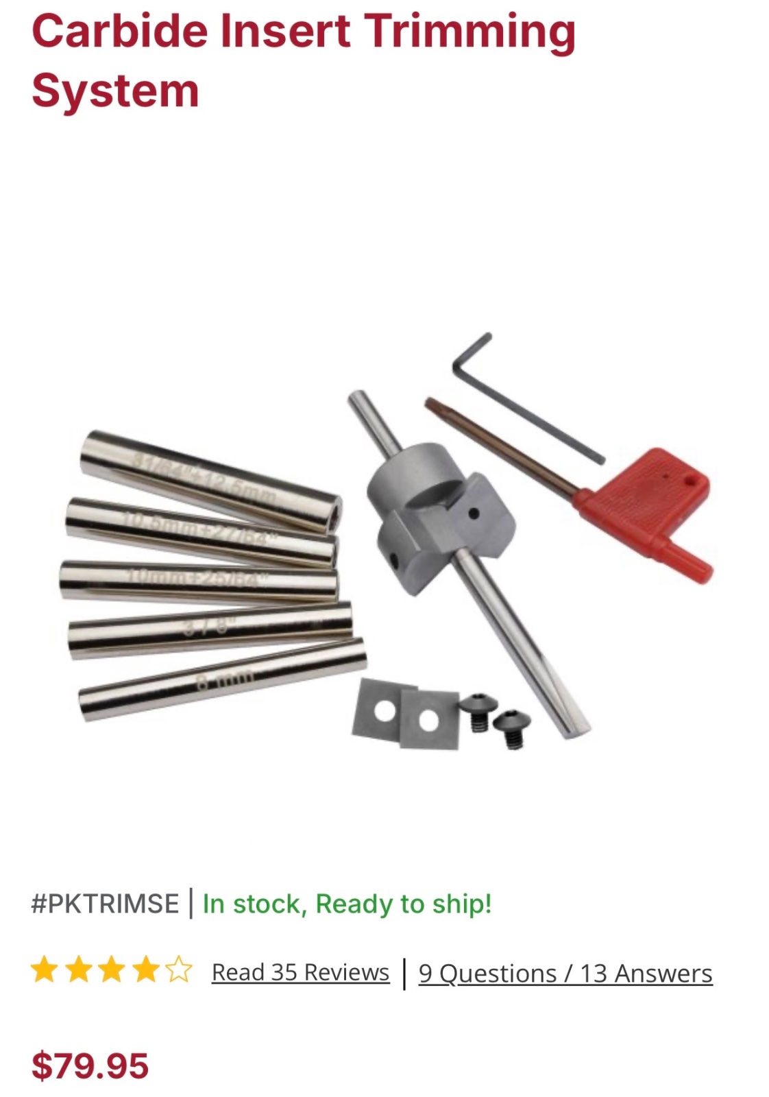

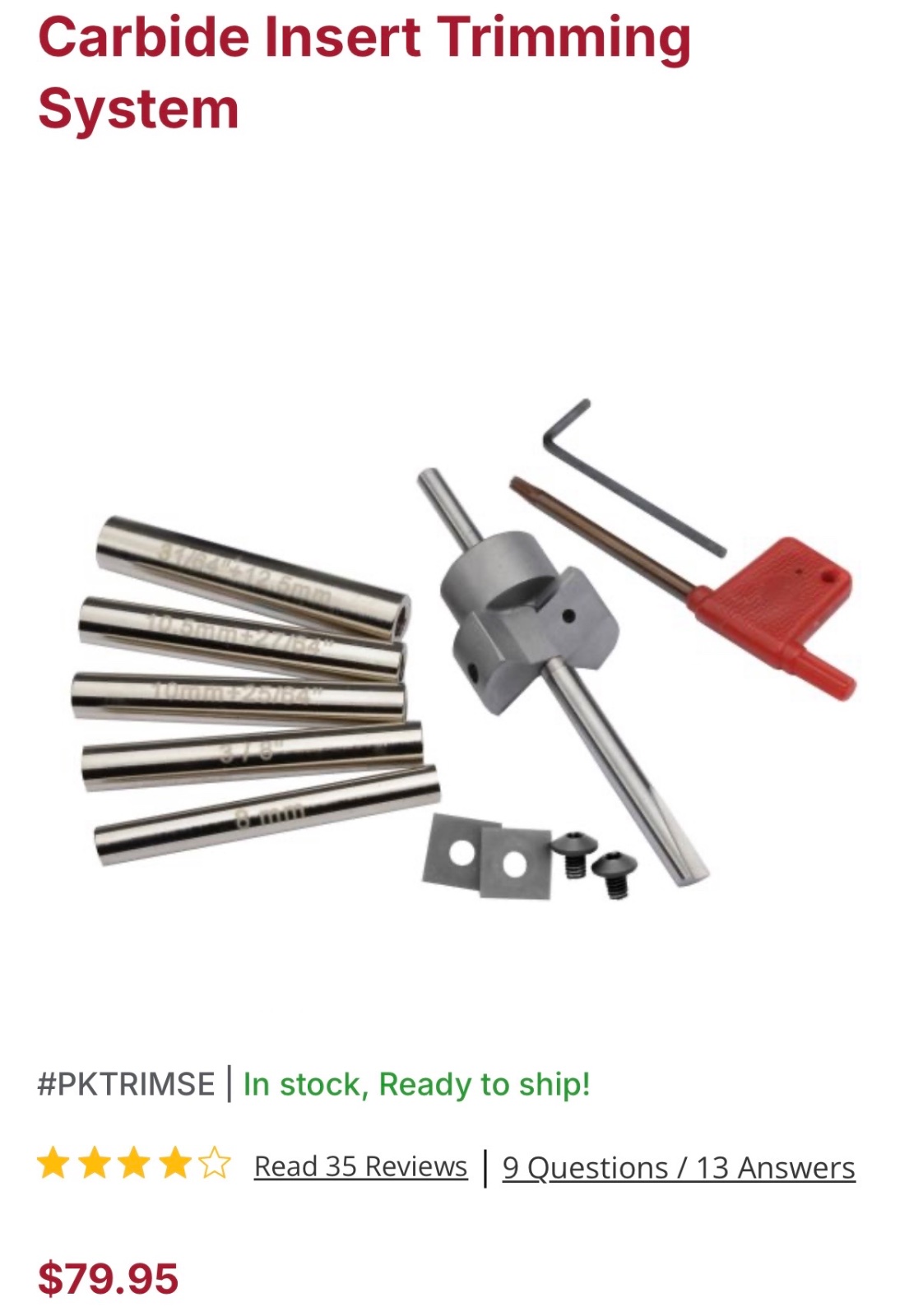

Mark, went through two barrel trimmers. Tried to sharpen them but it was a lost cause. Went to Woodcraft, skipped a drink and bought the higher priced trimmer with carbide blades. Goes through wood and synthetic blanks like a hot knife through warm butter.

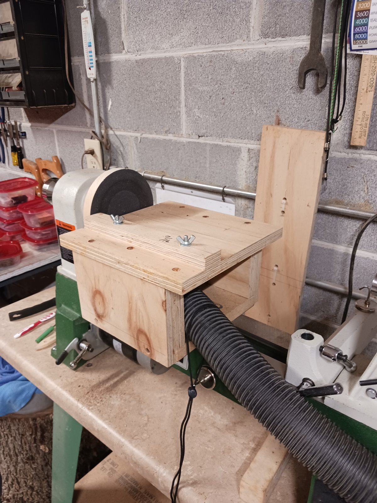

I built a sanding system for the lathe but entails taking the quill off and putting the unit on the lathe, faceplate with disk and sandpaper. I have seven blanks to trim and ready for turning today. Pen mill will be on the drill press with either a 7 mm or 3/8 reamer.
Photo of my DIY sanding system.
