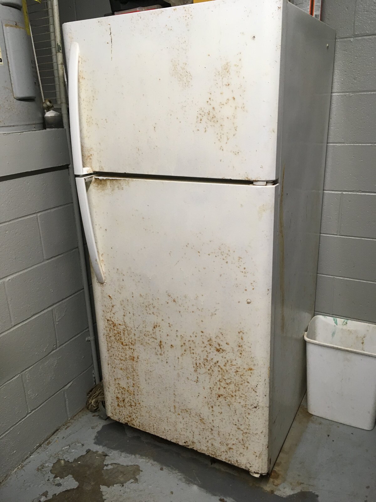

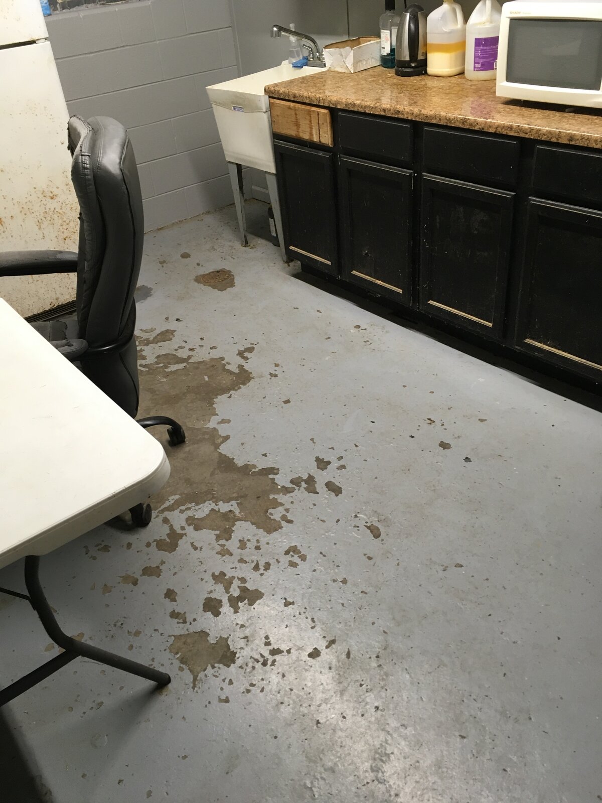

My buddy o pal is asking me to epoxy the floor and 'paint' the refrigerator in one of his stable's warm rooms. I've done neither before, but I can't imagine it would be too hard. Any procedural or product advice for a floor epoxy or appliance enamel (what I'm guessing the fridge will require)? For the fridge, I'm guessing a good sanding, surface cleaning and then spray enamel. As the floor was apparently painted before, I imagine it would need to be removed before the epoxy process is started.
I agree with JT. Had my garage floor done about three years ago it was a major job for the three man crew. Floor was ground with a large circular grinder ( dust everywhere) , patch mixture applied to spots as needed, color rolled on and color flakes applied. Workers wore long spike shoes to avoid walking on wet coating. Not a do it yourself project in my opinion.
About 22 years ago, I took the DIY approach on my workshop floor. It was previously painted gray and had areas of missing paint very similar to what is in your picture. It's now two decades later and there is one small area, about 6" inches square where one large chip has developed. It is in a high traffic area and it is all the way down to the concrete surface. I'm assuming it was one of th e areas that was covered with paint and the paint finally lost adhesion to the concrete and the epoxy strength finally gave out so a blister formed and the chip finally came off. Other than that, it has remained rock solid. Overall I have been very happy with how it has performed. Of course, there are lots of variables that can affect the long term performance - who knows, maybe I was just lucky.
I started out by scraping the edges where the old paint had chipped, then I mopped and rinsed the floor thoroughly a couple of times. I followed that with a product like Rust-Oleum's Concrete & Garage Recoat Primer which is made to seal and prime previously coated concrete. Then I used the Rust-Oleum Epoxy Shield Garage Floor Coating Kit which included the base coat (gray), paint chips (white, black, blue) which not only provide aesthetics, but also provide better traction, and a clear topcoat. There was also an etchant in the kit, but I didn't use it since I used the Recoat Primer instead.
I don't know what professionals would have charged, but for my shop it cost me something like $60 for the primer and about $180 for two Epoxy Shield kits (I needed two for the area and because I only did one half at a time by moving equipment first to one side and then to the other). Along with disposable brushes, rollers, roller pans, and other miscellaneous stuff, I probably spent about $280 - $300 for the whole project.
I only wish they sold a smaller kit so I could patch the one bad spot that has developed. I have been hesitant to spend a hundred dollars just to patch a small 6" inch area. If we ever decide to move and put the house up for sale I will break down and get one so I can fix that one small spot up.
I don't know about the refrigerator, but I do know that Rust-Oleum makes an Appliance Epoxy paint that is formulated to refinish appliances. It sounds like a lot of work with all of the prep that would be needed, but think the paint is only about $30 for a quart.

My advice
Don't touch the floor, unless you have done it before and are confident.
The fridge, should be an easy job, just sand it down and use basic automotive spray paints, even domestic spray paints will be fine, doesn't need anything special on the outside. If spraying white get a white primer, any other colour a grey primer will do.
I agree with the others… epoxy floors are not just put it on and you're done. There are preparations steps like degreasing and acid etching. If done wrong, you will be peeling it up and redoing it. You can add no slip packets to paint to help traction. It's much easier than epoxy and les expensive. I painted my shop floor and applied rubber mats on the high traffic areas. When I spill acetone and damage the paint, I just touch it up.
Thanks for posting this. I've been thinking about doing my garage floor—the previous owner thought she was Pollock. You're post convinces me I can do this without hiring it out.
If you do - be patient, follow the directions on your materials, and make sure things are good and clean and dry between each step. My advantage was that my shop is in a climate controlled basement, so the humidity level is good year round. And of course, the best of luck. - Dave
Despite my continued delusional optimism for every project I jump into and Dave's thorough advice, it feels like I'd be better off avoiding any kind of epoxy process and just go with repainting the floor using the no-slip packets John suggests. Going this route, my steps would be 1 - pressure wash with degreaser and 2- roll on paint with anti-slip added. Any additional steps other than these worth taking?
Fridge steps will be sand, prime and shoot automotive paint as Paul suggests.
