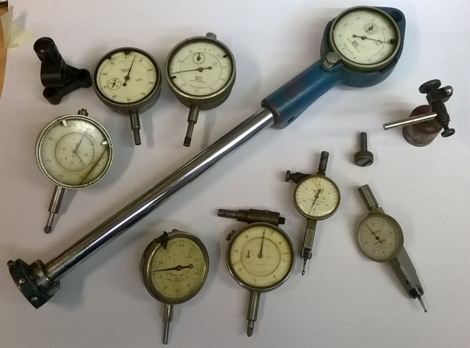

I got a job lot collection of test and dial indicators off flea-bay the other day.
Some are non-working junk ( which I knew beforehand ) and a couple of nice ones that appear to work just fine. There's one perfect Japanese Mitutoyo TDI and several others British makes like John Bull, Mercer, Oldak and a Verdict TDI, as well as a couple bases and spare dovetail clamps.

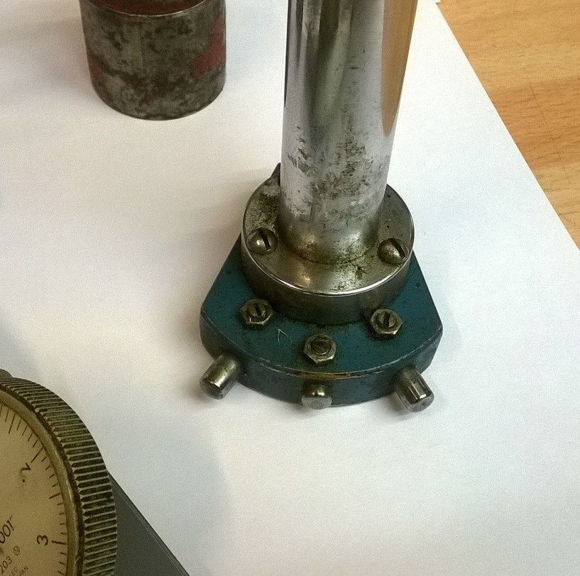

There is a strange one that I don't even know if it works or not. I have no idea what it would be used for.
It's the tall one of course. It has three buttons on the base of the 12'' stand. I think the middle button is stuck in. But I'm hoping someone can shed some light, before I try and 'unstick' it.
Also, what can I use to clean them up? I may just practice cleaning the buggered ones with Isopropanol, but don't want to ruin the good ones.:eek:

Edit in; After using Google, it appears that the tall one is a 'Bore Comparitor'.......??

i think that long one is for a cylinder to check for in round or not and to get to the right size

Nice find. Be very careful on what you try to clean the lenses with. Solvent based ones will melt them. Start with dish soap and water and a damp cotton swab and work up from there. Taking the lens off on some is a real challenge so try to clean in place. If you have to you can polish them by carefully buffing, same as a pen. If you take the backs off to lubricate them the oil you use has to be something that does't dry or get gummy. Got any sperm whale oil around? Apply it sparingly. Long Island Indicator has a bit of information tucked in it and if you need to you can get parts etc. from them.
The dial bore gauge you have, if it worked like the Mitutoyo versions I worked with have the two side pegs spring loaded to centre the gauge in the hole and the centre one takes the reading. The dial indicator can be removed and used like the others in the picture if you have no need for measuring holes. You need a ring gauge to properly set one up to use but you can get away with a micrometer or gauge blocks and jaw set.
I think I have a few different tips for the Mitutoyo indicator squirrelled away somewhere. If I can find them I can send you any that I have a duplicate or triplicate of. They will be longer, shorter or gave a different ball tip diameter. Indicators are only read correctly with one tip size and extending straight out from the indicator, otherwise cosine errors and tip length throw off the reading. They are great for centring shafts and holes etc., or measuring with a hight stand.

No sweat. One thing you can do with one of your dial gauges if it has a travel of half an inch or more is to make a dial depth gauge. Simple to make, even for you, ;) and very handy. If any of the indicators read out rather than inward, even better.

As far as the mechanism, I'd suggest acetone with a bit of ATF mixed in with it.
The the mixture cleans well and the acetone evaporates leaving a very thin film of ATF behind which lubricates precision fit parts very well.
For the lens and dial face, I'd think nothing more than soapy water or isopropyl alcohol solution should be used to avoid the potential of solvent damage.
for the stuck or sticking ones I would recommend finding an old fashion watch repair man. The jeweled movements inside are very similar to a watch, he can disassemble, clean, lube and reassemble them for years more life.
