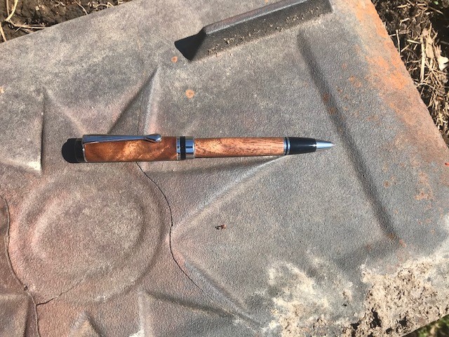

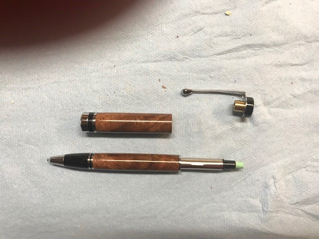

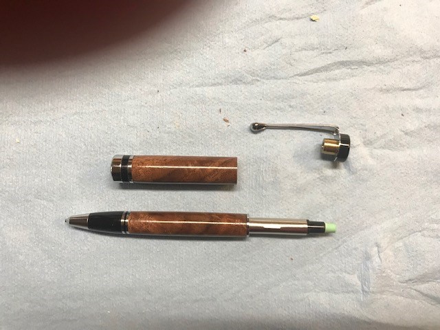

This is a very old kit from Beartooth Woods. The brass piece on the top is too small for the tube and I'm not sure how make the pencil work. Have I put it together wrong or what am I missing?

Beartooth woods sells mostly Berea kits so you can find insturctions on the Berea website. There are 3 tubes. One for the lower barrel and two for the cap. I agree with Rob...you may be missing one of the tubes.

I currently have no way to tell if a 7 mm tube, will fit inside an 8 mm tube. But that doesn't matter, it can be made to. It's repairable, depending upon how confident you are in your turning abilities. Turn or sand the inside of the 8 mm tube, to the size needed to fit the 7 mm tube inside of it. (I'm not sure if a 7 mm tube will fit inside of an 8 mm tube, and I presently have no way to check.) Then install the 7mm tube in place, and glue it there with CA glue. This is a bit tricky to do, that's why I was commenting about your confidence in your abilities. Good luck,and stay safe.

The larger two tubes are .31 and the smaller is .29. I just measured a set from my last kit. A 7mm tube is .26. The only tube set that seems to be available is the two tube set that are .31--Berea hardwoods #BHW505. But you know that already. Instructions are available. The smaller tube (.29) drives the mechanism and slips inside the larger cap tube(.31). Unfortunately, a 7mm tube will not work but you may be able to sand and reduce the ID of a 7mm tube to slide over the mechanism . Not sure if it is large enough to work properly inside the cap tube (,31).

Dave check your private messages...inner (smaller) tube is in packet...2 outer, one inner...very tight fit
