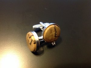

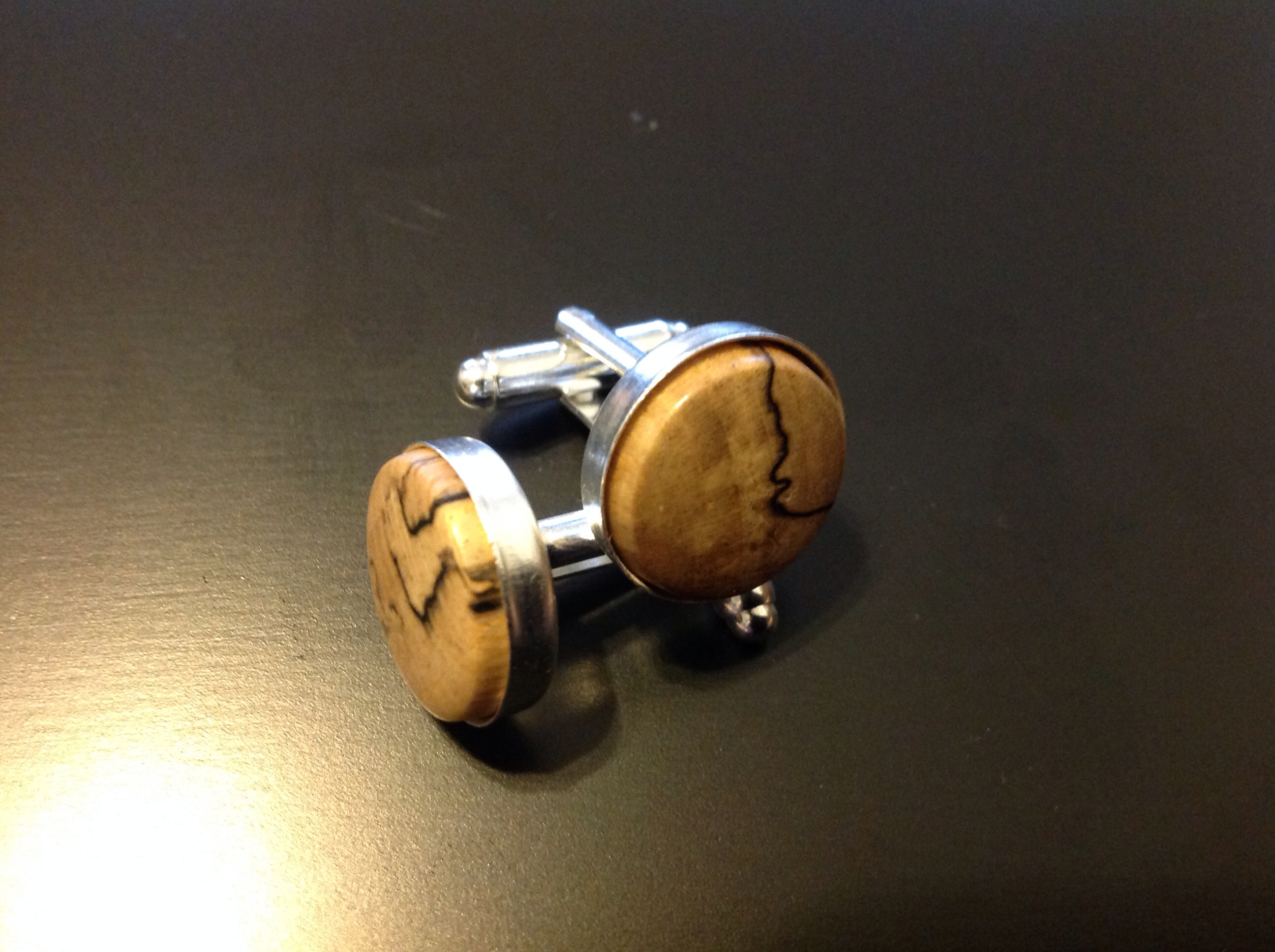

So I make cufflinks every now and then. I wear the multiple pairs I have mon thru fri. I have made some for other people but lately it seems I have gotten quite a few request.
Now my problem is I use left over cutoffs from my pens I make so the are smaller and square. I have kind of found a way to do them by taking the corners off with the sander. But the difficult part is turning them down and finishing them. I have tried double sided tape, gluing them to a homemade wood center drive that wear out fast.
So I wanted to see if anyone had and ideas. I thought of a morse taper center drive but with a flat face not pointed for tbc. I would glue the wood piece to that but not sure if it would hold. I also thought about a chuck style with small pins.
What do you think? Any help or advice would be appreciated!!!
Here is a set of the ones I wear.
