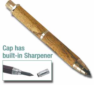

Very good info Tom. I am just getting ready to order and turn some of those kits for myself and a couple of pals. Have you seen the other version of this pen with the centerband. I believe PennState sells it. I wonder if this issue exists with the different version?
Here is the CSUSA version I believe you made:
and here is the one PennState sells:

James, CSU has that new style also and I believe that it uses tubes inside the wood unlike the original... I think I still like the original style better because it gives you more personal design possibilities... even if it is a pain the drill.. [:p]

Thanks. I think I agree with you as to the design. I too like being able to work with the barrle shap a bit. I might give em both a whirl.

CS's is a little different, the centerband and the top are hexagonal shaped so that they won't roll around. I think that they are a little classy looking but I still like the original also.
