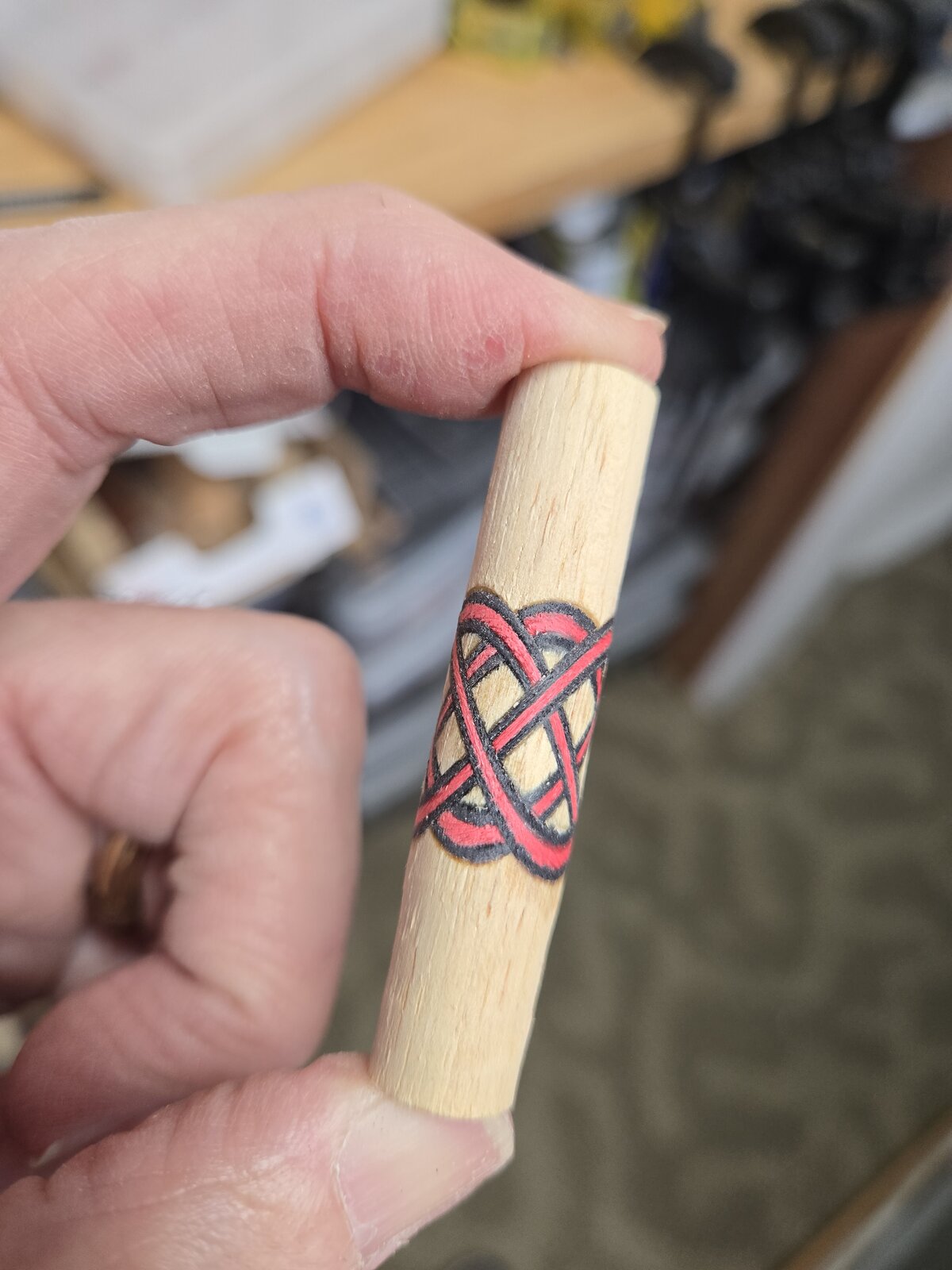

Here is my first attempt at a five sided knot. Had some glue issues and probably need to start with a larger blank. Overall I'm not too disappointed in it. The next one will probably have to wait a couple of weeks.
Since this was merely a trial I used a cheap 3/4 inch dowel which was pretty soft. It splintered some while cutting and even more while turning, even when doused with CA. When I get back to it I'll use a larger and denser wood. I managed to cut the grooves with the Byrnes tablesaw and the Celtic knot jig and a couple of pentagons cut on the laser and glued to the end of the blank to provide flat surfaces to ride on the saw bed.

That is essentially what I did. I glued a pentegon to each end to give the flat surface needed. Unfortunately the depth of cut on the Byrnes saw doesn't give much room for the end piece. I also think this knot would look better with thinner inlay. Unfortunately for me, that means I need to build a jig for the bandsaw (I know, building jigs is supposed to be part of the fun…)
It may be that cutting at a different angle would also improve the look of the finished knot.

It is far more complicated than what I did, but my method sacrifices end pieces which must be laser cut for each blank so it isn't easily transferable to others.
