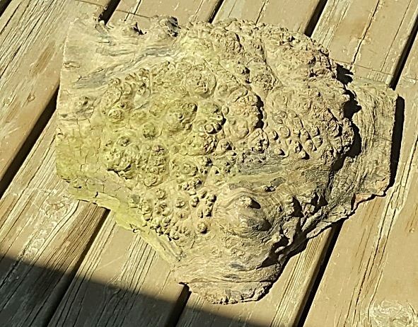

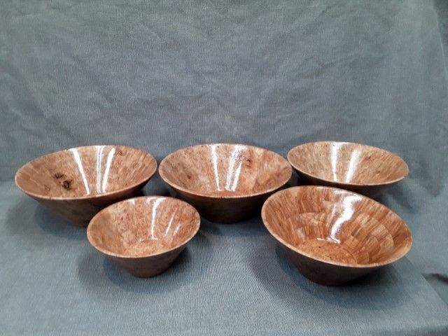

Two days ago I sliced this burl (that I brought home the day before) into pieces and made a 6" and a 8" and a 9" and two 10" bowls from it .
I know some turners would hollow it out and make one 10" bowl and wind up with a big pile of shavings on the floor. I make bowls from boards so that is a big saving when it comes to nice wood like this .
The burl was over a foot long and about 6" tall and was 25 years old . After trimming off the waste I was ready to cut it into boards, It started out looking like this .

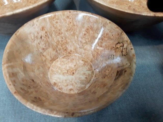

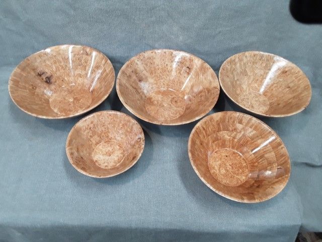

Here is the results of turning that piece of burl into bowls .

Beautiful bowls and a great way to maximize what you could get from it. Even with a coring setup you could've only gotten 2 or maybe 3 max. Well done sir!

Sorry about the bad picture of the burl that all those bowls came from. It was taken in bright sunlight on my porch whereas the pictures of the bowls we taken inside under controlled lighting .
