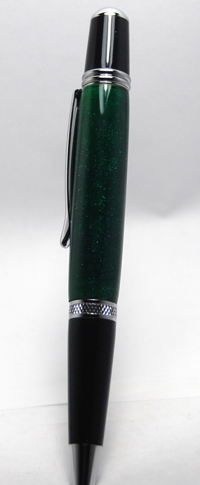

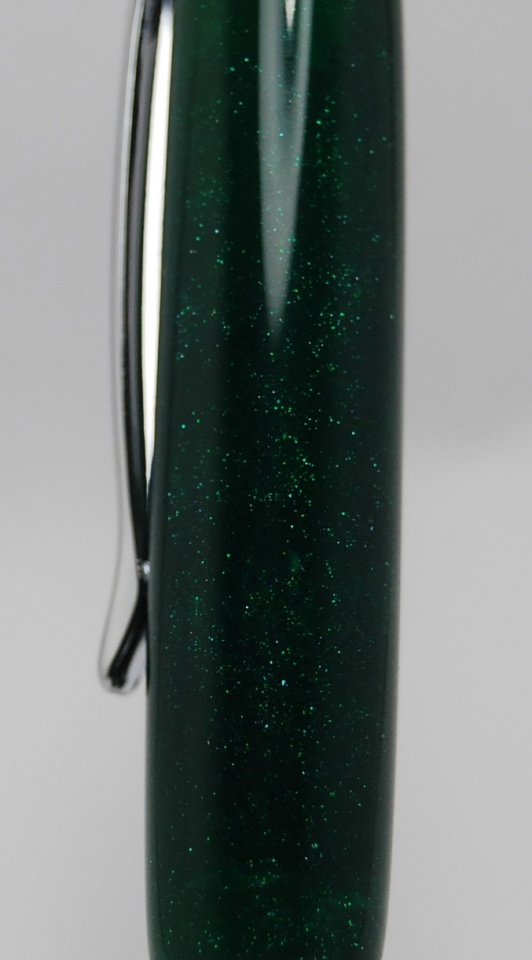

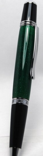

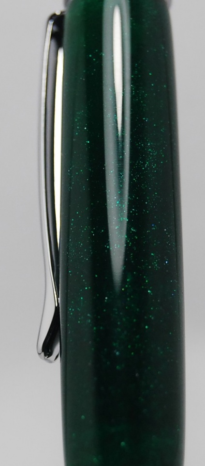

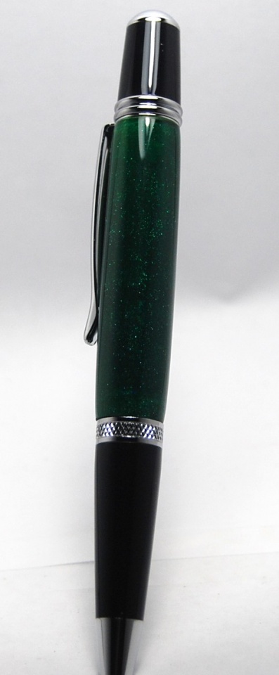

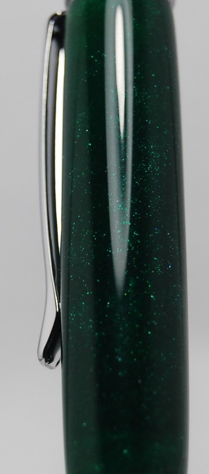

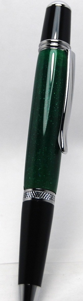

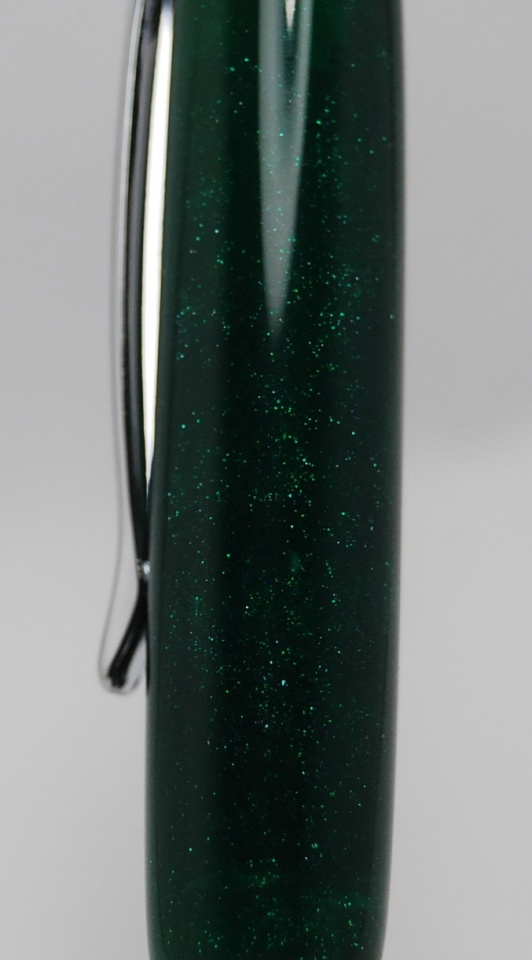

I recently cast some blanks to mimic a fishing boat. Like the ranger boats with metal flake. I had a few trial and error runs on the blank, but I think I found a winner.
Comments accepted and appreciated

Excellent pen! OK, now for the big question- how did you do it so others, like me, and copy the technique? Thanks for sharing the photos.

Well, the color is an automotive color and I added some very fine metal flake to it. The next experiment will involve a few different sized metal flakes. The main issue is the transparency. I reverse painted the blank green. I also painted the tube and tinted the epoxy green. Without doing that you could see the epoxy when the pen was final size.

I used an embossing powder from Michael's on this pen. It seemed to work really well and reflected nicely.
