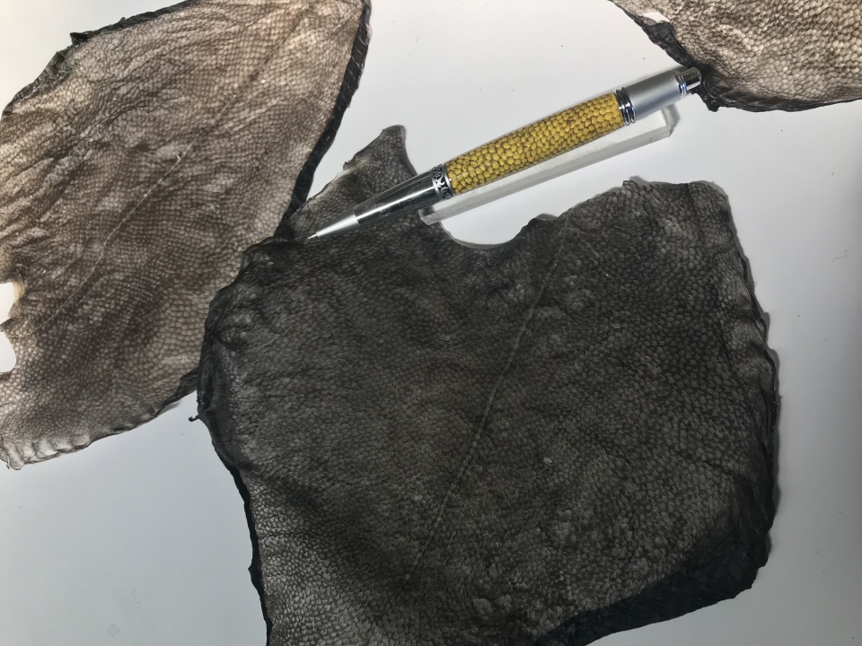

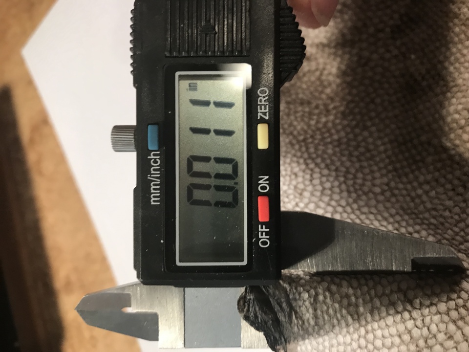

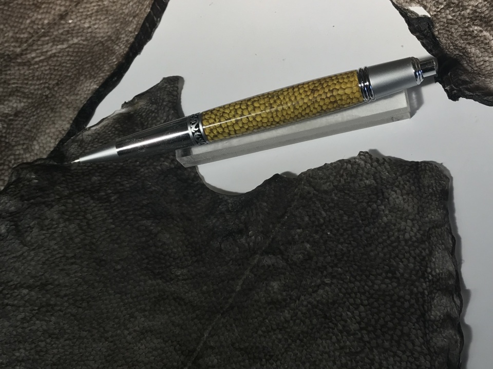

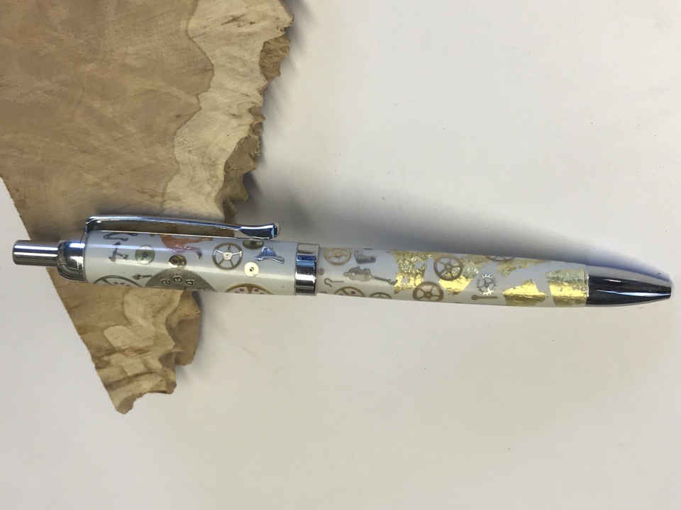

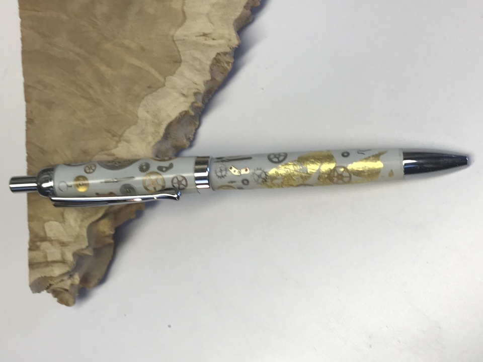

This as been a long road to get the result, since last June 2018 I try to tanner some fish skin, lots of trials and errors , but now I nail it .
This Sierra click is made with New Zealand Flounder skin cast in Royal Palm resin , finished with Zona paper

That is different. Have not seen that material used on a pen before. Came out great. How do you like that click pen kit?? Any troubles with them?? I am looking for a good click pen kit. Have a request for one. :smile:
Very nice! I grew up close to the Texas Gulf Coast and caught a lot of flounder. I noticed the cut on your skins and saw the circular piece missing at the top. Right off I thought that's where you cut the fish to remove the head and guts all at the same time. Thanks for posting the pen and brining back a bunch of "Good Ole Memories".
I like the Sierra Click pen no problem with the mechanism, but if you want a better one look at Beaufort pen kit and the Tempest pen kit is probably the best Click pen mechanism I ever seen and used, it look like a Slimline but tubes are odd diameter and I love this one better

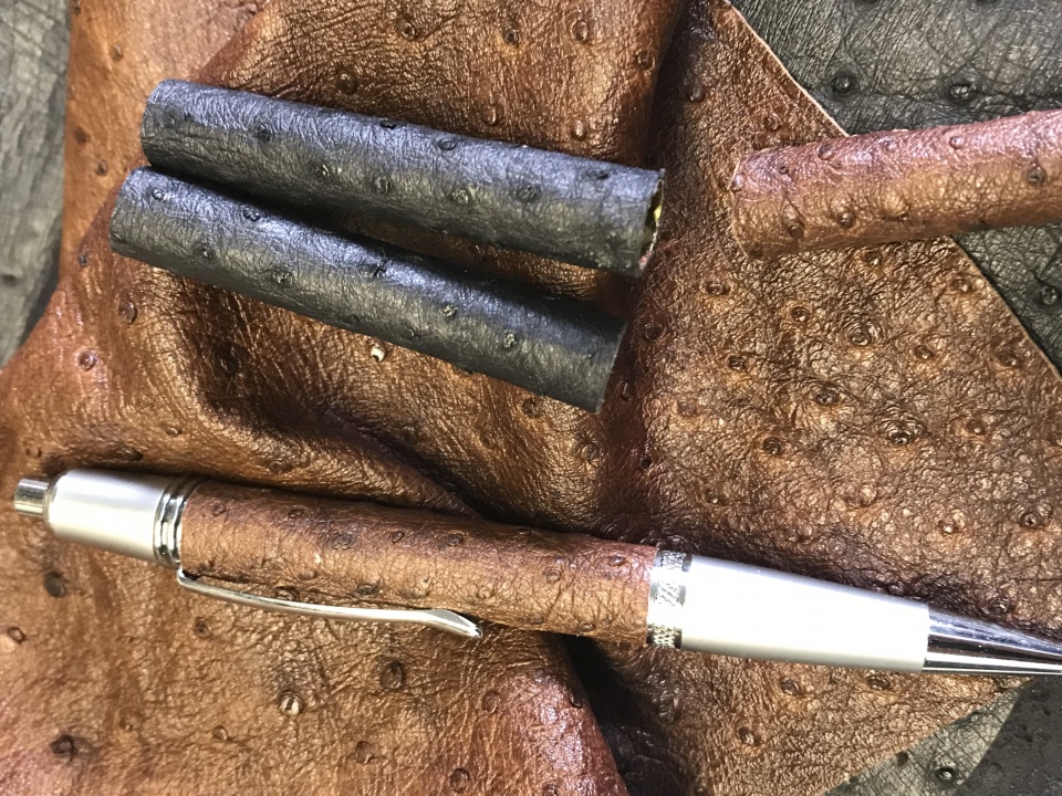

Thank you, have to look into this kit as for Ostrich pen here's a Sierra as been commissioned for got enough skin to do a few more,

that looks fantastic I have been working with snake skin and had trouble with the resin darkening the skin an making it splotch until I started sealing and soaking skin in ca glue. What method did you use to affix the fish

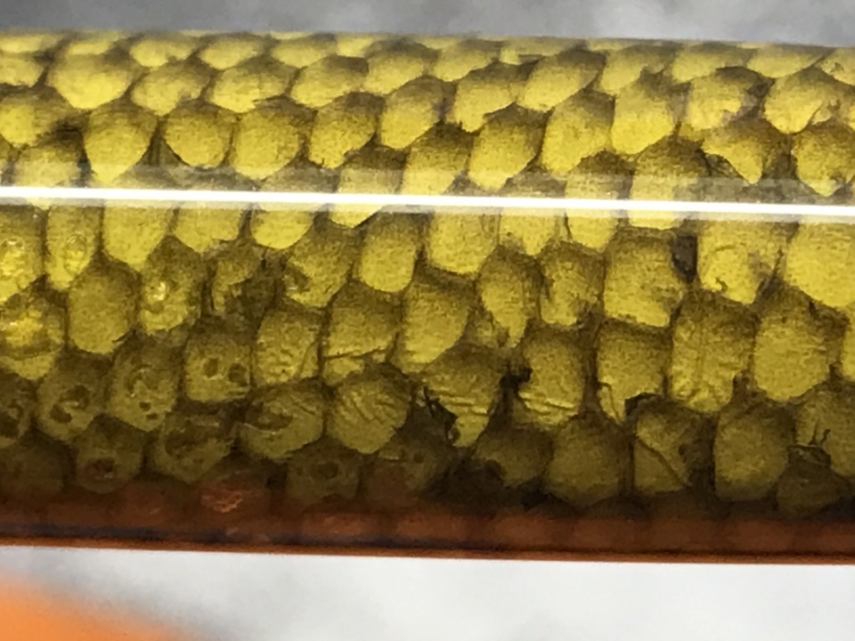

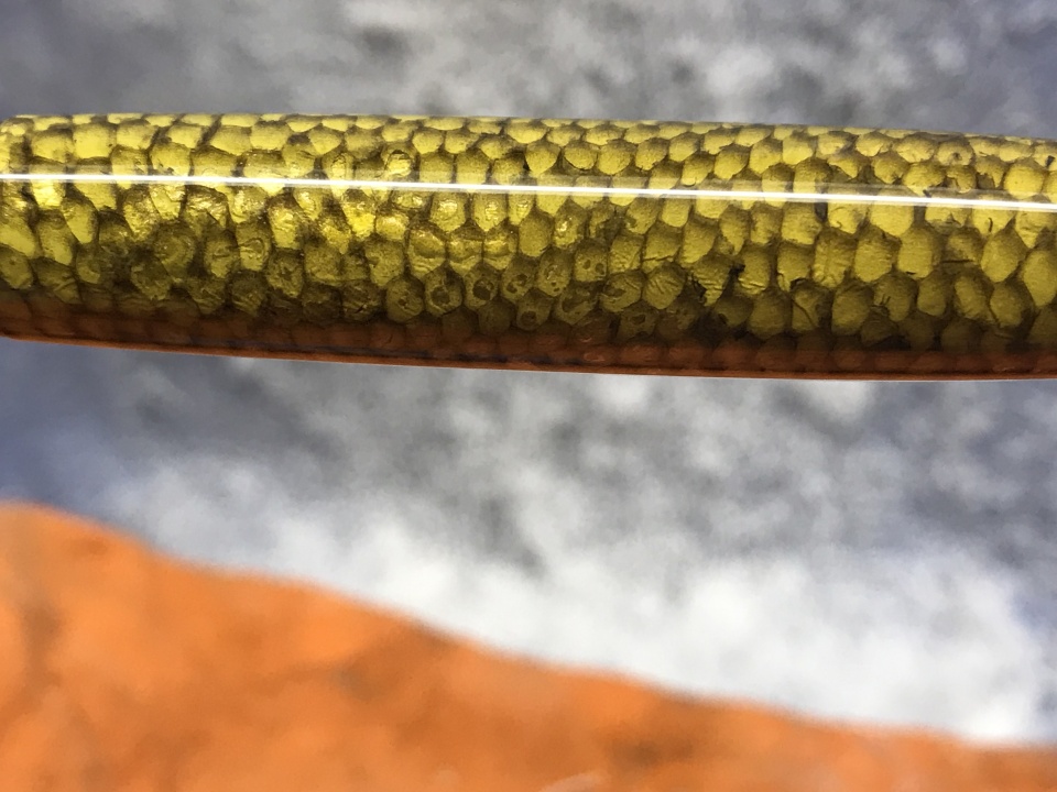

Sorry for the late reply, busy at work , I use E 6000 glue who is special for leather , I didn't seal with CA but I use for the first time Royal Palm Epoxy resin , into pressure pot at 50 PSI ,
Hope this help
